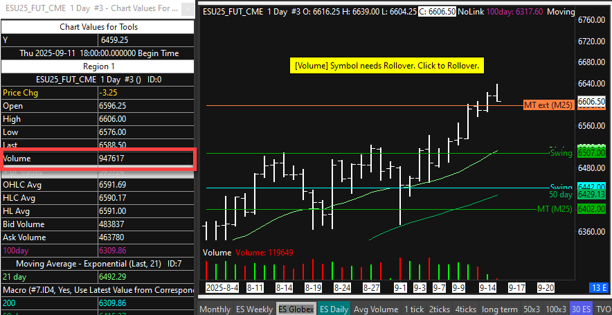

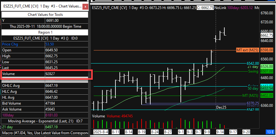

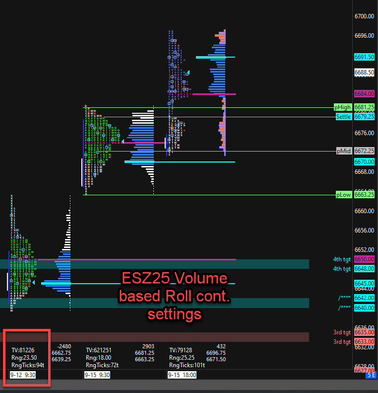

My charts are not reflecting the correct data for ES on 9/12/25. The Volume Based Roll settings are showing ESZ25 on 9/12 w/ 81k contracts traded, when ESU25 was the front month at this time, 824k traded this day in the pit session. This is incorrectly reflecting the roll, how can I fix this? Attached are graphics of the error.

This is a trend that has been occurring over the past several rolls. 6/19 showing a day w/ 110k traded as the front month in ES. The chart is rolling a day early

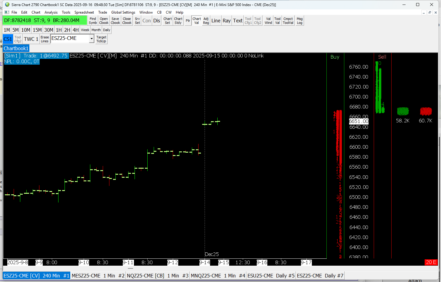

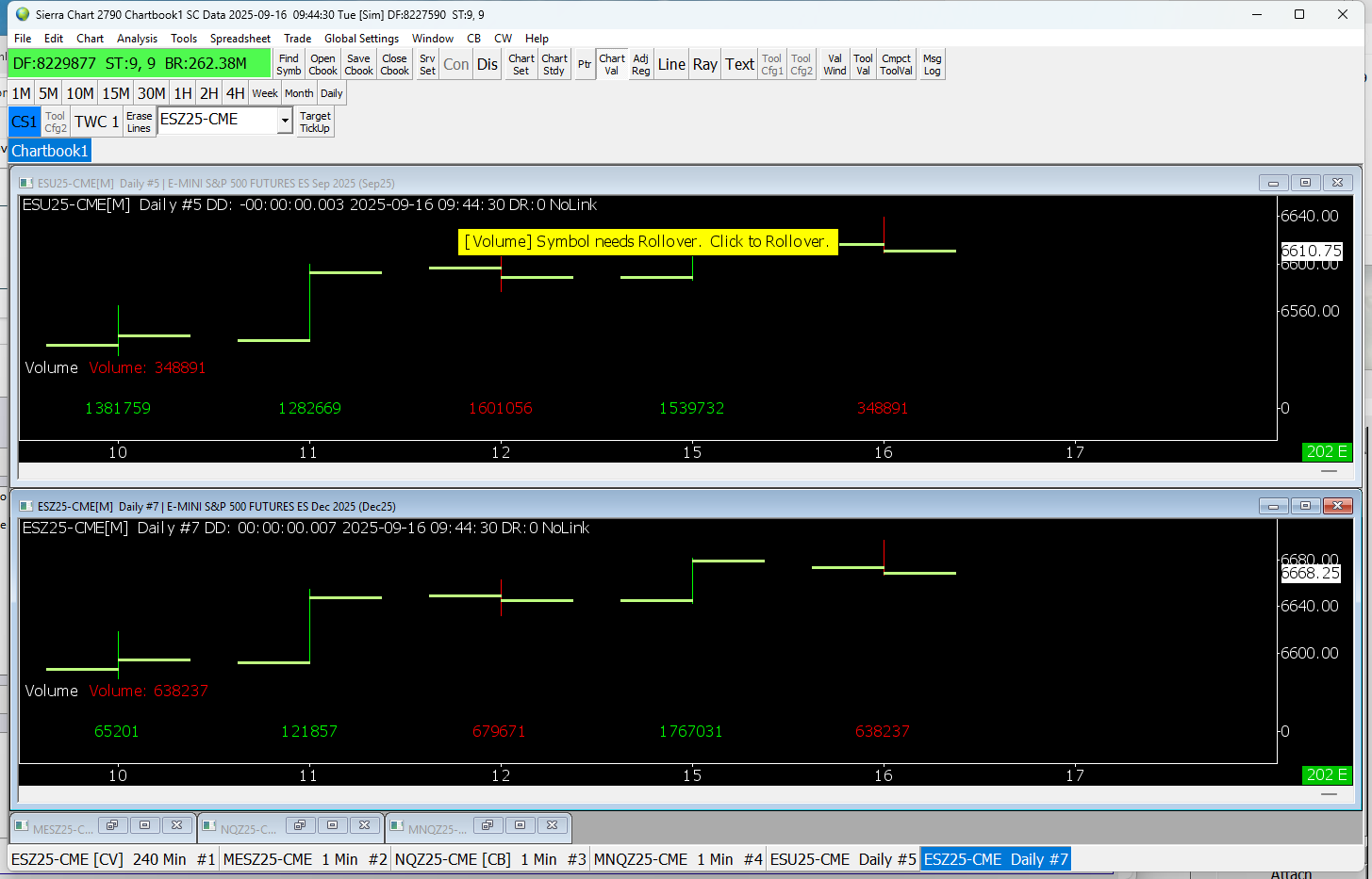

To begin with, you need to look at the Daily volume, not the intraday volume.
Second, in order to see where the rollover is occurring, use a standard candlestick chart and enable the option for "Chart >> Show Rollover Dates". This will show the date at which the rollover is occurring.
We have attached 2 images. One is daily charts of ESU25 and ESZ25 showing the volumes in the second region as text. It shows that the daily volume of ESZ25 is greater than the daily volume of ESU25 on September 15, 2025. The other image shows a bar chart for ESZ25 set to Continuous Volume Based Rollover with the rollover date showing in the chart. It shows the rollover on the evening of September 14, 2025, which is the trading date for September 15, 2025.
Everything is showing fine for these charts for us, so we need more information on where the problem is.

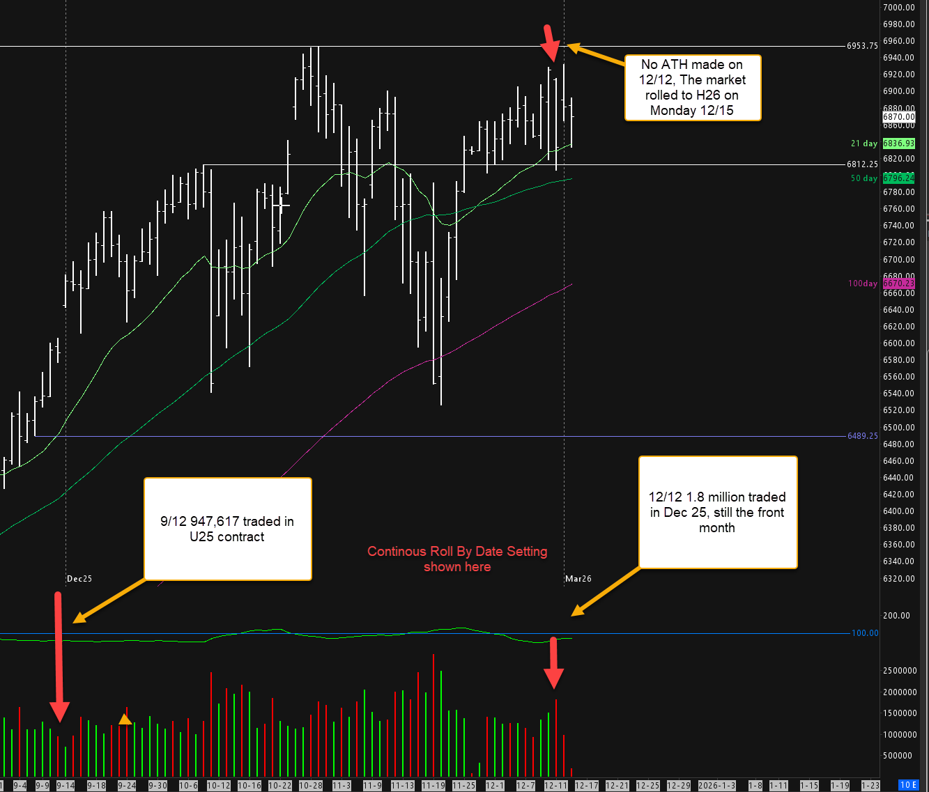

Ive attached two examples that highlight the issue with the volume based continuation settings. The platform is rolling the contract a day early, when volume is still signifcantly higher in the front month. I have attached an All session chart for the ES with annoations showing the issue. The Date based continuation setting is currently showing the correct roll data.

At some point the volume traded on the H 2026 contract was higher than the volume on the Z 2025 contract. This does not need to be the data at the end of the day, it just needs to occur at some point and then Sierra Chart is going to recognize this and recommend a rollover.
You can control whether you get the notification based on Volume or by Date by this setting:
General Settings Window: Detect Rollover Of Current Futures Contracts Symbols Based On Real Time Volume (Global Settings >> General Settings >> Charts >> Symbol)
With regards to the gap between the U 2025 and Z 2025 contracts, what is your "Continuous Contract" option set to? You will only not get that gap if you are using one of the "Back Adjusted" options.

The chart should be showing the bar with the most volume. It is showing a bar with 1/10th of the volume of the front month. In this instance it is plotting an incorrect All time high. Dec25 had 1.8 million traded on 12/12 and the chart is showing H26 as the front month with 182k as the front month. Can the settings be adjusted to plot the bar based on Total Volume for the session? As the setting implies.... It is giving the Wrong Information for rollover, consistently. CQG does not have this issue.

When it comes to the construction of the chart bars, this is how it works:
Although the volume is for the entire 24 hour period.
This only applies to the rollover notice:
It has no effect on the construction of chart bars for a Continuous Futures Contract Chart.
We do not observe any issue at this time:
https://www.sierrachart.com/image.php?Image=1765926979511.png
If you still notice an issue, re-download the historical daily data only for the last two contract months:
There is definitively no issue here for us to resolve. Maybe there was an issue at the time, with the end of day volume data, from our data provider but we cannot determine that at this time.
