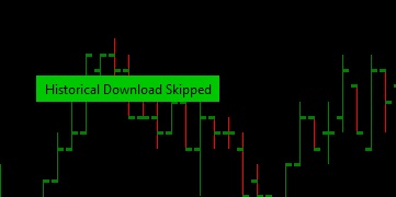

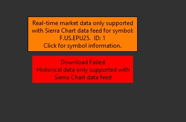

My charts are not getting live data atm, could you please direct me on this, thanks.
From the log:
2025-09-03 19:58:03.159 | Rithmic Direct - DTC | Starting real-time market data updates for: ESU5.CME. ID: 1 Service code: rithmic.trading
2025-09-03 19:58:03.159 | Rithmic Direct - DTC | Server indicated market data is not supported. Not sending market data request. Symbol: ESU5.CME.
2025-09-03 19:58:03.159 | Rithmic Direct - DTC | Requesting security definition data for: ESU5.CME. ID: 1
2025-09-03 19:58:03.159 | Requesting market depth updates for: ESU5.CME if supported. NumLevels=100
2025-09-03 19:58:03.159 | Separate subscription for market depth updates not supported. ESU5.CME
2025-09-03 19:58:03.159 | Rithmic Direct - DTC | Using primary service for historical data for ESU5.CME
2025-09-03 19:58:03.159 | Historical data service client indicated that downloads are not enabled. Symbol: ESU5.CME. Data Type: Intraday data.
2025-09-03 19:58:03.159 | Historical data download ID 2 not found when removing ID from outstanding request set.
2025-09-03 19:58:03.159 | Real-time Intraday chart data file updates started for ESU5.CME
2025-09-03 19:58:03.159 | Intraday chart data file opened for ESU5.CME
Thanks.
Angelo

[2025-09-04 17:06:11]
User272786 - Posts: 17
Also please note following.
Until about 2-3days ago, everything was working fine and I have not changed any settings since.
Please find couple of Chart messages, from two instances(two different brokers, but both use Rithmic), attached.
imageChart Messages1.jpg / V - Attached On 2025-09-04 17:05:33 UTC - Size: 18.28 KB - 245 views
imageChart Messages2.jpg / V - Attached On 2025-09-04 17:05:41 UTC - Size: 12.43 KB - 165 views
[2025-09-04 17:08:39]
Sierra_Chart Engineering - Posts: 25362
In your case the solution is simple. Activate the exchange that you need here:
[2025-09-04 17:23:03]
Thanks for that!
It works now.
As the very first step, I was looking to see if any data service was inactive, but I was NOT looking at this specific page that you mentioned, hence missed it.
Anyhow, next time, I would know where to look.
Thanks again.
Angelo
