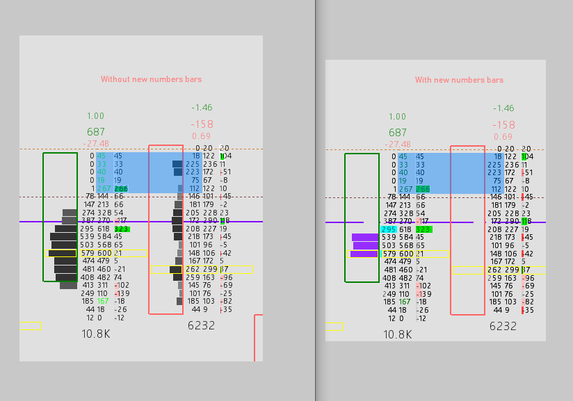

Context:
I currently have a
- Numbers Bars with 3 columns
- The 1st column is a volume profile colored based on volume percentage
I would like a
- 2nd Numbers Bars with 3 columns to add some features
- Eg: I would like to now colour the 1st column which is a volume profile just like from previous Numbers Bars but with actual volume
- I specifically only wanted to highlight high volume price levels in the Numbers Bar relative to the session so I made all the other colors equal to my background except Range 3 color
Problem:
- Clearly, the colors start conflicting. I.e depending on the order of the studies, 1 will hide the other or mess up.
- I have attached a picture to show what I mean by "conflicting"
- So I tried a "Color Bar ... Based on Alert Condition" and tried VAP(C,0) > XXX. This doesn't work either
Qn:
- Is there any way to circumvent this?
Thanks!

[2025-08-25 15:15:47]
There is not a way around what is occurring due to what you are doing. Although it is possible to have multiple Numbers Bars studies on a chart, they need to be very closely setup so that they do not overwrite each other. Refer to the following:
Numbers Bars: Using Multiple Numbers Bars Studies on the Same Chart

[2025-08-26 13:04:27]
The formula is fine, but it is stating that the total volume at the close of the bar needs to be greater than 1000. Is that the case somewhere?
Also, if you are using this with a Numbers Bars study, then the "Draw Style" setting of "Color Bar" will not do anything, as there is no bar to color. You need to use some other option. To color a price level, use the "Draw Style" of "Color Background at Price". Refer to the following:
Chart Studies: Color Background At Price (ACSIL: DRAWSTYLE_COLOR_BACKGROUND_AT_PRICE)
Keep in mind that you will then need to tell the "Color Bar Based on Alert Condition" the actual price level. to color. To do this for the close of the bar (to match your condition), set the following:
- Output when Condition True: Study Subgraph Reference
- Study Subgraph Reference Value when True: <Main Price Graph> and Last (SG4)
