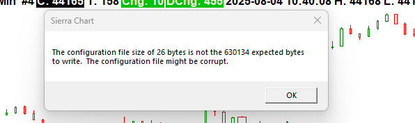

Gradient - Posts: 219
I received the following error when attempting to save chartbooks.
It states that the configuration file could be corrupt.
imageConfig File Error.png / V - Attached On 2025-08-04 14:41:31 UTC - Size: 13.23 KB - 276 views
[2025-08-04 19:01:36]
Refer to the following to restore a backup configuration file:
Resetting Sierra Chart to a Default State / Restoring Backup Global Configuration File: Restoring Backup Global Configuration File
With regards to the charts and the settings changing, the one thing we want to point out is that the Chartbook Groups are kept completely separate from the chartbooks stored in the 'Data' folder. So if you open a Chartbook Group that contains ChartbookA, ChartbookB, and ChartbookC, those are not the same chartbooks as those found in the 'Data' folder, or what you would see if you open the chartbook individually.
We wonder if you are seeing one setup with the Chartbook Group and another when you are viewing the chartbook alone.
