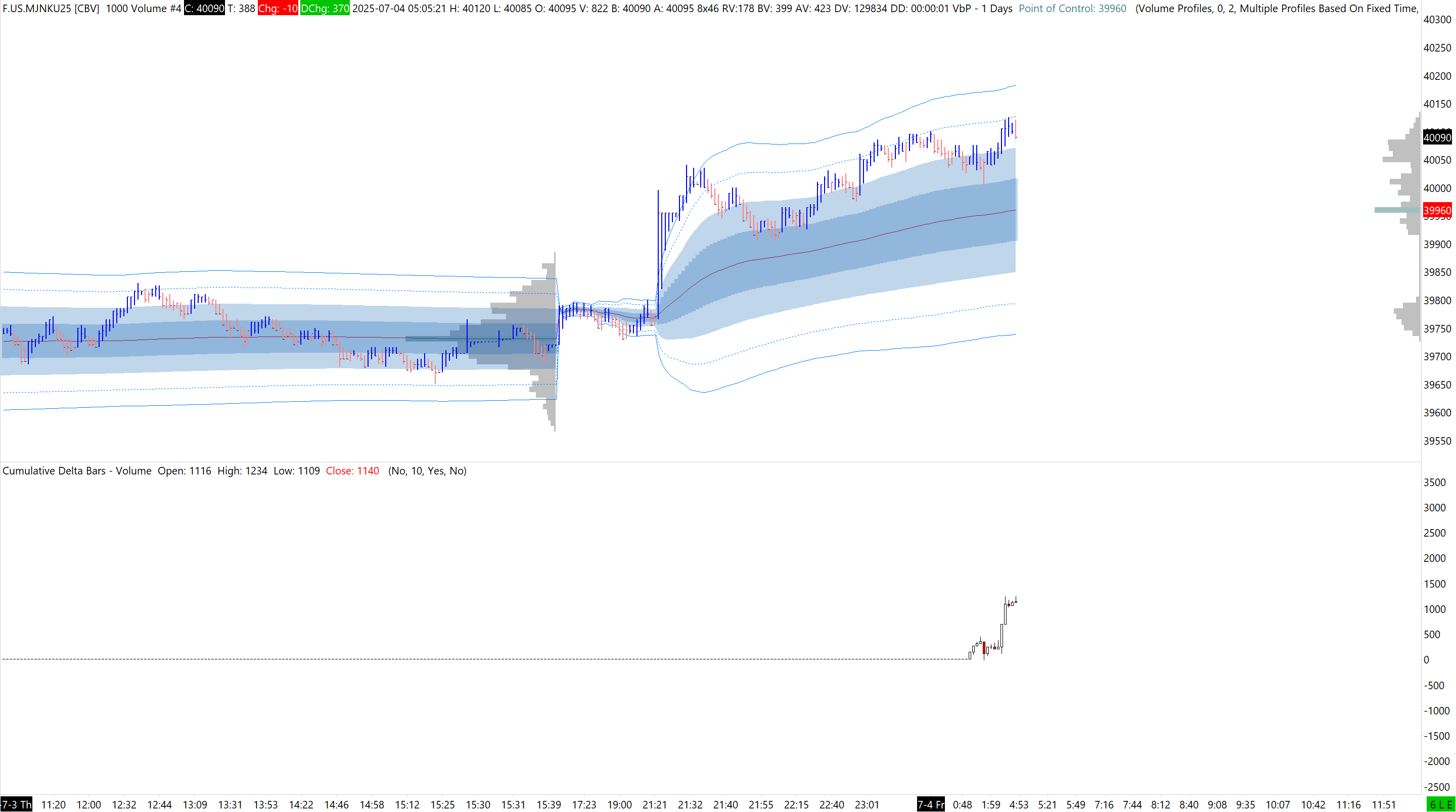

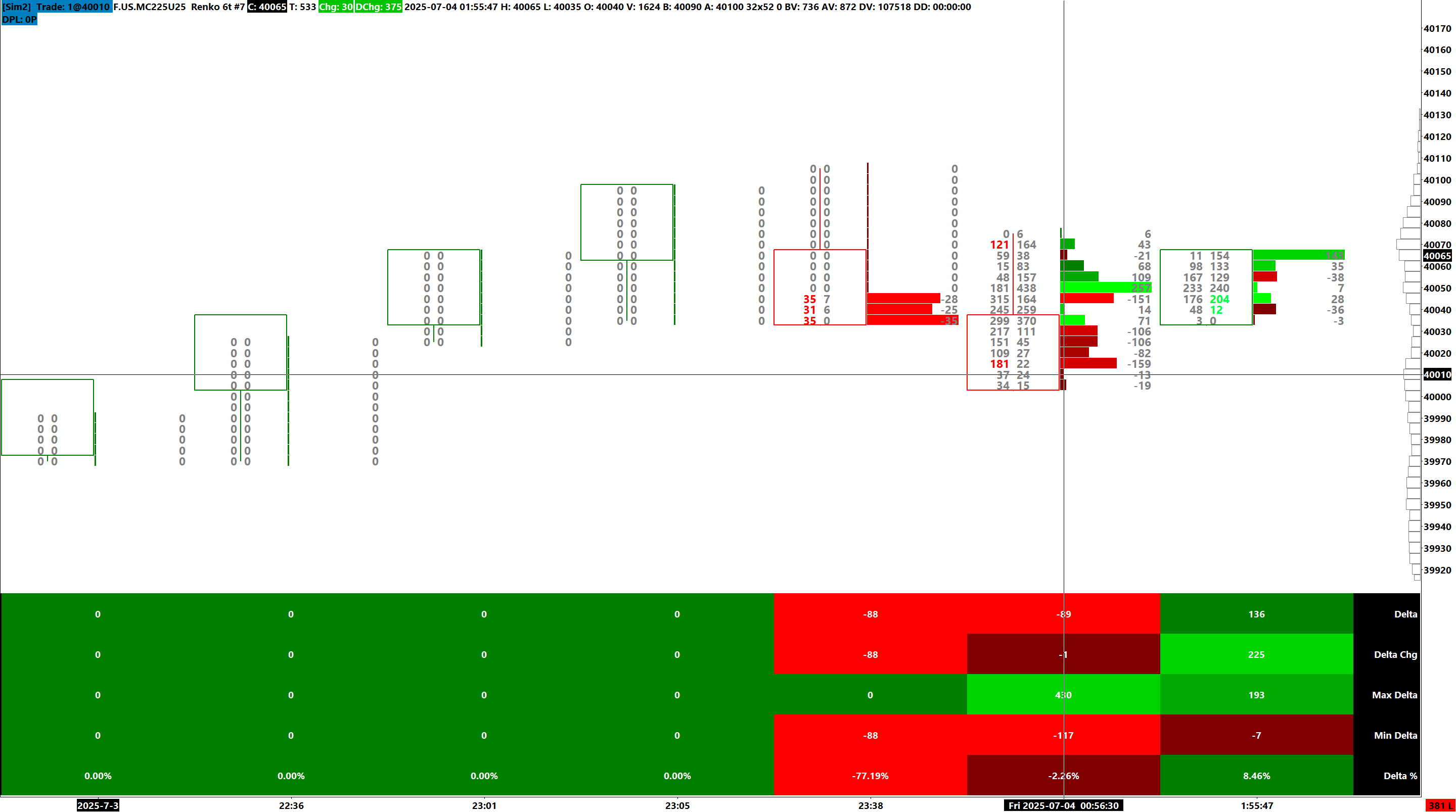

Hi Sierra Chart, I just started using CQG for Nikkei futures on OSE. live data works fine. DOM is working fine. However, my footprint and cumulative delta chart are showing only data from today. No history. I tried multiple times delete and download, as well as all the tips in the documentation. Could you please advise what could be done? Thank you. Best regards, Wen |

There you go. Thank you for looking into it John. https://www.sierrachart.com/image.php?Image=1751573123693.png https://www.sierrachart.com/image.php?Image=1751573157213.png |

Follow the instructions here to clear the Message Log: Message Log: Clearing the Message Log Fully re-download the data in the chart by going to the chart and selecting "Edit >> Delete All Data and Download". Only use this command from the Edit menu at the top of the main window or chart. Or, in the case of a Continuous Futures Contract chart, follow these instructions: Continuous Futures Contract Charts: Re-Downloading Continuous Futures Contract Data After about a minute provide a copy of the Message Log following these instructions: Support Board Posting Information: How to Post Your Message Log (Required In Some Cases) We will then determine what the problem is. Sierra Chart Support - Engineering Level Your definitive source for support. Other responses are from users. Try to keep your questions brief and to the point. Be aware of support policy: https://www.sierrachart.com/index.php?l=PostingInformation.php#GeneralInformation For the most reliable, advanced, and zero cost futures order routing, use the Teton service: Sierra Chart Teton Futures Order Routing |

Hi there, Thank you so much for getting back to me on this. After completing step2 in your instruction (delete all and download), I now can see my Footprint and CD have data dated back to Jun-10. But I cannot go back further. Please see the message log below. 2025-07-04 11:30:23.065 | Software version: 2657 64-bit 2025-07-04 11:30:23.065 | Primary Thread ID: 12208 2025-07-04 11:30:23.065 | Usage end date: 2025-07-16 2025-07-04 11:30:23.065 | Enabled for: Advanced Features 2. 2025-07-04 11:30:23.065 | Enabled for: Sierra Chart Historical Data Service. 2025-07-04 11:30:23.065 | Enabled for: Denali Real-Time Exchange Data Feed. 2025-07-04 11:30:23.065 | Enabled for: Delayed Denali Exchange Data Feed. 2025-07-04 11:30:23.065 | Enabled for exchange2: CME 2025-07-04 11:30:23.065 | Allow Support for Sierra Chart Data Feeds is enabled. 2025-07-04 11:30:23.065 | Current selected Data/Trading service: CQG WebAPI 2025-07-04 11:30:23.065 | Custom symbol settings values: enabled 2025-07-04 11:30:23.065 | Chart Update Interval: 500 2025-07-04 11:30:23.065 | Intraday Data Storage Time Unit: 0 2025-07-04 11:30:23.065 | Time Zone: -04:00:00 (EST-05EDT+01,M3.2.0/02:00,M11.1.0/02:00) 2025-07-04 11:30:23.065 | 2025-07-04 15:30:23 Local computer time in UTC 2025-07-04 11:30:23.065 | 2025-07-04 11:30:23 Local computer time in SC Time Zone 2025-07-04 11:30:23.065 | 2025-07-03 15:45:25 Server time in UTC 2025-07-04 11:30:23.065 | Local computer UTC time and Server UTC time difference: 3 seconds. 2025-07-04 11:30:23.065 | Program path: C:\SierraChart\ 2025-07-04 11:30:23.065 | Data Files path: C:\SierraChart\Data\ 2025-07-04 11:30:23.070 | OS Version Number: 10.0 2025-07-04 11:30:23.070 | Locale Setting: C 2025-07-04 11:30:23.075 | DLLs: UserContributedStudies_64.dll 2025-07-04 11:30:23.075 | Allowed protected custom studies: 2025-07-04 11:30:23.075 | Crash reporter started: true 2025-07-04 11:30:23.075 | 2025-07-04 11:33:38.894 | Source file does not exist when saving backup of C:\SierraChart\SymbolSettings\CustomSymbolSettings.cqg.xml. No backup made. 2025-07-04 11:34:58.965 | F.US.MC225U25 Renko 6t #7 | Reloading chart. 2025-07-04 11:34:59.165 | F.US.MC225U25 Renko 6t #7 | StartDateTimeForLoadingOrderFills: 2025-06-21 00:00:00 2025-07-04 11:34:59.227 | F.US.MC225U25 Renko 6t #7 | Chart data loading complete. 2025-07-04 11:37:37.173 | CQG WebAPI | Using primary service for historical data for F.US.MC225U25 2025-07-04 11:37:37.173 | Added historical Intraday data request for F.US.MC225U25 to the queue. 2025-07-04 11:37:37.173 | Intraday data recording state for symbol F.US.MC225U25 is set to download 'Pending'. 2025-07-04 11:37:37.174 | Triggering next historical data download in queue. 2025-07-04 11:37:37.174 | HD Request # 97 | Downloading Intraday chart data for F.US.MC225U25 to the file F.US.MC225U25.scid. Service: cqg 2025-07-04 11:37:37.176 | Reloading all charts with filename: F.US.MC225U25.scid 2025-07-04 11:37:37.177 | HD Request # 97 | Download start date-time: 2024-07-09 11:37:37.000000. File last date-time: 00:00:00.000000 2025-07-04 11:37:37.177 | HD Request # 97 | Requesting historical Tick data. 2025-07-04 11:37:37.235 | F.US.MC225U25 [CBV-D] #6 | Reloading chart. 2025-07-04 11:37:37.238 | CQG WebAPI | Using primary service for historical data for F.US.MC225M25 2025-07-04 11:37:37.238 | Added historical Intraday data request for F.US.MC225M25 to the queue. 2025-07-04 11:37:37.238 | Triggering next historical data download in queue. 2025-07-04 11:37:37.246 | CQG WebAPI | Using primary service for historical data for F.US.MC225U25 2025-07-04 11:37:37.246 | Historical Intraday data request for F.US.MC225U25 matches current download and is queued for download since earlier data is requested. 2025-07-04 11:37:37.246 | Added historical Intraday data request for F.US.MC225U25 to the queue. 2025-07-04 11:37:37.248 | F.US.MC225U25 [CBV-D] #6 | Performing continuous chart historical Daily data download for symbol F.US.MC225U25 starting at last date in file. 2025-07-04 11:37:37.248 | CQG WebAPI | Using primary service for historical data for F.US.MC225U25 2025-07-04 11:37:37.248 | Added historical Daily data request for F.US.MC225U25 to the queue. 2025-07-04 11:37:37.260 | F.US.MC225U25 [CBV-D] #6 | Waiting for historical downloads to complete with the IDs: 101, 102, 103, 2025-07-04 11:37:37.322 | F.US.MC225U25 [CBV-D] 600 Volume #2 | Reloading chart. 2025-07-04 11:37:37.324 | CQG WebAPI | Using primary service for historical data for F.US.MC225Z24 2025-07-04 11:37:37.324 | Added historical Intraday data request for F.US.MC225Z24 to the queue. 2025-07-04 11:37:37.324 | Triggering next historical data download in queue. 2025-07-04 11:37:37.327 | CQG WebAPI | Using primary service for historical data for F.US.MC225H25 2025-07-04 11:37:37.327 | Added historical Intraday data request for F.US.MC225H25 to the queue. 2025-07-04 11:37:37.395 | F.US.MC225U25 [CBV-D] 600 Volume #2 | Waiting for historical downloads to complete with the IDs: 100, 101, 103, 104, 105, 2025-07-04 11:37:37.416 | F.US.MC225U25 [CBV-D] #8 | Reloading chart. 2025-07-04 11:37:37.488 | F.US.MC225U25 [CBV-D] #8 | Waiting for historical downloads to complete with the IDs: 100, 101, 103, 104, 105, 2025-07-04 11:37:37.549 | F.US.MC225U25 Renko 6t #7 | Reloading chart. 2025-07-04 11:37:37.556 | F.US.MC225U25 Renko 6t #7 | Currently no data in file to display. Will start historical data download and real-time updates. File: C:\SierraChart\Data\F.US.MC225U25.scid 2025-07-04 11:37:37.562 | F.US.MC225U25 Renko 6t #7 | Chart data loading complete. 2025-07-04 11:38:04.806 | HD Request # 97 | Receiving Intraday data for F.US.MC225U25 starting at 2025-06-13 11:37:38.028000 2025-07-04 11:38:04.811 | HD Request # 97 | Timestamp of first Intraday data file record written: 2025-06-13 11:37:38.028000. 2025-07-04 11:38:04.886 | HD Request # 97 | Received 1510168 Intraday data records from 2025-06-13 11:37:38.028000 to 2025-07-04 11:37:29.424000 (21.0 days. Delay: 35.5 seconds) and wrote 1510168 records for F.US.MC225U25 2025-07-04 11:38:04.887 | HD Request # 97 | Add time&sales data | Remembered last file record date-time: 2025-07-04 15:37:29.424000 2025-07-04 11:38:04.887 | Added 30 Time and Sales records to Intraday data file for F.US.MC225U25 after download. 2025-07-04 11:38:04.887 | HD Request # 97 | Completion time: 27s. 2025-07-04 11:38:04.887 | HD Request # 97 | Intraday data download complete for F.US.MC225U25. Unique request ID: 100 2025-07-04 11:38:04.887 | Removing historical data download ID 100. 2025-07-04 11:38:04.887 | Real-time Intraday chart data file updates started for F.US.MC225U25 2025-07-04 11:38:04.887 | Intraday chart data file opened for F.US.MC225U25 2025-07-04 11:38:04.887 | HD Request # 97 | Enabling Intraday chart updating for symbol. 2025-07-04 11:38:04.887 | 2025-07-04 11:38:04.887 | Triggering next historical data download in queue. 2025-07-04 11:38:04.887 | HD Request # 98 | Downloading Intraday chart data for F.US.MC225M25 to the file F.US.MC225M25.scid. Service: cqg 2025-07-04 11:38:04.887 | HD Request # 98 | Download start date-time: 2025-02-25 19:00:00.000000. File last date-time: 2025-06-12 02:45:01.128105 2025-07-04 11:38:04.887 | HD Request # 98 | Disabling Intraday chart updating for symbol. 2025-07-04 11:38:04.887 | CQG WebAPI | Sending symbol resolution request for F.US.MC225M25. ID: 368075 2025-07-04 11:38:05.008 | CQG WebAPI | Received symbol resolution report for symbol F.US.MC225M25. Search Symbol: F.US.MC225M25. Request ID: 368075. Contract ID: 8. 2025-07-04 11:38:05.008 | HD Request # 98 | Requesting historical Tick data. 2025-07-04 11:38:05.601 | F.US.MC225U25 Renko 6t #7 | StartDateTimeForLoadingOrderFills: 2025-06-21 00:00:00 2025-07-04 11:38:08.948 | Opened cached Intraday file: C:\SierraChart\Data\F.US.MC225U25.scid. Thread ID: 30044 2025-07-04 11:38:09.274 | HD Request # 98 | Receiving Intraday data for F.US.MC225M25 starting at 2025-06-09 19:59:59.264000 2025-07-04 11:38:09.274 | HD Request # 98 | Truncating file to starting date-time of 2025-06-09 19:59:59.264. 2025-07-04 11:38:09.281 | HD Request # 98 | Timestamp of first Intraday data file record written: 2025-06-09 19:59:59.264000. 2025-07-04 11:38:09.288 | HD Request # 98 | Received 174598 Intraday data records from 2025-06-09 19:59:59.264000 to 2025-06-12 02:45:01.128105 (2.3 days. Delay: 22.4 days) and wrote 174598 records for F.US.MC225M25 2025-07-04 11:38:09.288 | HD Request # 98 | Add time&sales data | Remembered last file record date-time: 2025-06-12 06:45:01.128105 2025-07-04 11:38:09.288 | HD Request # 98 | Completion time: 5s. 2025-07-04 11:38:09.288 | HD Request # 98 | Intraday data download complete for F.US.MC225M25. Unique request ID: 101 2025-07-04 11:38:09.288 | Removing historical data download ID 101. 2025-07-04 11:38:09.288 | Real-time Intraday chart data file updates started for F.US.MC225M25 2025-07-04 11:38:09.288 | Intraday chart data file opened for F.US.MC225M25 2025-07-04 11:38:09.288 | HD Request # 98 | Enabling Intraday chart updating for symbol. 2025-07-04 11:38:09.288 | 2025-07-04 11:38:09.288 | Triggering next historical data download in queue. 2025-07-04 11:38:09.288 | HD Request # 99 | Downloading Intraday chart data for F.US.MC225U25 to the file F.US.MC225U25.scid. Service: cqg 2025-07-04 11:38:09.288 | HD Request # 99 | Download start date-time: 2025-05-27 20:00:00.000000. File last date-time: 2025-07-04 11:38:07.108000 2025-07-04 11:38:09.288 | HD Request # 99 | Disabling Intraday chart updating for symbol. 2025-07-04 11:38:09.288 | HD Request # 99 | Requesting historical Tick data. 2025-07-04 11:38:35.331 | HD Request # 99 | Receiving Intraday data for F.US.MC225U25 starting at 2025-06-13 11:38:23.088000 2025-07-04 11:38:35.331 | HD Request # 99 | Truncating file to starting date-time of 2025-06-13 11:38:23.088. 2025-07-04 11:38:35.346 | HD Request # 99 | Timestamp of first Intraday data file record written: 2025-06-13 11:38:23.088000. 2025-07-04 11:38:35.410 | HD Request # 99 | Received 1510153 Intraday data records from 2025-06-13 11:38:23.088000 to 2025-07-04 11:38:07.064000 (21.0 days. Delay: 28.3 seconds) and wrote 1510153 records for F.US.MC225U25 2025-07-04 11:38:35.410 | HD Request # 99 | Add time&sales data | Remembered last file record date-time: 2025-07-04 15:38:07.064000 2025-07-04 11:38:35.410 | Added 6 Time and Sales records to Intraday data file for F.US.MC225U25 after download. 2025-07-04 11:38:35.410 | HD Request # 99 | Completion time: 26s. 2025-07-04 11:38:35.410 | HD Request # 99 | Intraday data download complete for F.US.MC225U25. Unique request ID: 102 2025-07-04 11:38:35.410 | Removing historical data download ID 102. 2025-07-04 11:38:35.410 | Real-time Intraday chart data file updates started for F.US.MC225U25 2025-07-04 11:38:35.410 | Intraday chart data file opened for F.US.MC225U25 2025-07-04 11:38:35.410 | HD Request # 99 | Enabling Intraday chart updating for symbol. 2025-07-04 11:38:35.410 | F.US.MC225U25 [CBV-D] #6 | Flagging to reload Intraday data on download completion. 2025-07-04 11:38:35.410 | F.US.MC225U25 Renko 6t #7 | Flagging to reload Intraday data on download completion. 2025-07-04 11:38:35.410 | F.US.MC225U25 [CBV] 600 Volume #2 | Flagging to reload Intraday data on download completion. 2025-07-04 11:38:35.410 | F.US.MC225U25 [CBV] #8 | Flagging to reload Intraday data on download completion. 2025-07-04 11:38:35.410 | 2025-07-04 11:38:35.410 | Triggering next historical data download in queue. 2025-07-04 11:38:35.411 | HD Request # 100 | Downloading Historical Daily chart data for F.US.MC225U25. Starting date: 2025-07-03. Service: cqg 2025-07-04 11:38:35.411 | HD Request # 100 | Downloading historical Daily data from starting at 2025-07-02. ContractID: 3 2025-07-04 11:38:35.451 | F.US.MC225U25 [CBV] 600 Volume #2 | Reloading chart. 2025-07-04 11:38:35.519 | F.US.MC225U25 [CBV] 600 Volume #2 | Waiting for historical downloads to complete with the IDs: 103, 104, 105, 2025-07-04 11:38:35.524 | F.US.MC225U25 [CBV] #6 | Reloading chart. 2025-07-04 11:38:35.536 | F.US.MC225U25 [CBV] #6 | Waiting for historical downloads to complete with the IDs: 103, 2025-07-04 11:38:35.544 | F.US.MC225U25 [CBV] #8 | Reloading chart. 2025-07-04 11:38:35.616 | F.US.MC225U25 [CBV] #8 | Waiting for historical downloads to complete with the IDs: 103, 104, 105, 2025-07-04 11:38:35.617 | F.US.MC225U25 Renko 6t #7 | Reloading chart. 2025-07-04 11:38:35.780 | HD Request # 100 | Receiving historical Daily data for F.US.MC225U25 starting at 2025-07-03. 2025-07-04 11:38:35.781 | HD Request # 100 | Writing historical Daily data to the file F.US.MC225U25.dly. 2025-07-04 11:38:35.783 | HD Request # 100 | Received 4 Daily data records from 2025-07-03 00:00:00 to 2025-07-07 00:00:00 (5.0 days) and wrote 3 records for F.US.MC225U25 2025-07-04 11:38:35.783 | HD Request # 100 | Completion time: 0s. 2025-07-04 11:38:35.783 | HD Request # 100 | Daily data download complete for F.US.MC225U25. Unique request ID: 103 2025-07-04 11:38:35.783 | Removing historical data download ID 103. 2025-07-04 11:38:35.783 | 2025-07-04 11:38:35.783 | Triggering next historical data download in queue. 2025-07-04 11:38:35.783 | HD Request # 101 | Downloading Intraday chart data for F.US.MC225Z24 to the file F.US.MC225Z24.scid. Service: cqg 2025-07-04 11:38:35.784 | HD Request # 101 | Download start date-time: 2024-08-27 20:00:00.000000. File last date-time: 00:00:00.000000 2025-07-04 11:38:35.784 | CQG WebAPI | Sending symbol resolution request for F.US.MC225Z24. ID: 368079 2025-07-04 11:38:35.784 | F.US.MC225U25 [CBV] #6 | Download is complete for all contract months in chart. Proceeding with data load. 2025-07-04 11:38:35.784 | F.US.MC225U25 [CBV] #6 | Reloading chart. | Number times message added: 1 2025-07-04 11:38:35.917 | F.US.MC225U25 [CBV] #6 | StartDateTimeForLoadingOrderFills: 2024-07-18 00:00:00 2025-07-04 11:38:35.922 | F.US.MC225U25 [CBV] #6 | Chart data loading complete. 2025-07-04 11:38:35.922 | CQG WebAPI | Received symbol resolution report for symbol F.US.MC225Z24. Search Symbol: F.US.MC225Z24. Request ID: 368079. Contract ID: 9. 2025-07-04 11:38:35.922 | HD Request # 101 | Requesting historical Tick data. 2025-07-04 11:38:36.005 | HD Request # 101 | Error downloading historical Intraday data for F.US.MC225Z24. Requested data is outside allowed range (last 30 days). Result=105. Num Quotes=0 2025-07-04 11:38:36.005 | HD Request # 101 | Received 0 Intraday data records from 00:00:00.000000 to 00:00:00.000000 (0.0 seconds and wrote 0 records for F.US.MC225Z24 2025-07-04 11:38:36.005 | HD Request # 101 | Add time&sales data | Remembered last file record date-time: 00:00:00.000000 2025-07-04 11:38:36.005 | HD Request # 101 | Completion time: 1s. 2025-07-04 11:38:36.005 | HD Request # 101 | Intraday data download complete for F.US.MC225Z24. Unique request ID: 104 2025-07-04 11:38:36.005 | Removing historical data download ID 104. 2025-07-04 11:38:36.005 | Real-time Intraday chart data file updates started for F.US.MC225Z24 2025-07-04 11:38:36.005 | Intraday chart data file opened for F.US.MC225Z24 2025-07-04 11:38:36.005 | HD Request # 101 | Enabling Intraday chart updating for symbol. 2025-07-04 11:38:36.005 | 2025-07-04 11:38:36.005 | Triggering next historical data download in queue. 2025-07-04 11:38:36.005 | HD Request # 102 | Downloading Intraday chart data for F.US.MC225H25 to the file F.US.MC225H25.scid. Service: cqg 2025-07-04 11:38:36.006 | HD Request # 102 | Download start date-time: 2024-11-26 19:00:00.000000. File last date-time: 00:00:00.000000 2025-07-04 11:38:36.006 | CQG WebAPI | Sending symbol resolution request for F.US.MC225H25. ID: 368081 2025-07-04 11:38:36.141 | CQG WebAPI | Received symbol resolution report for symbol F.US.MC225H25. Search Symbol: F.US.MC225H25. Request ID: 368081. Contract ID: 10. 2025-07-04 11:38:36.141 | HD Request # 102 | Requesting historical Tick data. 2025-07-04 11:38:36.183 | F.US.MC225U25 Renko 6t #7 | StartDateTimeForLoadingOrderFills: 2025-06-21 00:00:00 2025-07-04 11:38:36.190 | F.US.MC225U25 Renko 6t #7 | Chart data loading complete. 2025-07-04 11:38:36.223 | HD Request # 102 | Error downloading historical Intraday data for F.US.MC225H25. Requested data is outside allowed range (last 30 days). Result=105. Num Quotes=0 2025-07-04 11:38:36.223 | HD Request # 102 | Received 0 Intraday data records from 00:00:00.000000 to 00:00:00.000000 (0.0 seconds and wrote 0 records for F.US.MC225H25 2025-07-04 11:38:36.223 | HD Request # 102 | Add time&sales data | Remembered last file record date-time: 00:00:00.000000 2025-07-04 11:38:36.223 | HD Request # 102 | Completion time: 0s. 2025-07-04 11:38:36.223 | HD Request # 102 | Intraday data download complete for F.US.MC225H25. Unique request ID: 105 2025-07-04 11:38:36.223 | Removing historical data download ID 105. 2025-07-04 11:38:36.223 | Real-time Intraday chart data file updates started for F.US.MC225H25 2025-07-04 11:38:36.223 | Intraday chart data file opened for F.US.MC225H25 2025-07-04 11:38:36.223 | HD Request # 102 | Enabling Intraday chart updating for symbol. 2025-07-04 11:38:36.223 | 2025-07-04 11:38:36.223 | No download requests in the queue to start downloads for. 2025-07-04 11:38:36.441 | F.US.MC225U25 [CBV] 600 Volume #2 | Download is complete for all contract months in chart. Proceeding with data load. 2025-07-04 11:38:36.442 | F.US.MC225U25 [CBV] 600 Volume #2 | Reloading chart. 2025-07-04 11:38:36.537 | F.US.MC225U25 [CBV] #8 | Download is complete for all contract months in chart. Proceeding with data load. 2025-07-04 11:38:36.538 | F.US.MC225U25 [CBV] #8 | Reloading chart. 2025-07-04 11:38:36.811 | F.US.MC225U25 [CBV] #8 | Chart data loading complete. 2025-07-04 11:38:36.948 | F.US.MC225U25 [CBV] 600 Volume #2 | Reloading chart. 2025-07-04 11:38:37.091 | F.US.MC225U25 [CBV] 600 Volume #2 | StartDateTimeForLoadingOrderFills: 2025-07-05 00:00:00 2025-07-04 11:38:37.378 | F.US.MC225U25 [CBV] 600 Volume #2 | Chart data loading complete. 2025-07-04 11:38:37.466 | F.US.MC225U25 [CBV] #8 | Reloading chart. 2025-07-04 11:38:37.774 | F.US.MC225U25 [CBV] #8 | Chart data loading complete. 2025-07-04 11:38:44.192 | Opened cached Intraday file: C:\SierraChart\Data\F.US.MC225U25.scid. Thread ID: 30044 2025-07-04 11:39:30.479 | CQG WebAPI | Using primary service for historical data for F.US.MJNKU25 2025-07-04 11:39:30.479 | Added historical Intraday data request for F.US.MJNKU25 to the queue. 2025-07-04 11:39:30.479 | Intraday data recording state for symbol F.US.MJNKU25 is set to download 'Pending'. 2025-07-04 11:39:30.479 | Triggering next historical data download in queue. 2025-07-04 11:39:30.479 | HD Request # 103 | Downloading Intraday chart data for F.US.MJNKU25 to the file F.US.MJNKU25.scid. Service: cqg 2025-07-04 11:39:30.499 | Reloading all charts with filename: F.US.MJNKU25.scid 2025-07-04 11:39:30.500 | HD Request # 103 | Download start date-time: 2024-07-09 11:39:30.000000. File last date-time: 00:00:00.000000 2025-07-04 11:39:30.500 | HD Request # 103 | Requesting historical Tick data. 2025-07-04 11:39:30.783 | F.US.MJNKU25 [CBV-D] 5000 Volume #3 | Reloading chart. 2025-07-04 11:39:30.786 | CQG WebAPI | Using primary service for historical data for F.US.MJNKZ24 2025-07-04 11:39:30.786 | Added historical Intraday data request for F.US.MJNKZ24 to the queue. 2025-07-04 11:39:30.786 | Triggering next historical data download in queue. 2025-07-04 11:39:30.788 | CQG WebAPI | Using primary service for historical data for F.US.MJNKH25 2025-07-04 11:39:30.788 | Added historical Intraday data request for F.US.MJNKH25 to the queue. 2025-07-04 11:39:30.790 | CQG WebAPI | Using primary service for historical data for F.US.MJNKM25 2025-07-04 11:39:30.790 | Added historical Intraday data request for F.US.MJNKM25 to the queue. 2025-07-04 11:39:30.791 | CQG WebAPI | Using primary service for historical data for F.US.MJNKU25 2025-07-04 11:39:30.791 | Historical Intraday data request for F.US.MJNKU25 matches current download and is queued for download since earlier data is requested. 2025-07-04 11:39:30.792 | Added historical Intraday data request for F.US.MJNKU25 to the queue. 2025-07-04 11:39:30.793 | F.US.MJNKU25 [CBV-D] 5000 Volume #3 | Performing continuous chart historical Daily data download for symbol F.US.MJNKU25 starting at last date in file. 2025-07-04 11:39:30.793 | CQG WebAPI | Using primary service for historical data for F.US.MJNKU25 2025-07-04 11:39:30.793 | Added historical Daily data request for F.US.MJNKU25 to the queue. 2025-07-04 11:39:30.859 | F.US.MJNKU25 [CBV-D] 5000 Volume #3 | Waiting for historical downloads to complete with the IDs: 107, 108, 109, 110, 111, 2025-07-04 11:39:30.868 | F.US.MJNKU25 Renko 6t #9 | Reloading chart. 2025-07-04 11:39:30.876 | F.US.MJNKU25 Renko 6t #9 | Currently no data in file to display. Will start historical data download and real-time updates. File: C:\SierraChart\Data\F.US.MJNKU25.scid 2025-07-04 11:39:30.876 | F.US.MJNKU25 Renko 6t #9 | Chart data loading complete. 2025-07-04 11:39:30.881 | F.US.MJNKU25 [CBV-D] 600 Volume #10 | Reloading chart. 2025-07-04 11:39:30.951 | F.US.MJNKU25 [CBV-D] 600 Volume #10 | Waiting for historical downloads to complete with the IDs: 106, 107, 108, 109, 111, 2025-07-04 11:40:00.147 | HD Request # 103 | Receiving Intraday data for F.US.MJNKU25 starting at 2025-06-13 11:39:31.204000 2025-07-04 11:40:00.149 | HD Request # 103 | Timestamp of first Intraday data file record written: 2025-06-13 11:39:31.204000. 2025-07-04 11:40:00.354 | HD Request # 103 | Received 2894108 Intraday data records from 2025-06-13 11:39:31.204000 to 2025-07-04 11:39:20.976002 (21.0 days. Delay: 39.4 seconds) and wrote 2894108 records for F.US.MJNKU25 2025-07-04 11:40:00.355 | HD Request # 103 | Add time&sales data | Remembered last file record date-time: 2025-07-04 15:39:20.976002 2025-07-04 11:40:00.355 | Added 23 Time and Sales records to Intraday data file for F.US.MJNKU25 after download. 2025-07-04 11:40:00.355 | HD Request # 103 | Completion time: 30s. 2025-07-04 11:40:00.355 | HD Request # 103 | Intraday data download complete for F.US.MJNKU25. Unique request ID: 106 2025-07-04 11:40:00.355 | Removing historical data download ID 106. 2025-07-04 11:40:00.355 | Real-time Intraday chart data file updates started for F.US.MJNKU25 2025-07-04 11:40:00.355 | Intraday chart data file opened for F.US.MJNKU25 2025-07-04 11:40:00.355 | HD Request # 103 | Enabling Intraday chart updating for symbol. 2025-07-04 11:40:00.355 | 2025-07-04 11:40:00.355 | Triggering next historical data download in queue. 2025-07-04 11:40:00.355 | HD Request # 104 | Downloading Intraday chart data for F.US.MJNKZ24 to the file F.US.MJNKZ24.scid. Service: cqg 2025-07-04 11:40:00.355 | HD Request # 104 | Download start date-time: 2024-08-27 20:00:00.000000. File last date-time: 00:00:00.000000 2025-07-04 11:40:00.355 | CQG WebAPI | Sending symbol resolution request for F.US.MJNKZ24. ID: 368084 2025-07-04 11:40:01.404 | F.US.MJNKU25 Renko 6t #9 | StartDateTimeForLoadingOrderFills: 2025-06-21 00:00:00 2025-07-04 11:40:01.424 | CQG WebAPI | Received symbol resolution report for symbol F.US.MJNKZ24. Search Symbol: F.US.MJNKZ24. Request ID: 368084. Contract ID: 11. 2025-07-04 11:40:01.424 | HD Request # 104 | Requesting historical Tick data. 2025-07-04 11:40:01.556 | HD Request # 104 | Error downloading historical Intraday data for F.US.MJNKZ24. Requested data is outside allowed range (last 30 days). Result=105. Num Quotes=0 2025-07-04 11:40:01.556 | HD Request # 104 | Received 0 Intraday data records from 00:00:00.000000 to 00:00:00.000000 (0.0 seconds and wrote 0 records for F.US.MJNKZ24 2025-07-04 11:40:01.556 | HD Request # 104 | Add time&sales data | Remembered last file record date-time: 00:00:00.000000 2025-07-04 11:40:01.556 | HD Request # 104 | Completion time: 1s. 2025-07-04 11:40:01.556 | HD Request # 104 | Intraday data download complete for F.US.MJNKZ24. Unique request ID: 107 2025-07-04 11:40:01.556 | Removing historical data download ID 107. 2025-07-04 11:40:01.556 | Real-time Intraday chart data file updates started for F.US.MJNKZ24 2025-07-04 11:40:01.556 | Intraday chart data file opened for F.US.MJNKZ24 2025-07-04 11:40:01.556 | HD Request # 104 | Enabling Intraday chart updating for symbol. 2025-07-04 11:40:01.557 | 2025-07-04 11:40:01.557 | Triggering next historical data download in queue. 2025-07-04 11:40:01.557 | HD Request # 105 | Downloading Intraday chart data for F.US.MJNKH25 to the file F.US.MJNKH25.scid. Service: cqg 2025-07-04 11:40:01.557 | HD Request # 105 | Download start date-time: 2024-11-26 19:00:00.000000. File last date-time: 00:00:00.000000 2025-07-04 11:40:01.557 | CQG WebAPI | Sending symbol resolution request for F.US.MJNKH25. ID: 368086 2025-07-04 11:40:01.682 | CQG WebAPI | Received symbol resolution report for symbol F.US.MJNKH25. Search Symbol: F.US.MJNKH25. Request ID: 368086. Contract ID: 12. 2025-07-04 11:40:01.682 | HD Request # 105 | Requesting historical Tick data. 2025-07-04 11:40:01.765 | HD Request # 105 | Error downloading historical Intraday data for F.US.MJNKH25. Requested data is outside allowed range (last 30 days). Result=105. Num Quotes=0 2025-07-04 11:40:01.765 | HD Request # 105 | Received 0 Intraday data records from 00:00:00.000000 to 00:00:00.000000 (0.0 seconds and wrote 0 records for F.US.MJNKH25 2025-07-04 11:40:01.765 | HD Request # 105 | Add time&sales data | Remembered last file record date-time: 00:00:00.000000 2025-07-04 11:40:01.765 | HD Request # 105 | Completion time: 0s. 2025-07-04 11:40:01.765 | HD Request # 105 | Intraday data download complete for F.US.MJNKH25. Unique request ID: 108 2025-07-04 11:40:01.765 | Removing historical data download ID 108. 2025-07-04 11:40:01.765 | Real-time Intraday chart data file updates started for F.US.MJNKH25 2025-07-04 11:40:01.765 | Intraday chart data file opened for F.US.MJNKH25 2025-07-04 11:40:01.765 | HD Request # 105 | Enabling Intraday chart updating for symbol. 2025-07-04 11:40:01.765 | 2025-07-04 11:40:01.765 | Triggering next historical data download in queue. 2025-07-04 11:40:01.765 | HD Request # 106 | Downloading Intraday chart data for F.US.MJNKM25 to the file F.US.MJNKM25.scid. Service: cqg 2025-07-04 11:40:01.765 | HD Request # 106 | Download start date-time: 2025-02-25 19:00:00.000000. File last date-time: 2025-06-12 02:45:01.128146 2025-07-04 11:40:01.765 | HD Request # 106 | Disabling Intraday chart updating for symbol. 2025-07-04 11:40:01.765 | CQG WebAPI | Sending symbol resolution request for F.US.MJNKM25. ID: 368088 2025-07-04 11:40:01.887 | CQG WebAPI | Received symbol resolution report for symbol F.US.MJNKM25. Search Symbol: F.US.MJNKM25. Request ID: 368088. Contract ID: 13. 2025-07-04 11:40:01.887 | HD Request # 106 | Requesting historical Tick data. 2025-07-04 11:40:04.749 | Opened cached Intraday file: C:\SierraChart\Data\F.US.MJNKU25.scid. Thread ID: 30044 2025-07-04 11:40:06.666 | HD Request # 106 | Receiving Intraday data for F.US.MJNKM25 starting at 2025-06-09 19:59:59.580000 2025-07-04 11:40:06.666 | HD Request # 106 | Truncating file to starting date-time of 2025-06-09 19:59:59.580. 2025-07-04 11:40:06.691 | HD Request # 106 | Timestamp of first Intraday data file record written: 2025-06-09 19:59:59.580000. 2025-07-04 11:40:06.705 | HD Request # 106 | Received 338887 Intraday data records from 2025-06-09 19:59:59.580000 to 2025-06-12 02:45:01.128146 (2.3 days. Delay: 22.4 days) and wrote 338887 records for F.US.MJNKM25 2025-07-04 11:40:06.705 | HD Request # 106 | Add time&sales data | Remembered last file record date-time: 2025-06-12 06:45:01.128146 2025-07-04 11:40:06.705 | HD Request # 106 | Completion time: 5s. 2025-07-04 11:40:06.705 | HD Request # 106 | Intraday data download complete for F.US.MJNKM25. Unique request ID: 109 2025-07-04 11:40:06.705 | Removing historical data download ID 109. 2025-07-04 11:40:06.705 | Real-time Intraday chart data file updates started for F.US.MJNKM25 2025-07-04 11:40:06.705 | Intraday chart data file opened for F.US.MJNKM25 2025-07-04 11:40:06.705 | HD Request # 106 | Enabling Intraday chart updating for symbol. 2025-07-04 11:40:06.705 | 2025-07-04 11:40:06.705 | Triggering next historical data download in queue. 2025-07-04 11:40:06.705 | HD Request # 107 | Downloading Intraday chart data for F.US.MJNKU25 to the file F.US.MJNKU25.scid. Service: cqg 2025-07-04 11:40:06.705 | HD Request # 107 | Download start date-time: 2025-05-27 20:00:00.000000. File last date-time: 2025-07-04 11:40:02.376000 2025-07-04 11:40:06.705 | HD Request # 107 | Disabling Intraday chart updating for symbol. 2025-07-04 11:40:06.705 | HD Request # 107 | Requesting historical Tick data. 2025-07-04 11:40:27.994 | F.US.MC225U25 [CBV] 600 Volume #2 | StartDateTimeForLoadingOrderFills: 2025-07-05 00:00:00 2025-07-04 11:40:34.172 | HD Request # 107 | Receiving Intraday data for F.US.MJNKU25 starting at 2025-06-13 11:40:10.452000 2025-07-04 11:40:34.172 | HD Request # 107 | Truncating file to starting date-time of 2025-06-13 11:40:10.452. 2025-07-04 11:40:34.190 | HD Request # 107 | Timestamp of first Intraday data file record written: 2025-06-13 11:40:10.452000. 2025-07-04 11:40:34.311 | HD Request # 107 | Received 2894096 Intraday data records from 2025-06-13 11:40:10.452000 to 2025-07-04 11:40:02.332000 (21.0 days. Delay: 32.0 seconds) and wrote 2894096 records for F.US.MJNKU25 2025-07-04 11:40:34.311 | HD Request # 107 | Add time&sales data | Remembered last file record date-time: 2025-07-04 15:40:02.332000 2025-07-04 11:40:34.311 | Added 14 Time and Sales records to Intraday data file for F.US.MJNKU25 after download. 2025-07-04 11:40:34.311 | HD Request # 107 | Completion time: 28s. 2025-07-04 11:40:34.311 | HD Request # 107 | Intraday data download complete for F.US.MJNKU25. Unique request ID: 110 2025-07-04 11:40:34.311 | Removing historical data download ID 110. 2025-07-04 11:40:34.311 | Real-time Intraday chart data file updates started for F.US.MJNKU25 2025-07-04 11:40:34.311 | Intraday chart data file opened for F.US.MJNKU25 2025-07-04 11:40:34.311 | HD Request # 107 | Enabling Intraday chart updating for symbol. 2025-07-04 11:40:34.311 | F.US.MJNKU25 [CBV] 5000 Volume #3 | Flagging to reload Intraday data on download completion. 2025-07-04 11:40:34.311 | F.US.MJNKU25 Renko 6t #9 | Flagging to reload Intraday data on download completion. 2025-07-04 11:40:34.311 | F.US.MJNKU25 [CBV] 600 Volume #10 | Flagging to reload Intraday data on download completion. 2025-07-04 11:40:34.311 | 2025-07-04 11:40:34.311 | Triggering next historical data download in queue. 2025-07-04 11:40:34.312 | HD Request # 108 | Downloading Historical Daily chart data for F.US.MJNKU25. Starting date: 2025-07-02. Service: cqg 2025-07-04 11:40:34.312 | HD Request # 108 | Downloading historical Daily data from starting at 2025-07-01. ContractID: 5 2025-07-04 11:40:34.331 | F.US.MJNKU25 [CBV] 5000 Volume #3 | Reloading chart. 2025-07-04 11:40:34.400 | F.US.MJNKU25 [CBV] 5000 Volume #3 | Waiting for historical downloads to complete with the IDs: 111, 2025-07-04 11:40:34.468 | F.US.MJNKU25 [CBV] 600 Volume #10 | Reloading chart. 2025-07-04 11:40:34.539 | F.US.MJNKU25 [CBV] 600 Volume #10 | Waiting for historical downloads to complete with the IDs: 111, 2025-07-04 11:40:34.540 | F.US.MJNKU25 Renko 6t #9 | Reloading chart. 2025-07-04 11:40:34.665 | HD Request # 108 | Receiving historical Daily data for F.US.MJNKU25 starting at 2025-07-02. 2025-07-04 11:40:34.666 | HD Request # 108 | Writing historical Daily data to the file F.US.MJNKU25.dly. 2025-07-04 11:40:34.688 | HD Request # 108 | Received 5 Daily data records from 2025-07-02 00:00:00 to 2025-07-07 00:00:00 (6.0 days) and wrote 4 records for F.US.MJNKU25 2025-07-04 11:40:34.688 | HD Request # 108 | Completion time: 0s. 2025-07-04 11:40:34.688 | HD Request # 108 | Daily data download complete for F.US.MJNKU25. Unique request ID: 111 2025-07-04 11:40:34.688 | Removing historical data download ID 111. 2025-07-04 11:40:34.688 | 2025-07-04 11:40:34.688 | No download requests in the queue to start downloads for. 2025-07-04 11:40:34.834 | F.US.MJNKU25 [CBV] 5000 Volume #3 | Download is complete for all contract months in chart. Proceeding with data load. 2025-07-04 11:40:34.834 | F.US.MJNKU25 [CBV] 5000 Volume #3 | Reloading chart. 2025-07-04 11:40:34.976 | F.US.MJNKU25 [CBV] 600 Volume #10 | Download is complete for all contract months in chart. Proceeding with data load. 2025-07-04 11:40:34.976 | F.US.MJNKU25 [CBV] 600 Volume #10 | Reloading chart. 2025-07-04 11:40:35.345 | F.US.MJNKU25 [CBV] 5000 Volume #3 | Reloading chart. 2025-07-04 11:40:35.594 | F.US.MJNKU25 [CBV] 600 Volume #10 | Reloading chart. 2025-07-04 11:40:36.079 | F.US.MJNKU25 Renko 6t #9 | StartDateTimeForLoadingOrderFills: 2025-06-21 00:00:00 2025-07-04 11:40:36.081 | F.US.MJNKU25 Renko 6t #9 | Chart data loading complete. 2025-07-04 11:40:36.082 | F.US.MJNKU25 [CBV] 5000 Volume #3 | StartDateTimeForLoadingOrderFills: 2024-07-18 00:00:00 2025-07-04 11:40:36.163 | F.US.MJNKU25 [CBV] 5000 Volume #3 | Chart data loading complete. 2025-07-04 11:40:36.232 | F.US.MJNKU25 [CBV] 600 Volume #10 | StartDateTimeForLoadingOrderFills: 2025-07-05 00:00:00 2025-07-04 11:40:36.290 | F.US.MJNKU25 [CBV] 600 Volume #10 | Chart data loading complete. 2025-07-04 11:40:40.017 | Opened cached Intraday file: C:\SierraChart\Data\F.US.MJNKU25.scid. Thread ID: 30044 2025-07-04 11:41:09.900 | CQG WebAPI | Using primary service for historical data for F.US.MC225H25 2025-07-04 11:41:09.900 | Added historical Intraday data request for F.US.MC225H25 to the queue. 2025-07-04 11:41:09.900 | Intraday data recording state for symbol F.US.MC225H25 is set to download 'Pending'. 2025-07-04 11:41:09.900 | Triggering next historical data download in queue. 2025-07-04 11:41:09.900 | Reloading all charts with filename: F.US.MC225H25.scid 2025-07-04 11:41:09.900 | CQG WebAPI | Using primary service for historical data for F.US.MC225H25 2025-07-04 11:41:09.900 | Added historical Daily data request for F.US.MC225H25 to the queue. 2025-07-04 11:41:09.900 | CQG WebAPI | Using primary service for historical data for F.US.MC225M25 2025-07-04 11:41:09.900 | Added historical Intraday data request for F.US.MC225M25 to the queue. 2025-07-04 11:41:09.900 | Intraday data recording state for symbol F.US.MC225M25 is set to download 'Pending'. 2025-07-04 11:41:09.900 | CQG WebAPI | Using primary service for historical data for F.US.MC225M25 2025-07-04 11:41:09.900 | Added historical Daily data request for F.US.MC225M25 to the queue. 2025-07-04 11:41:09.900 | CQG WebAPI | Using primary service for historical data for F.US.MC225U25 2025-07-04 11:41:09.902 | Added historical Intraday data request for F.US.MC225U25 to the queue. 2025-07-04 11:41:09.902 | Intraday data recording state for symbol F.US.MC225U25 is set to download 'Pending'. 2025-07-04 11:41:09.902 | CQG WebAPI | Using primary service for historical data for F.US.MC225U25 2025-07-04 11:41:09.902 | Added historical Daily data request for F.US.MC225U25 to the queue. 2025-07-04 11:41:09.902 | HD Request # 109 | Downloading Intraday chart data for F.US.MC225H25 to the file F.US.MC225H25.scid. Service: cqg 2025-07-04 11:41:09.902 | HD Request # 109 | Download start date-time: 2024-12-02 19:00:00.000000. File last date-time: 00:00:00.000000 2025-07-04 11:41:09.902 | HD Request # 109 | Requesting historical Tick data. 2025-07-04 11:41:10.052 | HD Request # 109 | Error downloading historical Intraday data for F.US.MC225H25. Requested data is outside allowed range (last 30 days). Result=105. Num Quotes=0 2025-07-04 11:41:10.052 | HD Request # 109 | Received 0 Intraday data records from 00:00:00.000000 to 00:00:00.000000 (0.0 seconds and wrote 0 records for F.US.MC225H25 2025-07-04 11:41:10.052 | HD Request # 109 | Add time&sales data | Remembered last file record date-time: 00:00:00.000000 2025-07-04 11:41:10.052 | HD Request # 109 | Completion time: 1s. 2025-07-04 11:41:10.052 | HD Request # 109 | Intraday data download complete for F.US.MC225H25. Unique request ID: 112 2025-07-04 11:41:10.052 | Removing historical data download ID 112. 2025-07-04 11:41:10.052 | Real-time Intraday chart data file updates started for F.US.MC225H25 2025-07-04 11:41:10.052 | Intraday chart data file opened for F.US.MC225H25 2025-07-04 11:41:10.052 | HD Request # 109 | Enabling Intraday chart updating for symbol. 2025-07-04 11:41:10.052 | 2025-07-04 11:41:10.052 | Triggering next historical data download in queue. 2025-07-04 11:41:10.053 | HD Request # 110 | Downloading Historical Daily chart data for F.US.MC225H25. Starting date: 1975-07-17. Service: cqg 2025-07-04 11:41:10.053 | HD Request # 110 | Downloading historical Daily data from starting at 1975-07-16. ContractID: 10 2025-07-04 11:41:10.311 | HD Request # 110 | Receiving historical Daily data for F.US.MC225H25 starting at 2023-03-13. 2025-07-04 11:41:10.312 | HD Request # 110 | Writing historical Daily data to the file F.US.MC225H25.dly. 2025-07-04 11:41:10.314 | HD Request # 110 | Received 573 Daily data records from 2023-03-13 00:00:00 to 2025-07-07 00:00:00 (2.3 years) and wrote 573 records for F.US.MC225H25 2025-07-04 11:41:10.314 | HD Request # 110 | Completion time: 0s. 2025-07-04 11:41:10.314 | HD Request # 110 | Daily data download complete for F.US.MC225H25. Unique request ID: 113 2025-07-04 11:41:10.314 | Removing historical data download ID 113. 2025-07-04 11:41:10.314 | 2025-07-04 11:41:10.314 | Triggering next historical data download in queue. 2025-07-04 11:41:10.314 | HD Request # 111 | Downloading Intraday chart data for F.US.MC225M25 to the file F.US.MC225M25.scid. Service: cqg 2025-07-04 11:41:10.316 | Reloading all charts with filename: F.US.MC225M25.scid 2025-07-04 11:41:10.316 | HD Request # 111 | Download start date-time: 2025-03-03 19:00:00.000000. File last date-time: 00:00:00.000000 2025-07-04 11:41:10.316 | HD Request # 111 | Requesting historical Tick data. 2025-07-04 11:41:14.469 | HD Request # 111 | Receiving Intraday data for F.US.MC225M25 starting at 2025-06-09 19:59:59.264000 2025-07-04 11:41:14.472 | HD Request # 111 | Timestamp of first Intraday data file record written: 2025-06-09 19:59:59.264000. 2025-07-04 11:41:14.479 | HD Request # 111 | Received 174598 Intraday data records from 2025-06-09 19:59:59.264000 to 2025-06-12 02:45:01.128105 (2.3 days. Delay: 22.4 days) and wrote 174598 records for F.US.MC225M25 2025-07-04 11:41:14.480 | HD Request # 111 | Add time&sales data | Remembered last file record date-time: 2025-06-12 06:45:01.128105 2025-07-04 11:41:14.480 | HD Request # 111 | Completion time: 4s. 2025-07-04 11:41:14.480 | HD Request # 111 | Intraday data download complete for F.US.MC225M25. Unique request ID: 114 2025-07-04 11:41:14.480 | Removing historical data download ID 114. 2025-07-04 11:41:14.480 | Real-time Intraday chart data file updates started for F.US.MC225M25 2025-07-04 11:41:14.480 | Intraday chart data file opened for F.US.MC225M25 2025-07-04 11:41:14.480 | HD Request # 111 | Enabling Intraday chart updating for symbol. 2025-07-04 11:41:14.480 | 2025-07-04 11:41:14.480 | Triggering next historical data download in queue. 2025-07-04 11:41:14.480 | HD Request # 112 | Downloading Historical Daily chart data for F.US.MC225M25. Starting date: 1975-07-17. Service: cqg 2025-07-04 11:41:14.480 | HD Request # 112 | Downloading historical Daily data from starting at 1975-07-16. ContractID: 8 2025-07-04 11:41:14.723 | HD Request # 112 | Receiving historical Daily data for F.US.MC225M25 starting at 2023-03-13. 2025-07-04 11:41:14.723 | HD Request # 112 | Writing historical Daily data to the file F.US.MC225M25.dly. 2025-07-04 11:41:14.725 | HD Request # 112 | Received 573 Daily data records from 2023-03-13 00:00:00 to 2025-07-07 00:00:00 (2.3 years) and wrote 573 records for F.US.MC225M25 2025-07-04 11:41:14.725 | HD Request # 112 | Completion time: 0s. 2025-07-04 11:41:14.725 | HD Request # 112 | Daily data download complete for F.US.MC225M25. Unique request ID: 115 2025-07-04 11:41:14.725 | Removing historical data download ID 115. 2025-07-04 11:41:14.725 | 2025-07-04 11:41:14.725 | Triggering next historical data download in queue. 2025-07-04 11:41:14.725 | HD Request # 113 | Downloading Intraday chart data for F.US.MC225U25 to the file F.US.MC225U25.scid. Service: cqg 2025-07-04 11:41:14.734 | Reloading all charts with filename: F.US.MC225U25.scid 2025-07-04 11:41:14.734 | HD Request # 113 | Download start date-time: 2025-06-02 20:00:00.000000. File last date-time: 00:00:00.000000 2025-07-04 11:41:14.734 | HD Request # 113 | Requesting historical Tick data. 2025-07-04 11:41:14.863 | F.US.MC225U25 [CBV] #6 | Reloading chart. 2025-07-04 11:41:14.875 | F.US.MC225U25 [CBV] #6 | Waiting for historical downloads to complete with the IDs: 116, 117, 2025-07-04 11:41:15.048 | F.US.MC225U25 [CBV] #8 | Reloading chart. 2025-07-04 11:41:15.123 | F.US.MC225U25 [CBV] #8 | Waiting for historical downloads to complete with the IDs: 116, 117, 2025-07-04 11:41:15.127 | F.US.MC225U25 [CBV] 600 Volume #2 | Reloading chart. 2025-07-04 11:41:15.195 | F.US.MC225U25 [CBV] 600 Volume #2 | Waiting for historical downloads to complete with the IDs: 116, 117, 2025-07-04 11:41:15.200 | F.US.MC225U25 Renko 6t #7 | Reloading chart. 2025-07-04 11:41:15.203 | F.US.MC225U25 Renko 6t #7 | Currently no data in file to display. Will start historical data download and real-time updates. File: C:\SierraChart\Data\F.US.MC225U25.scid 2025-07-04 11:41:15.203 | F.US.MC225U25 Renko 6t #7 | Chart data loading complete. 2025-07-04 11:41:40.799 | HD Request # 113 | Receiving Intraday data for F.US.MC225U25 starting at 2025-06-13 11:41:22.388000 2025-07-04 11:41:40.804 | HD Request # 113 | Timestamp of first Intraday data file record written: 2025-06-13 11:41:22.388000. 2025-07-04 11:41:40.876 | HD Request # 113 | Received 1510091 Intraday data records from 2025-06-13 11:41:22.388000 to 2025-07-04 11:40:53.540001 (21.0 days. Delay: 47.3 seconds) and wrote 1510091 records for F.US.MC225U25 2025-07-04 11:41:40.876 | HD Request # 113 | Add time&sales data | Remembered last file record date-time: 2025-07-04 15:40:53.540001 2025-07-04 11:41:40.876 | Added 4 Time and Sales records to Intraday data file for F.US.MC225U25 after download. 2025-07-04 11:41:40.876 | HD Request # 113 | Completion time: 26s. 2025-07-04 11:41:40.876 | HD Request # 113 | Intraday data download complete for F.US.MC225U25. Unique request ID: 116 2025-07-04 11:41:40.876 | Removing historical data download ID 116. 2025-07-04 11:41:40.876 | Real-time Intraday chart data file updates started for F.US.MC225U25 2025-07-04 11:41:40.876 | Intraday chart data file opened for F.US.MC225U25 2025-07-04 11:41:40.876 | HD Request # 113 | Enabling Intraday chart updating for symbol. 2025-07-04 11:41:40.876 | 2025-07-04 11:41:40.876 | Triggering next historical data download in queue. 2025-07-04 11:41:40.876 | HD Request # 114 | Downloading Historical Daily chart data for F.US.MC225U25. Starting date: 1975-07-17. Service: cqg 2025-07-04 11:41:40.876 | HD Request # 114 | Downloading historical Daily data from starting at 1975-07-16. ContractID: 3 2025-07-04 11:41:41.147 | HD Request # 114 | Receiving historical Daily data for F.US.MC225U25 starting at 2023-03-13. 2025-07-04 11:41:41.148 | HD Request # 114 | Writing historical Daily data to the file F.US.MC225U25.dly. 2025-07-04 11:41:41.153 | HD Request # 114 | Received 573 Daily data records from 2023-03-13 00:00:00 to 2025-07-07 00:00:00 (2.3 years) and wrote 573 records for F.US.MC225U25 2025-07-04 11:41:41.153 | HD Request # 114 | Completion time: 1s. 2025-07-04 11:41:41.153 | HD Request # 114 | Daily data download complete for F.US.MC225U25. Unique request ID: 117 2025-07-04 11:41:41.153 | Removing historical data download ID 117. 2025-07-04 11:41:41.153 | 2025-07-04 11:41:41.153 | No download requests in the queue to start downloads for. 2025-07-04 11:41:41.154 | F.US.MC225U25 [CBV] #6 | Download is complete for all contract months in chart. Proceeding with data load. 2025-07-04 11:41:41.155 | F.US.MC225U25 [CBV] #6 | Reloading chart. | Number times message added: 1 2025-07-04 11:41:41.746 | F.US.MC225U25 Renko 6t #7 | StartDateTimeForLoadingOrderFills: 2025-06-21 00:00:00 2025-07-04 11:41:41.762 | F.US.MC225U25 [CBV] #6 | StartDateTimeForLoadingOrderFills: 2024-07-18 00:00:00 2025-07-04 11:41:41.766 | F.US.MC225U25 [CBV] #6 | Chart data loading complete. 2025-07-04 11:41:41.848 | F.US.MC225U25 [CBV] #8 | Download is complete for all contract months in chart. Proceeding with data load. 2025-07-04 11:41:41.849 | F.US.MC225U25 [CBV] #8 | Reloading chart. 2025-07-04 11:41:41.907 | F.US.MC225U25 [CBV] 600 Volume #2 | Download is complete for all contract months in chart. Proceeding with data load. 2025-07-04 11:41:41.908 | F.US.MC225U25 [CBV] 600 Volume #2 | Reloading chart. 2025-07-04 11:41:42.081 | F.US.MC225U25 [CBV] #8 | Chart data loading complete. 2025-07-04 11:41:42.330 | F.US.MC225U25 [CBV] 600 Volume #2 | StartDateTimeForLoadingOrderFills: 2025-07-05 00:00:00 2025-07-04 11:41:42.469 | F.US.MC225U25 [CBV] 600 Volume #2 | Chart data loading complete. 2025-07-04 11:41:42.607 | F.US.MC225U25 [CBV] #8 | Reloading chart. 2025-07-04 11:41:42.741 | F.US.MC225U25 [CBV] 600 Volume #2 | Reloading chart. 2025-07-04 11:41:42.893 | F.US.MC225U25 [CBV] #8 | Chart data loading complete. 2025-07-04 11:41:43.263 | F.US.MC225U25 [CBV] 600 Volume #2 | StartDateTimeForLoadingOrderFills: 2025-07-05 00:00:00 2025-07-04 11:41:43.412 | F.US.MC225U25 [CBV] 600 Volume #2 | Chart data loading complete. 2025-07-04 11:42:20.673 | Opened cached Intraday file: C:\SierraChart\Data\F.US.MC225U25.scid. Thread ID: 30044 2025-07-04 11:42:39.026 | Starting downloads for all open Historical Daily data charts. |

This data comes from CQG and if you are getting 30 days of history, that is good. We cannot provide more help. And we do see you are getting historical Tick data.

Thank you. However, it is weird. Now my TPO chart has only 30 days history. Before I can see data way beyond that. How can I get it back? Thank you. |

If you cannot get more than 30 days of history from CQG there is no way to get it back.
