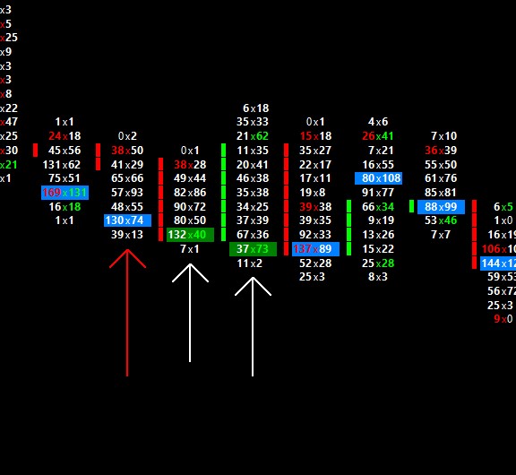

I wrote a formula in the study "color bar based on alert condition" to highlight the poc when it is placed on the second tick of a candle.
but it doesn't work on all candles and I don't understand why
imageCapture d’écran 2025-04-18 090958.jpg / V - Attached On 2025-07-01 13:59:53 UTC - Size: 56.59 KB - 240 views

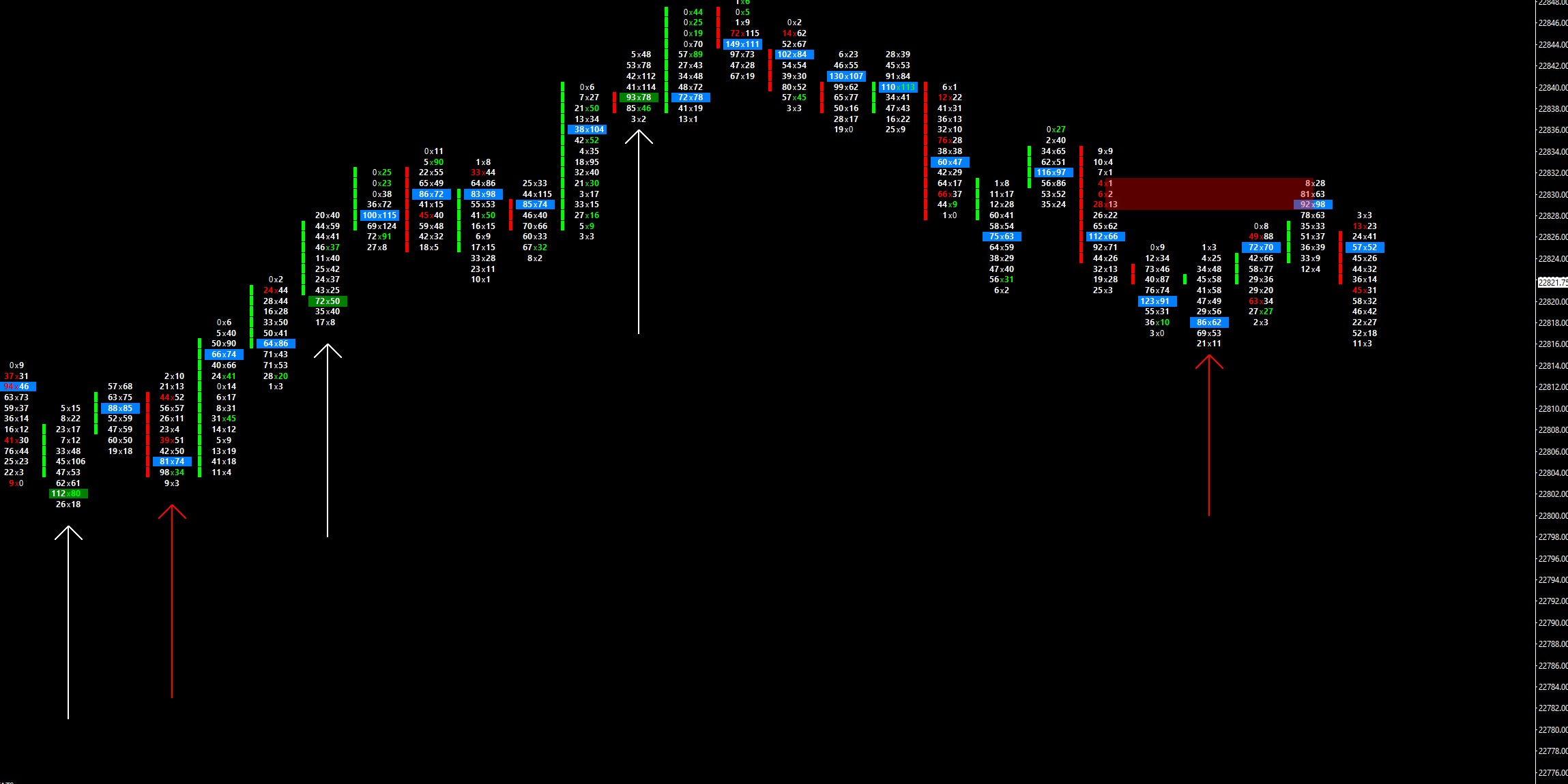

in the image, the poc of the white arrows is good, the formula works, it is green.
the poc on the red arrow remains blue even though it should be green since it is in the same location as the green ones.
I tried the new formula I have the same problem

User220939 - Posts: 65
I just did exactly what you told me, the problem is still there.
Instead of 50000 I put 50 in "numbers bars of calculate"
the blue poc on the red arrows should be green
imageCapture d’écran 2025-04-18 090958.jpg / V - Attached On 2025-07-02 15:36:36 UTC - Size: 247.18 KB - 241 views
