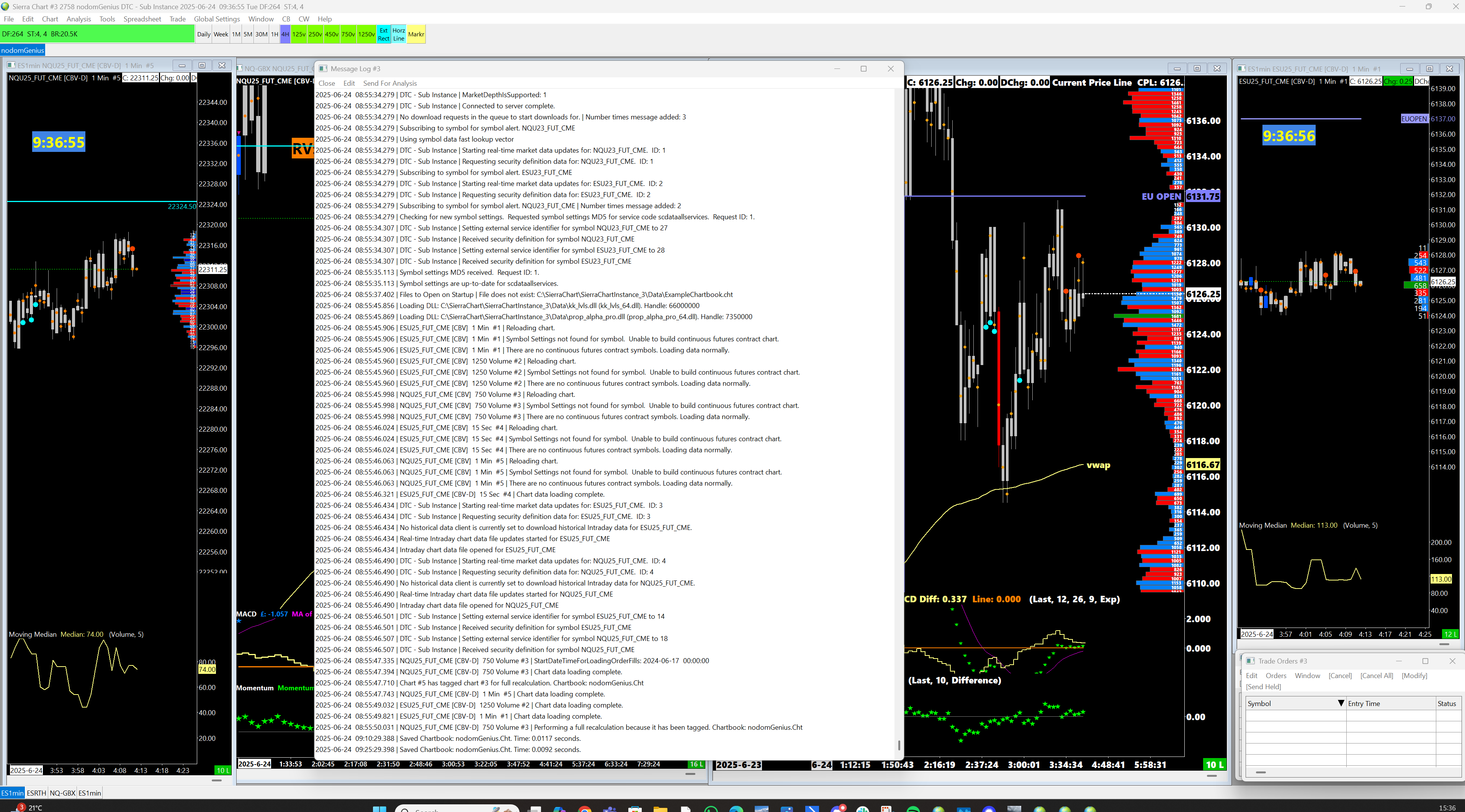

John, here is a new one. I have an instance that has complete frozen. Will not update. I was working earlier and then it just stopped. You can see data is getting in there with the green bar. The other 2 instances work fine. But no chartbook will work in instance 3. I made you a message log.
help....
karen
imagefrozeninstance.png / V - Attached On 2025-06-24 14:40:10 UTC - Size: 659.27 KB - 284 views

If you are able to pull up the Message Log, then the instance is not "locked up", as you can still interact with it. It sounds like the data is not coming in as you expect, is this the case, or is it something else?
What happens if you restart the instance?
Also, what service is the main instance set to? We wonder if you have the correct symbols for the main instance service. The symbols you have in this sub-instance are for Teton. If you are connected to a different service, then select "Edit >> Translate Symbols to Current Service" to get the correct symbols for the service you are using.

In the original image you provided, the symbols were the Teton symbols - such as NQU25_FUT_CME, not the symbols needed if your service was set to "SC Data", which would be NQU25-CME.
Somewhere along the line the symbols got changed, which is why changing them back fixed the issue.
