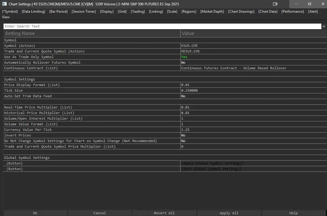

Hello.
i am just trying to do some sim testing. i am using File > new instance. on that instance i just have my doms. I cannot get my positions, orders & fills to show on my charts on the main instance. though i can see pnls etc in the TAL from new instance but I cannot see trades in the TAL from the main instance from yesterday in the new instance. i have gone through other posts re this but cannot figure out what is wrong.
the symbols match. i have sim1 selected in the chart trade window for both DOM and chart. i do not have 'only orders from chart selected' for any dom or chart. i have show order fills and positions selected on the chart. i have tried manually setting the trade account in chart settings to sim1.
Any ideas what i have wrong? thanks
imageMain Instance chart settings-mh.png / V - Attached On 2025-06-18 09:54:15 UTC - Size: 319.26 KB - 298 views
imageMain instance TAL-mh.png / V - Attached On 2025-06-18 09:54:20 UTC - Size: 352.36 KB - 237 views
imageNew instance TAl (doms)-mh.png / V - Attached On 2025-06-18 09:54:25 UTC - Size: 824.65 KB - 291 views
