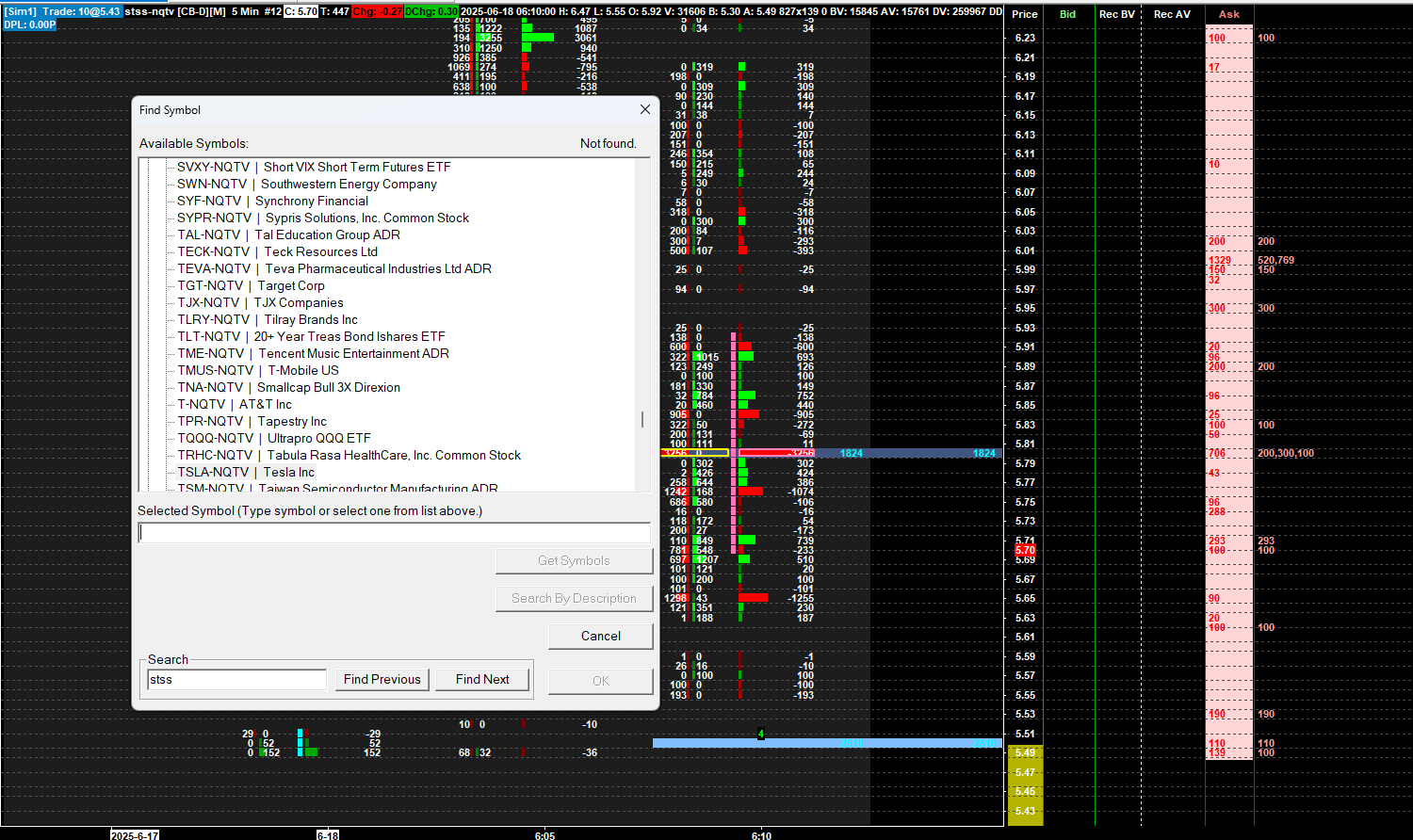

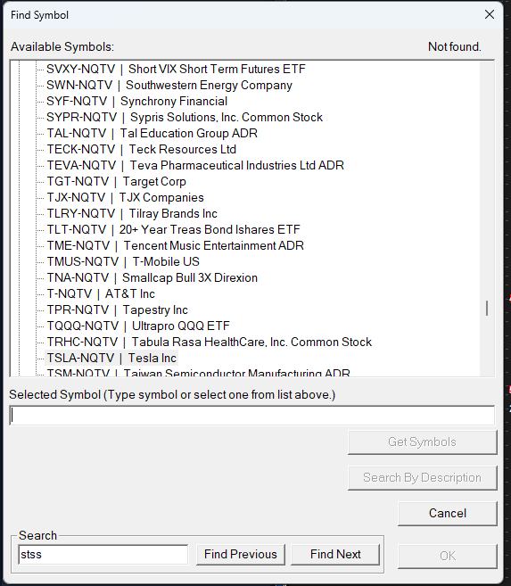

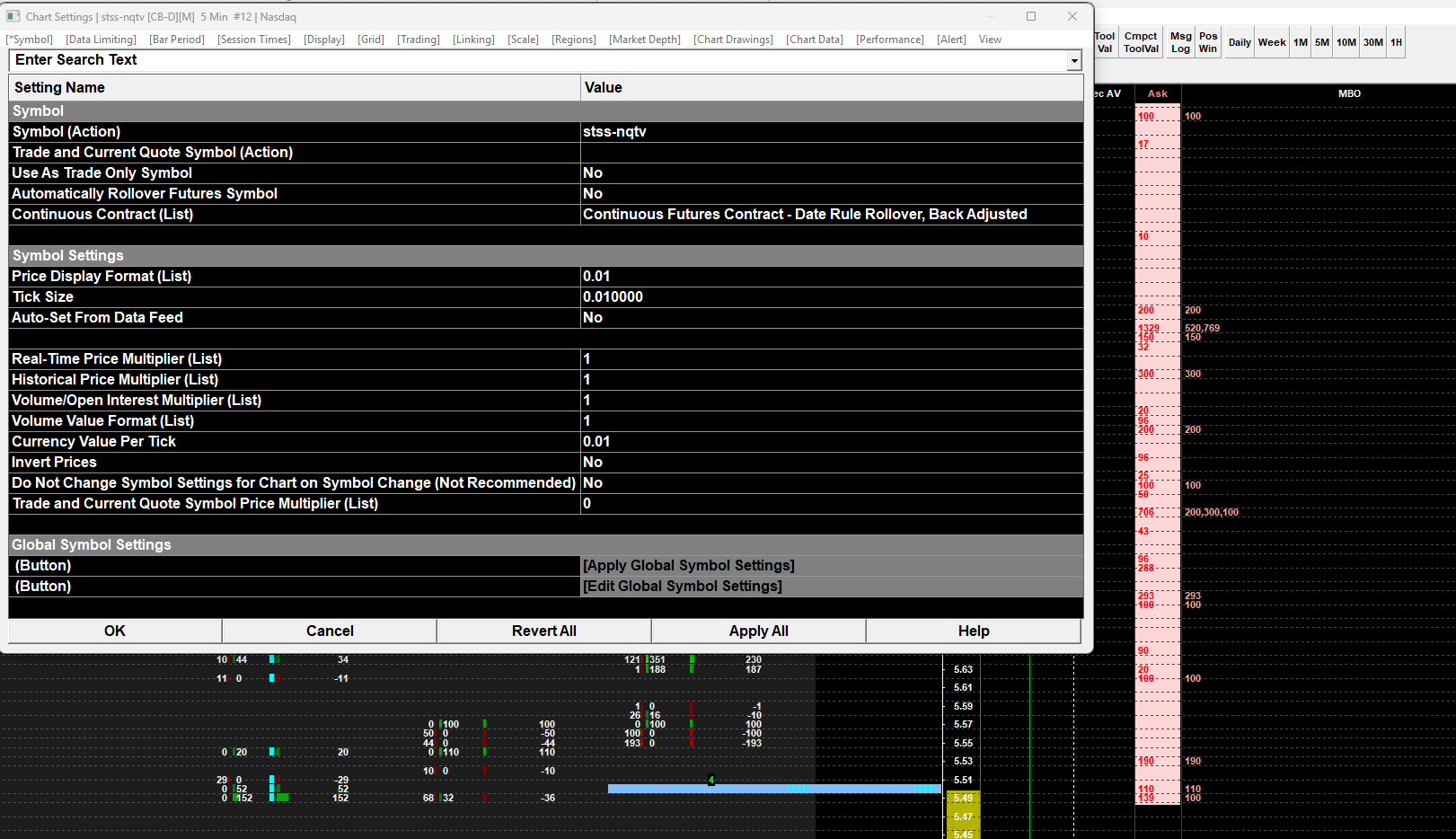

cmack1011 - Posts: 201
Confusing situation: When I search for most nasdaq small cap stocks, I can't find them using the search menu (see pic). However, when I apply the same symbols inside the "Chart - Chart Settings - Symbol" sequence, SC will usually find the stocks. Where this is a problem is when I try to create a watch list, as the platform will not find these stocks (see pics). pls advise. Thx

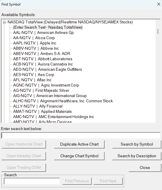

John - SC Support - Posts: 48659
For one thing, you are not using the correct search option. The search where you have entered the information is to search through the symbols that are listed in the Find Symbol window.
In order to search the full list of NASDAQ TotalView stocks, you need to select the item in the Find Symbol list window under the NASDAQ TotalView selection for "Enter Search Text - NASDAQ TotalView". Then a new search box will open at the bottom of the window where you enter either the symbol or description and then select the appropriate button on the right. Refer to the attached image.
Date Time Of Last Edit: 2025-06-19 13:55:27
