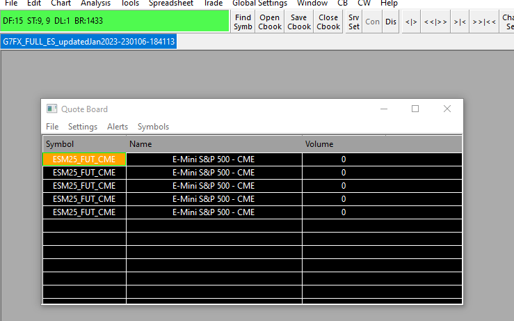

User548772 - Posts: 21
i think I have a problem with my chart. the orders are not loading. I am Live, but it just stays still and does not move on the chart. And my Quoteboard says 0 order (see in the pic). even though they are working days and the Market is open
appreciate your Help.

[2025-06-15 16:54:11]
Sierra_Chart Engineering - Posts: 25432
At this time the market is closed. So you will see zeros for quotes. And not any live updates to charts.
[2025-06-16 07:46:27]
I posted you the Massage on Sunnday, the markets are closed on at this time, I am aware of that. As I mentioned at market opening, there is still nothing loading.
For example last when on Thursday, I opened the Market at 10:30am utc and Nottingham was loading
[2025-06-16 12:41:42]
Close all of the Chartbooks with "File >> Close All Chartbooks".
Open a single chart for the symbol you have an issue with through "File >> Find Symbol". Tell us that symbol of the chart. Tell us about *one* symbol only.
[2025-06-16 15:40:28]
Hello
The symbol I have an issue is : ESM25_FUT_CME / June 2025

[2025-06-16 16:32:53]
John - SC Support - Posts: 48555
Above all else, you are setup to use the Teton Order Routing service, but you do not have any exchanges active. The exchange you did have active in May did not renew on June 1, 2025, since you did not have an active Sierra Chart account at that time.
You can activate the exchange(s) for which you want real-time data for the CME Group at the following link:
https://www.sierrachart.com/UserControlPanel.php?page=DenaliDataFeed#Exchanges
