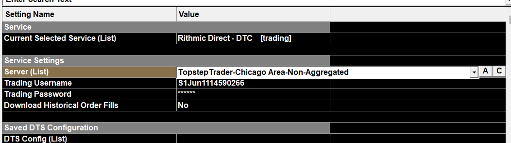

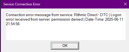

Hello, i recently bought a Trading evalutaion from Topstep, and i cannot connect myself to it...
Ive attached screenshots of the logs, i used the server and login they said to use
Please help.
Thank you

[2025-06-11 20:22:01]
John - SC Support - Posts: 48555
Refer to the following:

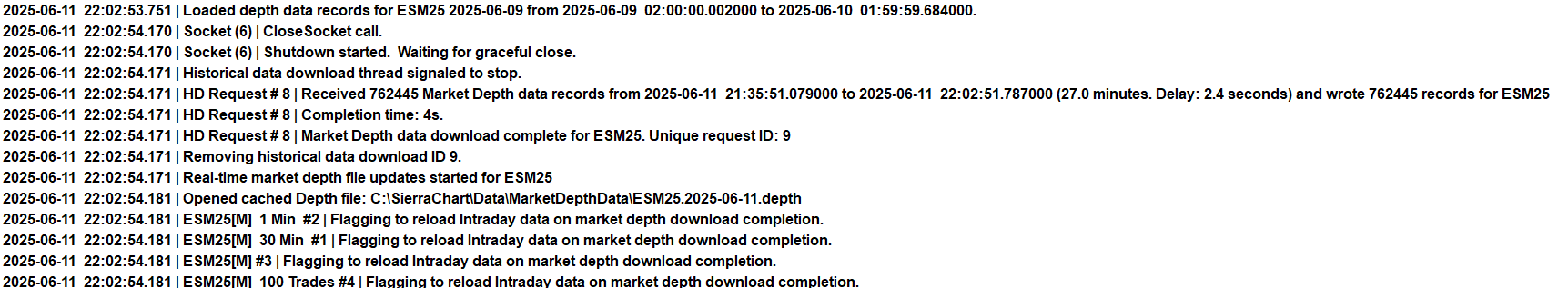

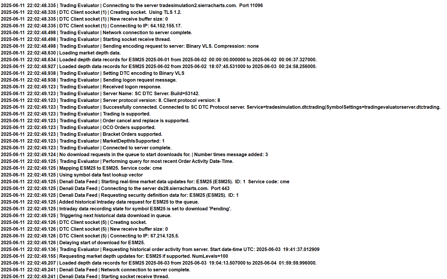

Update: I Logged in to the rhitmic plattform with the Topstep credentials and signed some contracts, and still cannot connect to sierra, with a different Log tho.
image333.png / V - Attached On 2025-06-11 20:23:00 UTC - Size: 150.59 KB - 328 views
image444.png / V - Attached On 2025-06-11 20:23:04 UTC - Size: 159.51 KB - 232 views
image555.png / V - Attached On 2025-06-11 20:23:07 UTC - Size: 56.65 KB - 251 views
[2025-06-11 20:27:25]
The log file in those images shows that you are connecting to the "Trading Evaluator" and not to Rithmic.
If you have a Message Log from connecting to Rithmic, then follow these instructions to post it (do not take images):

[2025-06-11 20:38:35]
The Message Log you posted in post #3 named 333.png has entries that specify that you are connecting to the Trading Evaluator.
Again, get us the Message Log by following these instructions, and not by taking an image:

[2025-06-11 21:18:33]
You are still getting the following error from Rithmic:
Rithmic Direct - DTC | Logon error received from server: permission denied
Rithmic Trading Platform Service: Permission Denied Resolution Procedure
[2025-06-11 22:05:50]
pavel.lysenka - Posts: 50
I did all these Steps and also have that Easy Solution but still wont let me connect, is there anything i can do?
[2025-06-12 15:42:49]
Have you removed the Username and Password from the Market Data and Historical Market Data fields on the "Data/Trade Service Settings" window?
[2025-06-12 18:34:31]
I only see one username and password field, and that is in the screenshoti've sent you. Which one do you mean?
[2025-06-12 20:43:40]
You are on an old version of Sierra Chart and need to update. Follow these instructions to update and then see if that helps with the Permission Denied error:
