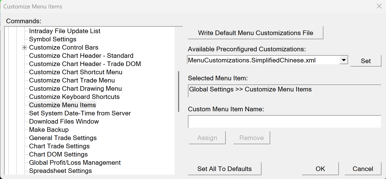

User660904 - Posts: 58

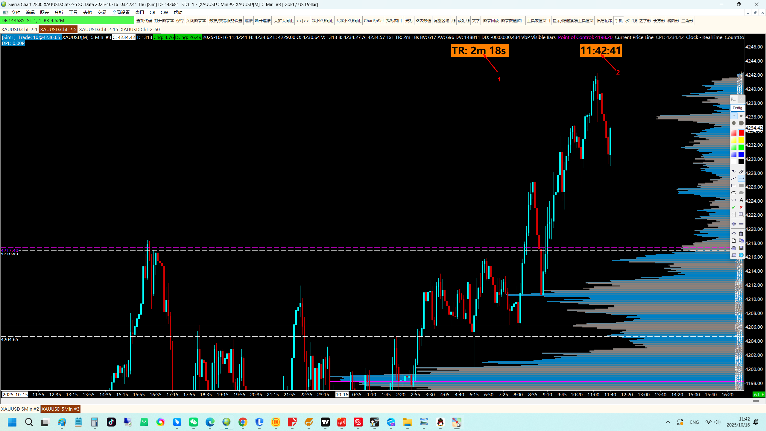

你好,设置了简体中文,重新启动Sierra Chart,怎么界面还不是中文的?

John - SC Support - Posts: 48408
From Google Translate:
Hello—I've set the language to Simplified Chinese and restarted Sierra Chart, but why is the interface still not in Chinese?
Not every menu item has an entry. So the fact that "Customize Menu Items" does not have an entry is just chance.
Also, the items in the left do not display the new wording unless they are clicked on. You would need to select "OK" to save that option and then look at your menus to see what has updated and what has not.

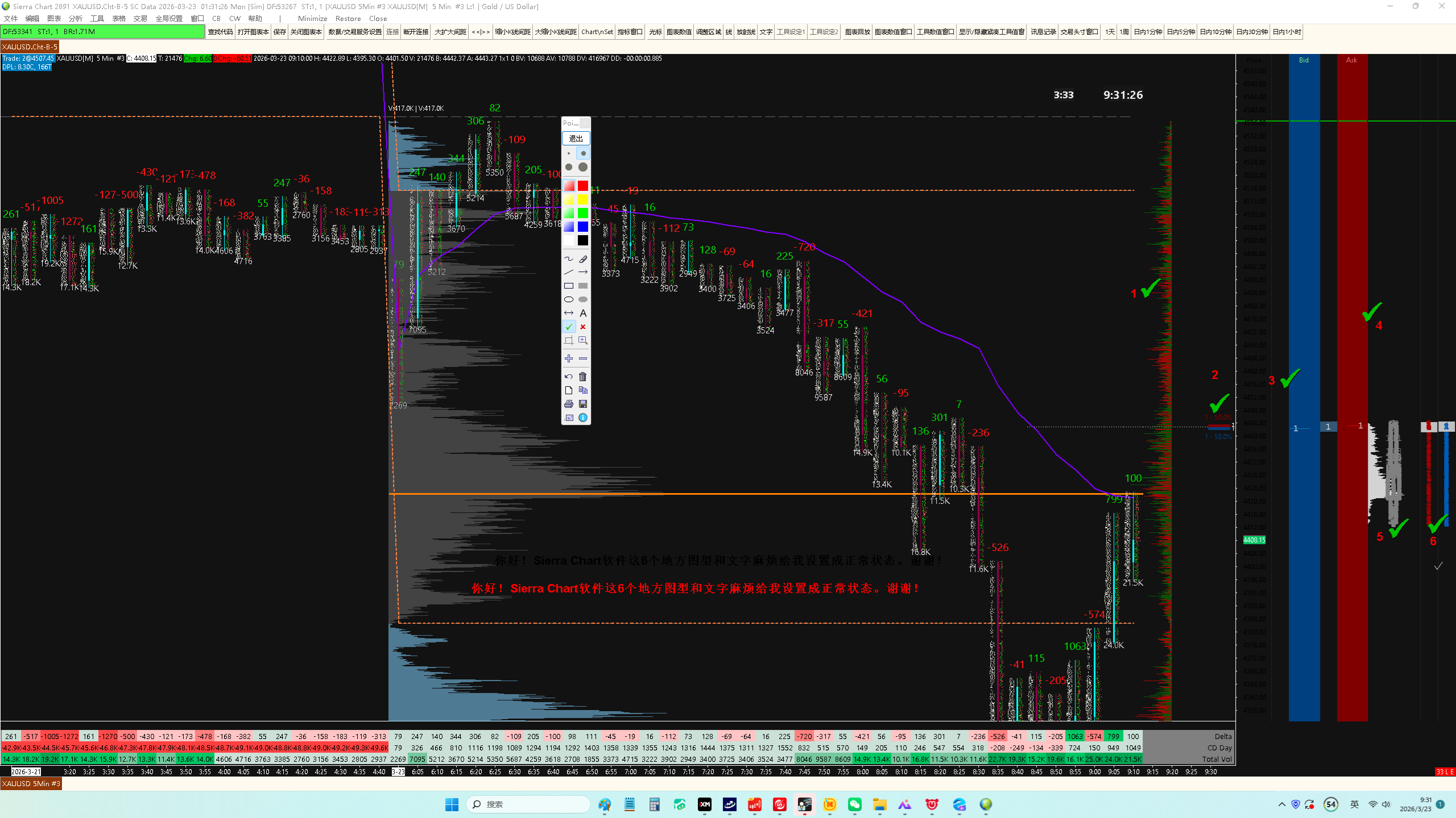

你好!Sierra Chart软件这6个地方图型和文字麻烦给我设置成正常状态。谢谢!
Hello! Could you please set the charts and text in these six specific areas of the Sierra Chart software back to their default/normal state? Thank you!
1. We do not know what you are referencing with item #1. That looks like a Volume by Price profile, and there is no text there.
2. That is the "DOM Graph". The text size in that item is controlled by the "Chart Text". Refer to the following:
Graphics Settings: Chart Text
3. 4. 5. 6. The items in the DOM like this are controlled by the "DOM Quantities/Sizes". Refer to the following:
Graphics Settings: DOM Quantities/Sizes
