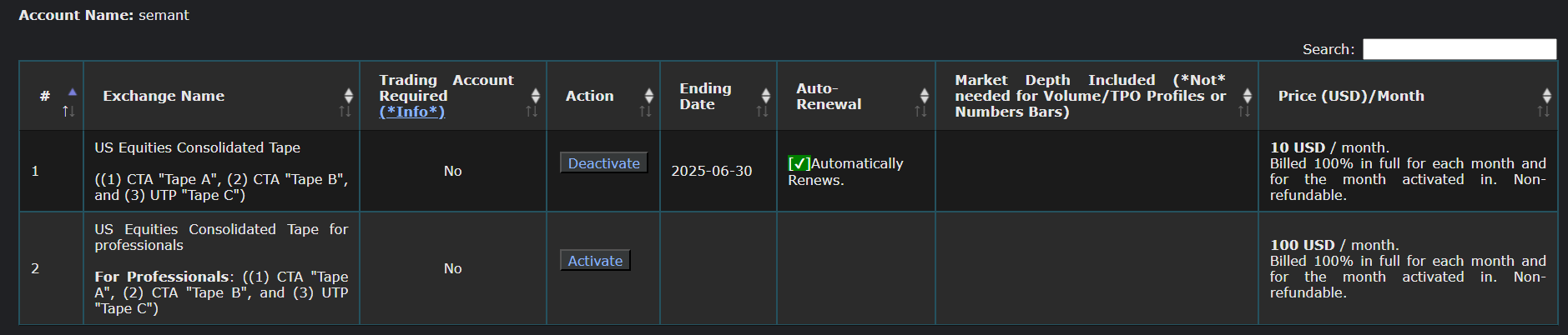

Hello:
My data feed for QQQ is delayed by about 10-15 minutes even though I have "US Equities Consolidated Tape ((1) CTA "Tape A", (2) CTA "Tape B", and (3) UTP "Tape C") Equities Consolidated Tape" service active. What do I need to do to eliminate the delay?
My futures data feed is not delayed.
imageScreenshot 2025-06-05 192508.png / V - Attached On 2025-06-06 00:29:13 UTC - Size: 49.99 KB - 361 views

2025-06-06 14:49:20.269 | Delayed Data Feed | Restarting real-time data updates for symbol: QQQ-NQTV -> QQQ-NQTV
2025-06-06 14:49:20.394 | Delayed Data Feed | Setting external service identifier for symbol QQQ-NQTV to 8363
2025-06-06 14:49:20.394 | Delayed Data Feed | Received security definition for symbol QQQ-NQTV
2025-06-06 14:49:25.640 | HD Request # 9 | Downloading Intraday chart data for QQQ-NQTV to the file QQQ-NQTV.scid. Service: nasdaq_exchange.data
2025-06-06 14:49:25.640 | HD Request # 9 | Download start date-time: 2025-06-06 14:34:09.000000. File last date-time: 2025-06-06 14:34:09.000000
2025-06-06 14:49:25.640 | HD Request # 9 | Using server: ds33.sierracharts.com port 10150
2025-06-06 14:49:25.659 | Socket (3) | Creating socket.
2025-06-06 14:49:25.659 | Socket (3) | New receive buffer size: 0
2025-06-06 14:49:25.659 | Socket (3) | Connecting to IP: 69.39.70.245.
2025-06-06 14:49:25.767 | HD Request # 9 | Setting DTC encoding to Binary VLS
2025-06-06 14:49:25.767 | HD Request # 9 | Sending historical data logon request message.
2025-06-06 14:49:25.871 | HD Request # 9 | Requesting Intraday data. Start date-time: 2025-06-06 14:34:09. Record interval: 1. Symbol: QQQ-NQTV
2025-06-06 14:49:25.920 | HD Request # 9 | Decompressing data.
2025-06-06 14:49:25.969 | HD Request # 9 | Receiving Intraday data for QQQ-NQTV starting at 2025-06-06 14:34:09.293000
2025-06-06 14:49:25.970 | Socket (3) | CloseSocket call.
2025-06-06 14:49:25.970 | Socket (3) | Shutdown started. Waiting for graceful close.
2025-06-06 14:49:25.970 | Historical data download thread signaled to stop.
2025-06-06 14:49:25.970 | HD Request # 9 | Timestamp of first Intraday data file record written: 2025-06-06 14:34:09.293000.
2025-06-06 14:49:25.970 | HD Request # 9 | Received 15 Intraday data records from 2025-06-06 14:34:09.293000 to 2025-06-06 14:34:23.276000 (14.0 seconds. Delay: 15.0 minutes) and wrote 15 records for QQQ-NQTV
2025-06-06 14:49:25.971 | HD Request # 9 | Add time&sales data | Remembered last file record date-time: 2025-06-06 14:34:23.276000
2025-06-06 14:49:25.971 | Added 2 Time and Sales records to Intraday data file for QQQ-NQTV after download.
2025-06-06 14:49:25.971 | HD Request # 9 | Completion time: 0s.
2025-06-06 14:49:25.971 | HD Request # 9 | Intraday data download complete for QQQ-NQTV. Unique request ID: 9
2025-06-06 14:49:25.971 | Removing historical data download ID 9.
2025-06-06 14:49:25.971 | Real-time Intraday chart data file updates started for QQQ-NQTV
2025-06-06 14:49:25.972 | Opened cached Intraday file: C:\SierraChart\Data\QQQ-NQTV.scid. Thread ID: 840
2025-06-06 14:49:25.972 | Intraday chart data file opened for QQQ-NQTV
2025-06-06 14:49:25.972 | HD Request # 9 | Enabling Intraday chart updating for symbol.
2025-06-06 14:49:25.972 | No download requests in the queue to start downloads for.
2025-06-06 14:49:26.023 | Socket (3) | Socket gracefully closed by remote side.
2025-06-06 14:49:26.023 | Socket (3) | Closed.
2025-06-06 14:49:58.045 | The message log has been sent to support. *
2025-06-06 14:49:58.046 | HTTPS connection ID:1 to www.sierrachart.com:443 for request ID:1 (3) | Creating socket. Using TLS 1.2.
2025-06-06 14:49:58.046 | HTTPS connection ID:1 to www.sierrachart.com:443 for request ID:1 (3) | New receive buffer size: 0
2025-06-06 14:49:58.046 | HTTPS connection ID:1 to www.sierrachart.com:443 for request ID:1 (3) | Connecting to IP: 64.152.155.19.
2025-06-06 14:49:58.251 | The Message Log was sent. Result: Message Log received. *
2025-06-06 14:49:58.496 | HTTPS connection ID:1 to www.sierrachart.com:443 for request ID:1 (3) | CloseSocket call.
2025-06-06 14:49:58.496 | HTTPS connection ID:1 to www.sierrachart.com:443 for request ID:1 (3) | Shutdown started. Waiting for graceful close.
2025-06-06 14:49:58.529 | HTTPS connection ID:1 to www.sierrachart.com:443 for request ID:1 (3) | Socket gracefully closed by remote side.
2025-06-06 14:49:58.529 | HTTPS connection ID:1 to www.sierrachart.com:443 for request ID:1 (3) | Closed.
Date Time Of Last Edit: 2025-06-06 15:00:02
[2025-06-06 15:36:26]
John - SC Support - Posts: 48555
You have the U.S. Equities Consolidated Tape exchange active, but you are using the symbol "QQQ-NQTV". When you use the suffix of -NQTV, this is specifying that you want the data from our NASDAQ TotalView exchange and not from the U.S. Equities Consolidated Tape.
To get the data from our U.S. Equities Consolidated Tape exchange, you need to use the standard ticker symbol, so in this case you need to use "QQQ".
