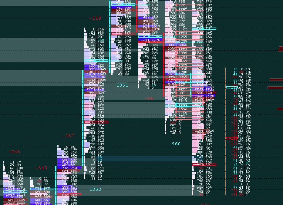

Good morning,

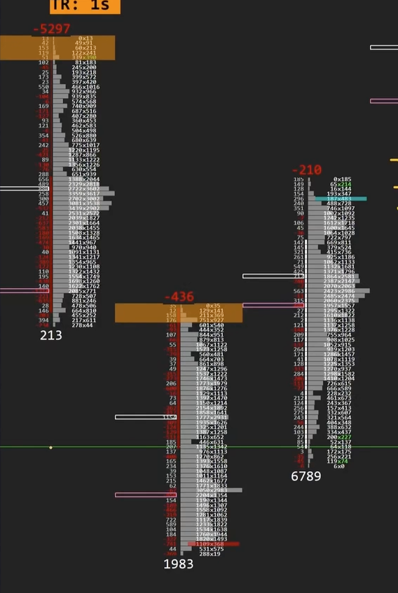

I would like to move the delta data to the left (see the attached photo with the gray background) and then shift the numbers a bit more to the right (see the photo with the green background, which is my footprint).
Date Time Of Last Edit: 2025-05-31 13:38:47
imageScreenshot 2025-05-31 alle 11.58.19.png / V - Attached On 2025-05-31 13:38:30 UTC - Size: 87.21 KB - 363 views
imageScreenshot 2025-05-31 alle 15.35.35.png / V - Attached On 2025-05-31 13:38:42 UTC - Size: 293.45 KB - 414 views
[2025-06-02 13:45:47]
The order of the data in the Numbers Bars study it determined by the Column number. So if you want the Delta to be the leftmost column, then be sure to set the number display for Column 1 to be the Delta you want. Arrange the rest of the columns as you want them.
With regards to shifting the location of the numbers, the only option for this is the Input for "Single Value Text Alignment". Refer to the following:
Numbers Bars: Single Value Text Alignment
