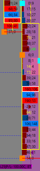

I am experiencing situations, where the alert condition for
the trading system is triggered with quite a bit of delay, resulting in bad entries.
Is the frequency with which the conditions are checked adjustable?
What could be the issue here?
thanks in advance
Date Time Of Last Edit: 2025-05-22 12:22:46
imageUnbenannt.PNG / V - Attached On 2025-05-22 12:19:54 UTC - Size: 11.36 KB - 301 views

thanks for the quick reply. Yes, I'm actually quite certain, because I have it structured so that I get a
"color background" study, which really does the checking and the trading just ask for "color backgound".sg1=1
So I see the bar color changing, but it takes quite a bit (I would estimate 0.5-1s) till the "dot at the top/bottom" that
I use as a marker of the trading system appears.
It could be an issue with rithmic though, if this would be correlated,
i.e. the trading system would only be shown as active if it successfully routed an order. I can not gauge wether this is the case, though.
