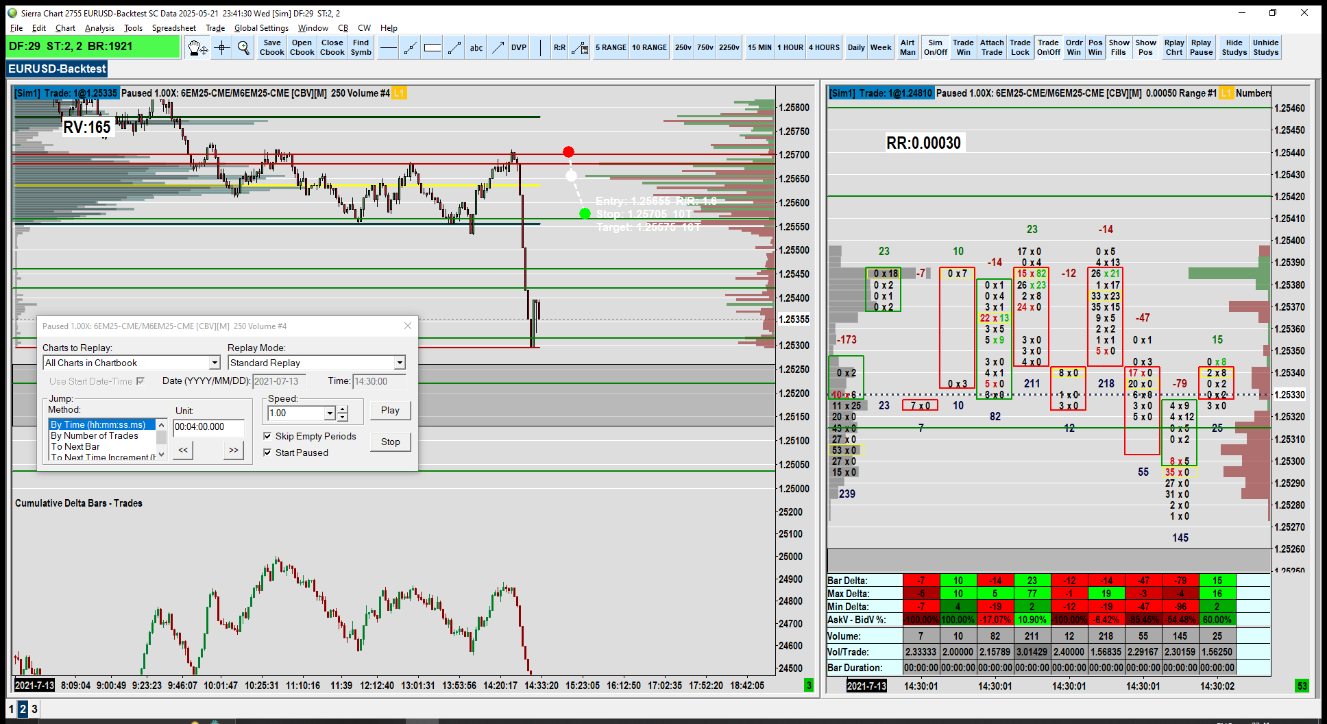

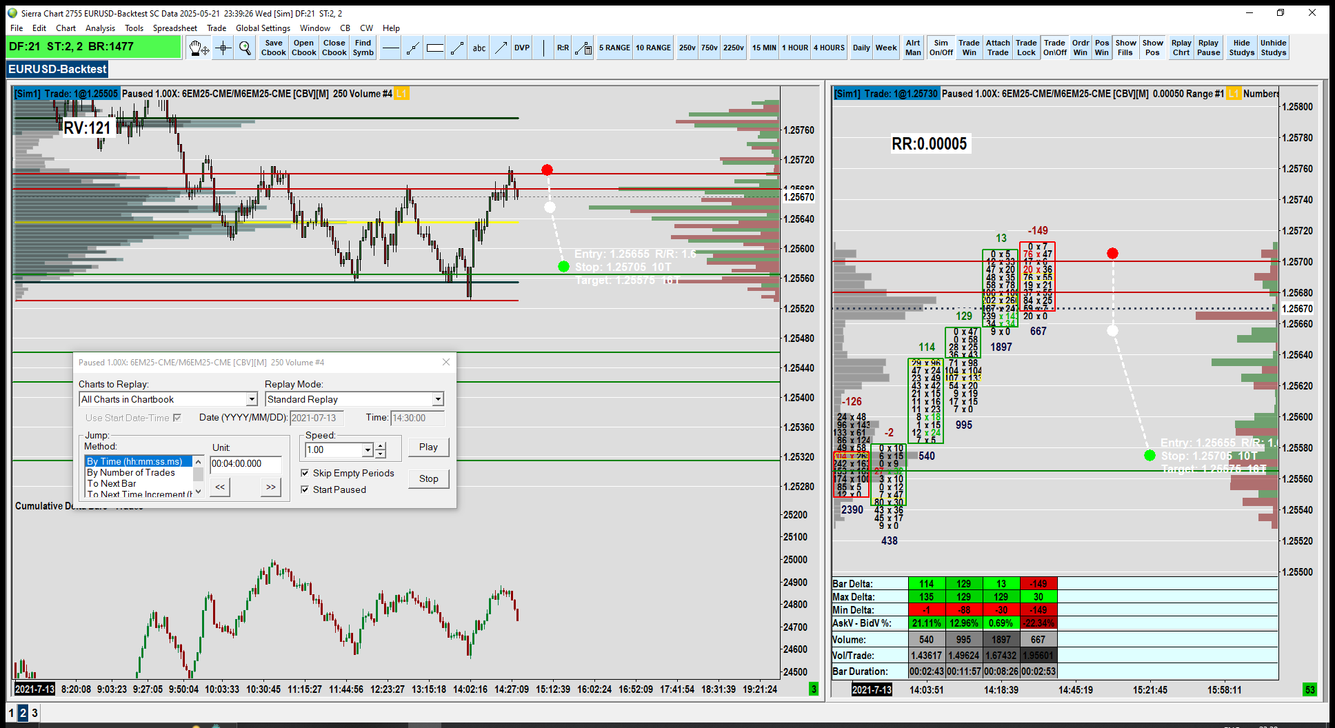

Hello, I was doing a manual backtest from 2021-07-06 (and logging it elsewhere) trading normally on SIM on symbol 6EM25-CME (I'm using Service Package 5, seemed to be able to display 2021 and before fine until now), up until 2021-07-13, 14:30 PM in replay, with no problems, for many days, when all of a sudden at that point in time the bars on chart start rapidly speeding up, getting totally out of line (probably jumping too far in the future, etc).
On 1X speed, or whatever speed you choose, they are still rapidly speeding up. So that speed is definitely not 1X or similar anymore, but some fixed, very high speed. Also range number bar chart starts interestingly, showing 00:00 bar durations only.
I set up two screenshots to show the difference until which point everything is fine (every time I replay back at that time, 14:30, everything is still the same as I was familiar with, after that point everything gets unfamiliar to the previous chart context, levels, etc.)

Point in time when everything is fine for the last time: https://www.sierrachart.com/image.php?Image=1747863568977.png
Point in time after everything is not fine anymore: https://www.sierrachart.com/image.php?Image=1747863692428.png

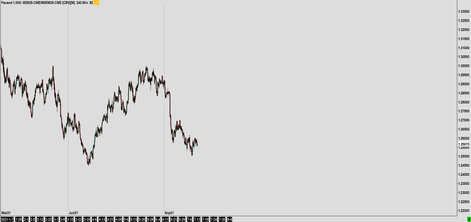

Here, I have a screenshot of the chart and rollover lines, right before the time the glitch always starts: https://www.sierrachart.com/image.php?Image=1747888507471.png

Also, another thing I forgot to mention is that the replay mode speed returned to being controllable again, and candles started exhibiting normal behavior again from later on that day (a few hrs later).
So, my main question now, for example, is, can I still continue my backtest on 7-14 again as usual, as if nothing happened, and ignore that episode? As all of the fixes I tried failed.
