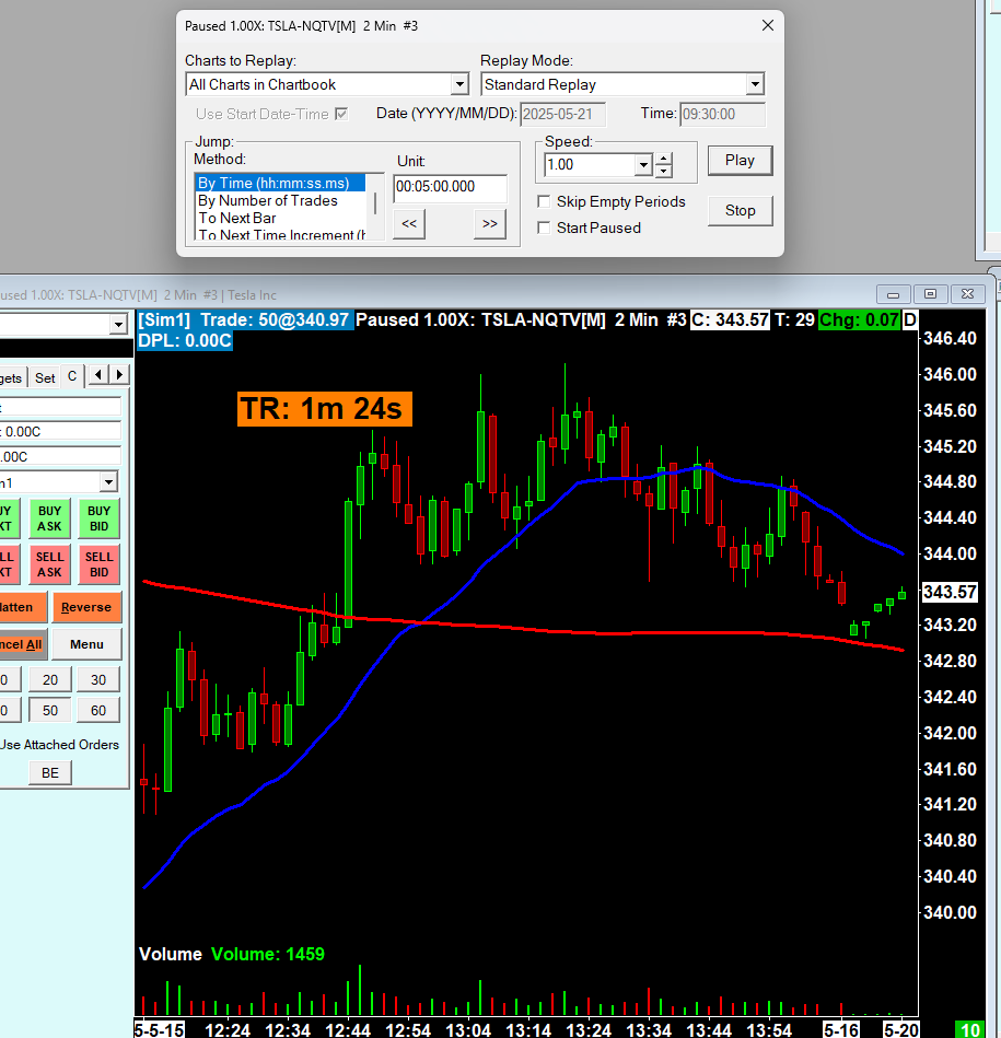

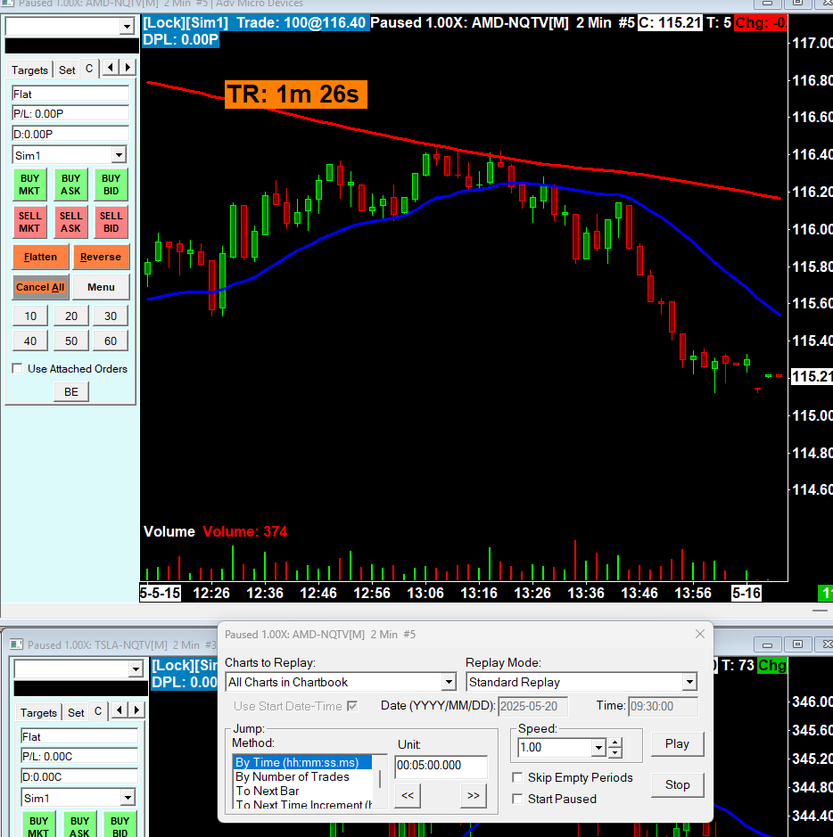

[2025-05-22 04:58:43]
User764210 - Posts: 14
find attached picture of the replay nothing happens when the replay is on
imagereplay.png / V - Attached On 2025-05-22 04:55:05 UTC - Size: 85.29 KB - 325 views
[2025-05-22 13:59:33]
In that image the replay is "Paused". This is noted at the top of the chart.
Also, the option for "Skip Empty Periods" is not enabled (which is should not be when replaying multiple charts), but this means that if there is a break in the data, the replay is still going to play as normal during that time, which would cause the chart you are viewing to look as though nothing was occurring, as there are no new bars to present.
You need to look at that individual chart and see if there is no data from the time where the replay stops, and if so, then what you are seeing is normal. You would need to either increase the replay speed to get over that time, use the Jump option, or enable the option for "Skip Empty Periods" (just be aware that doing this when replaying multiple charts will cause you to lose synchronization).

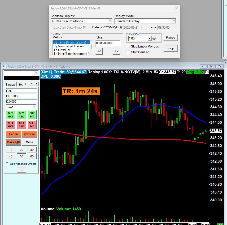

[2025-05-22 14:34:49]
Hi John the replay for stocks worked until the 19 of may without problem then it stopped see attachments of not paused and paused of tesla
imagepaused.png / V - Attached On 2025-05-22 14:33:42 UTC - Size: 85.97 KB - 247 views
imagereplay1.png / V - Attached On 2025-05-22 14:33:58 UTC - Size: 85.09 KB - 289 views

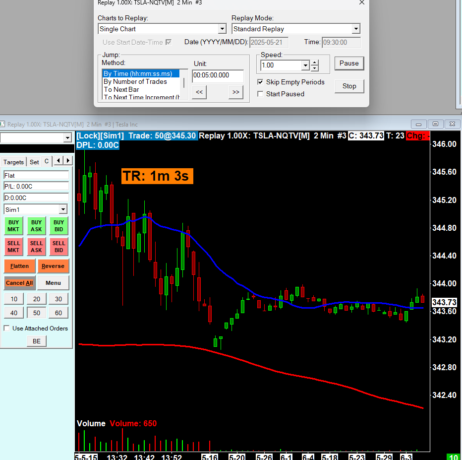

[2025-05-22 15:52:18]
Please do the following:
- Stop that replay.
- Set the "Charts to Replay" to "Single Chart"
- Enable the option for "Skip Empty Periods".
Then replay that chart and tell us if it works properly or not.
[2025-05-23 08:17:55]
Hi now its moving but it dont create 2 min bars it dont move like it should see picture with kinds regards
imagetesla replay new.png / V - Attached On 2025-05-23 08:17:29 UTC - Size: 81.23 KB - 345 views
[2025-05-23 13:48:14]
You have bad data from when we had a problem last Friday. Stop any replays and then follow the instructions at the following link to redownload the data from just before May 15, 2025:
Data Errors or Spikes in Charts, Flat or Flat Line Graph, Compressed Graph, Errors with Date/Time Values: 2.1.2 Deleting and Re-downloading Data. (Easier and Recommended Method)
[2025-05-23 14:33:08]
It worked thanks
