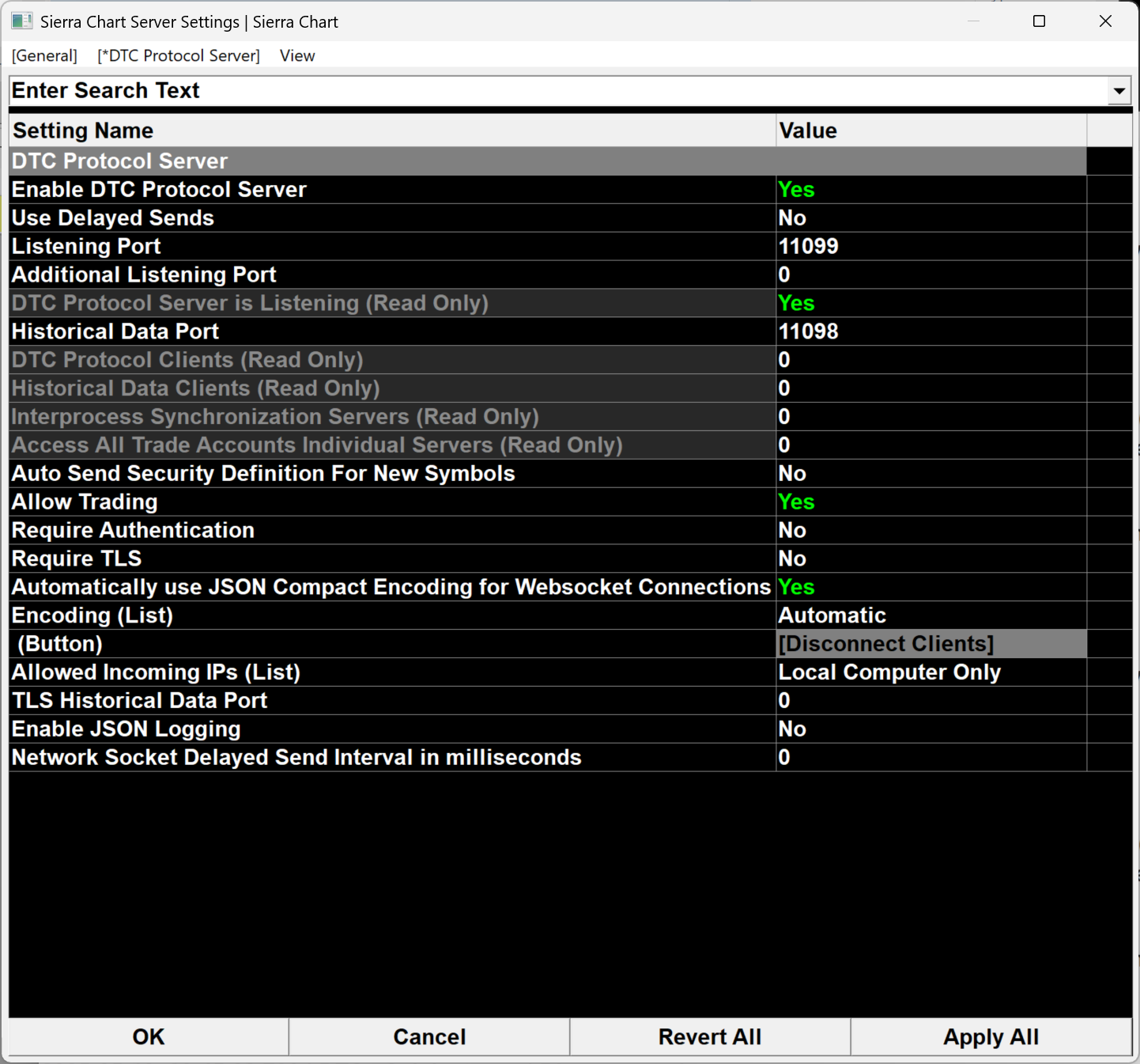

[2025-05-19 20:35:20]
Select "Global Settings >> Sierra Chart Server Settings" and then there is a separate tab in there for "DTC Protocol Server".
We think this is what you are looking for. If it is something else, then please give us additional information.
We are curious why you were expecting to find this directly under the "Global Settings" window. If there is something in our documentation that is not correct, please let us know where it is so we can correct it.

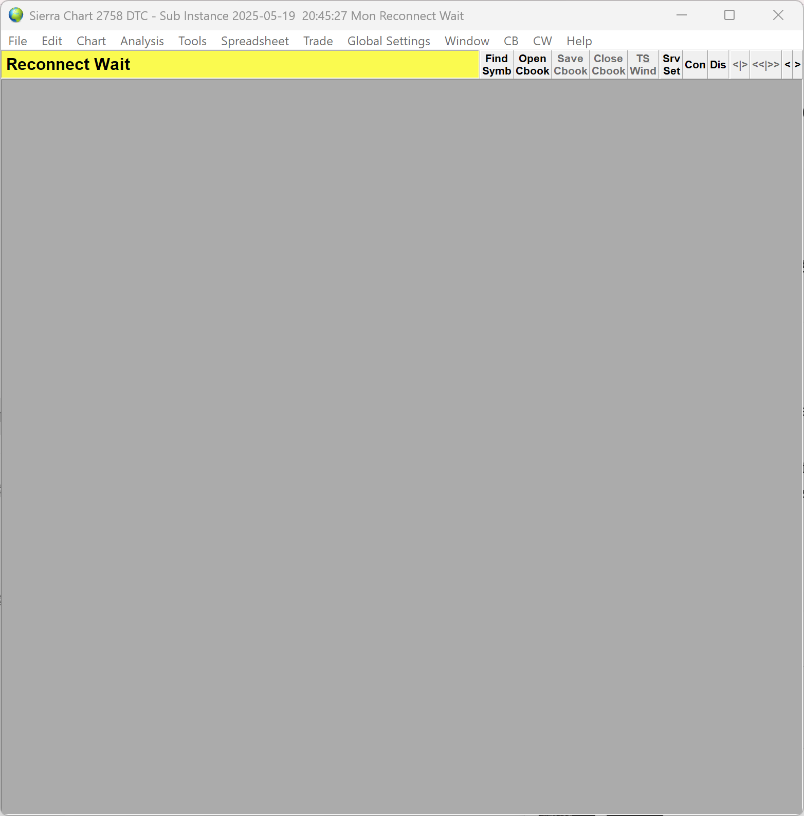

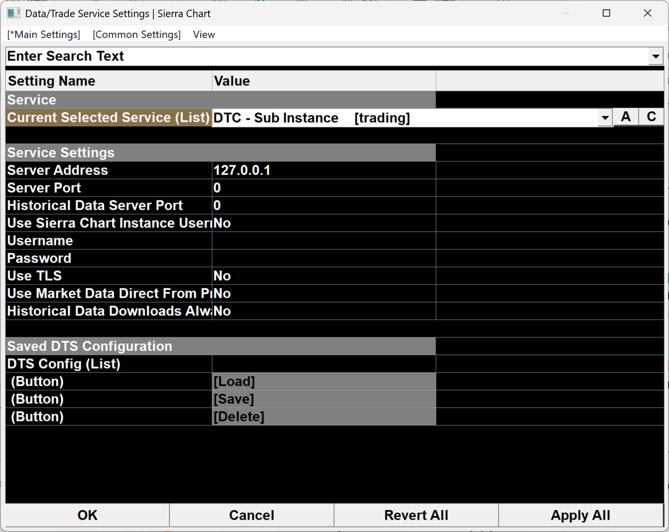

[2025-05-19 21:17:57]
User997755 - Posts: 10
I have enabled the DTC Protocol Server and configured everything according to the documentation, but I am still stuck in “Reconnect Wait” status.
Here is my setup:
The DTC Protocol Server is enabled (Yes)
Listening Port: 11099, Historical Data Port: 11098
Allowed Incoming IPs: Local Computer Only
Sub instance is set to connect to 127.0.0.1 : 11099
“Allow Trading” is set to Yes
I launched SierraChart_64.exe directly — not from the sub instance
I have attached screenshots of:
Data/Trade Service Settings
DTC Protocol Server Settings
Reconnect Wait screen
Can you please advise what might be wrong? Why is it not connecting? What should I do next?
Thanks.

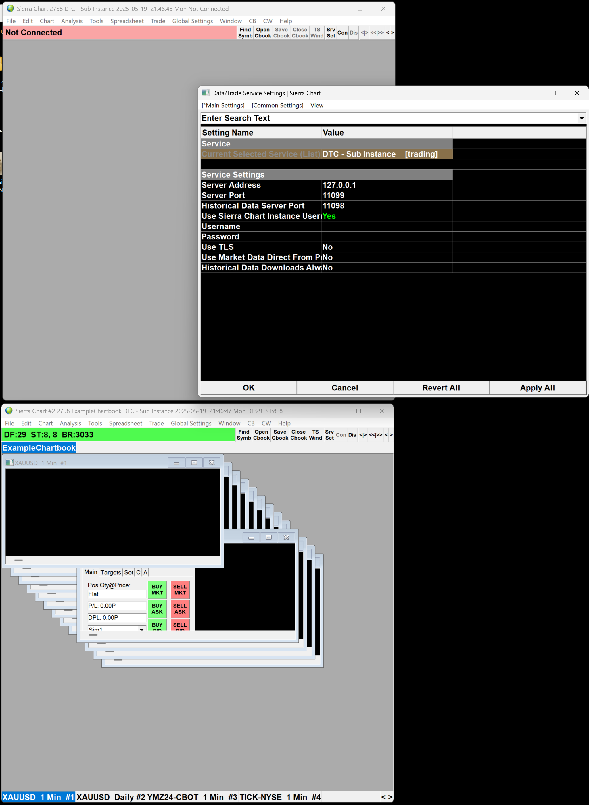

[2025-05-19 21:51:12]
So far, I've finished it up to this state.
image20250519_144700.png / V - Attached On 2025-05-19 21:50:35 UTC - Size: 410.7 KB - 319 views
[2025-05-19 22:32:33]
Yes we were going to say you do need to set the Server Port number to 11099:
https://www.sierrachart.com/Download.php?Folder=SupportBoard&download=120875
In the last screenshot we see you have done this.
Set Automatically Use JSON Compacting coding to No in the Server Settings. Although thinking about it, that should not matter.
