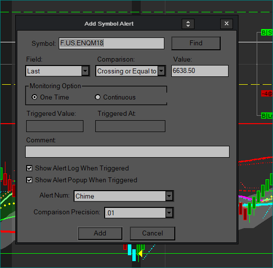

There are 2 ways that I know of that you can do this.
#1 You can set an alert using the Add Symbol Alert menu item and that will allow you to specify an alert that you'll manage via the Window/Alert Manager/Symbol Alert tab.
Alerts Manager: Symbol Alerts
#2 My preferred way is to configure a Horizontal Line Alert, follow the link to see how to set alerts to Chart Drawings.
Chart Drawing Tools: Chart Drawing Alerts
