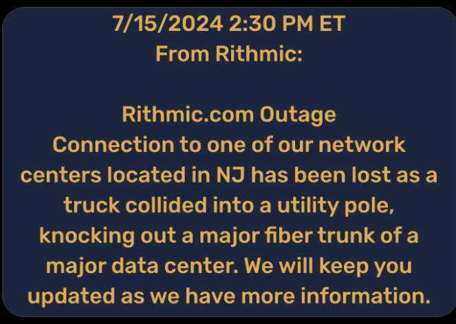

[2024-07-16 16:32:29]
See the attachment from Rithmic about the issue.
Whether this is the cause of connectivity issues, for users in Nevada or California we do not know. Would seem unlikely.
