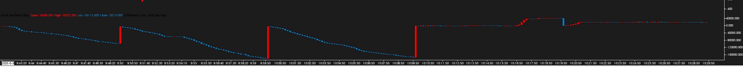

GPM2000 - Posts: 22
Here is a screenshot of the bid/ask depth bars from today. The depth difference is -160,000 at times. This is Denali data.
Please could you let me know how to resolve.
Thanks!
