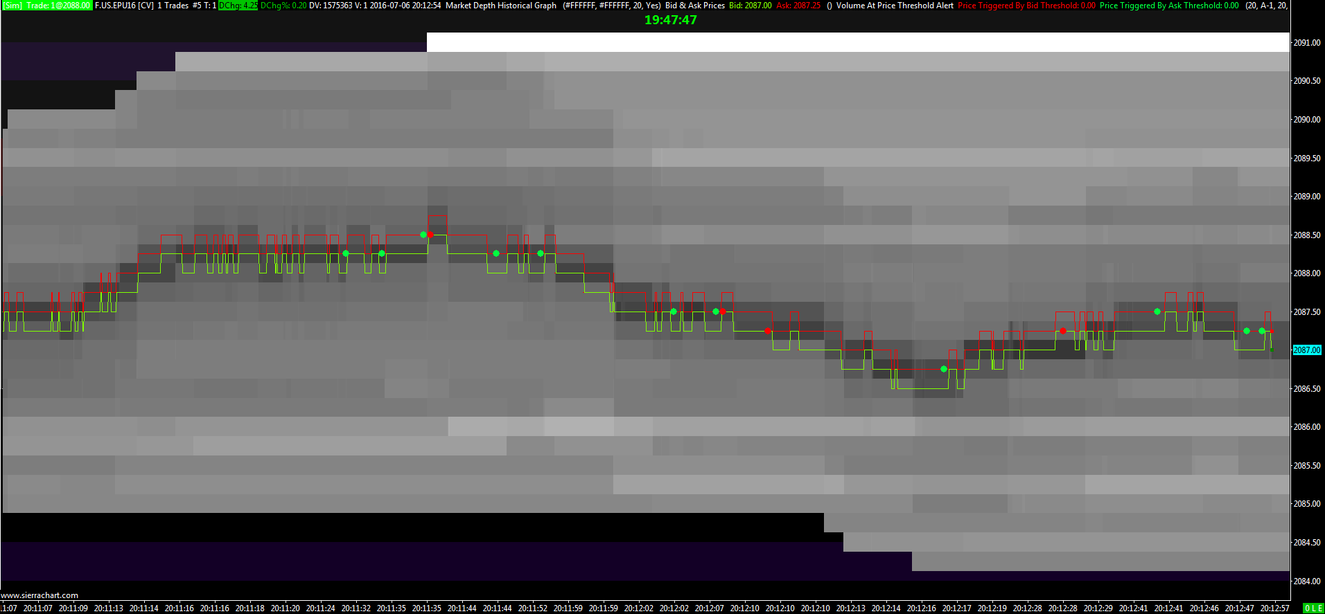

Hello, great idea, some comments
1. can you make a setting where you do not allow Market Depth Historical Graph extend into "Lock fill space" Right now it draws over market volume.
2. can you make an option where it draws under other drawings? Right now it draws on top of drawings like extending rectangle, rectangle, elipse. It would be great if this functionality would be base background.
3. can you add this functionality to be drawn into Trading DOM window?
Thank you for your hard work SC team

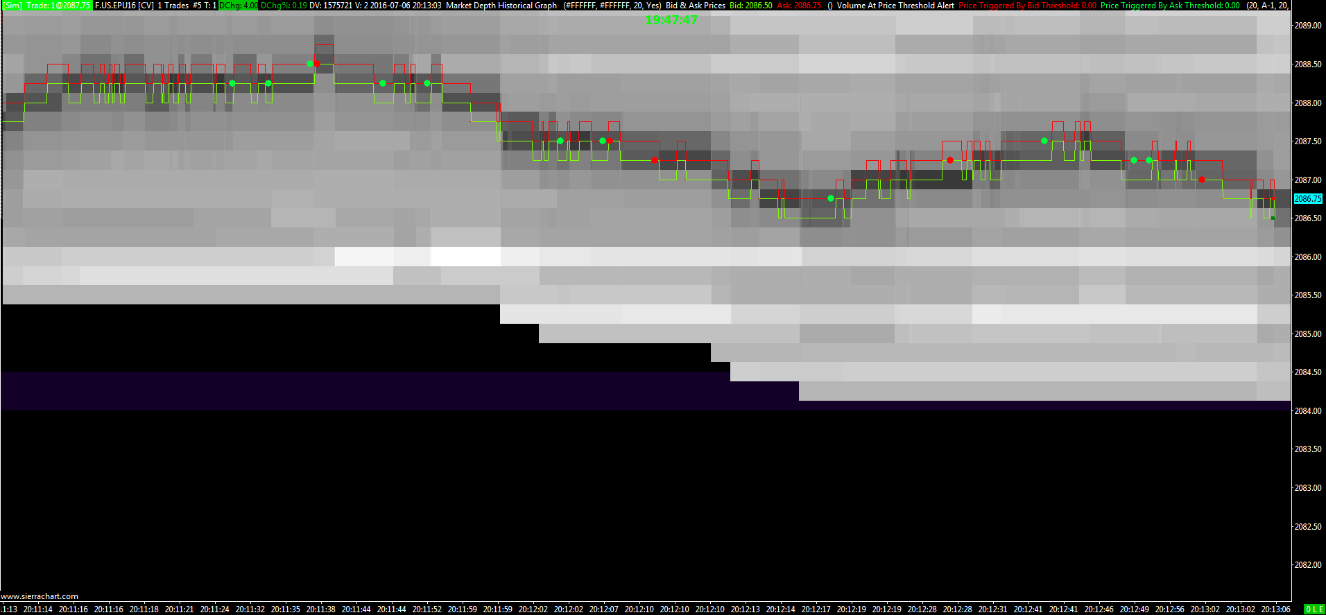

EDIT #2
I also noticed that coloring is based on what is visible.
Picture #1, where level 2091 is visible, colors this level as strongest. Second picture where I moved graph lower, and 2091 is not visible, changes coloring. This variability can cause confusion or wrong decision. Can you anchor the coloring to biggest price level at that time regardless whether it is visible on chart or is not? (I do not mean there is no data for that level, it is just that graph is moved the way this level is not visible)
Date Time Of Last Edit: 2016-07-06 18:32:29
imageMessy.png / V - Attached On 2016-07-06 17:44:29 UTC - Size: 76.96 KB - 1458 views
image2091 visible.png / V - Attached On 2016-07-06 18:31:09 UTC - Size: 99.35 KB - 1492 views
