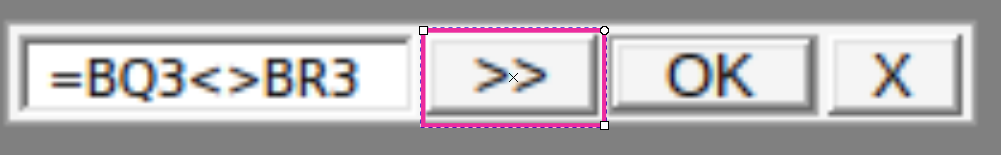

| [2022-03-22 19:03:47] |
| User35525 - Posts: 194 |
Everyone, I've installed Sierra Chart 2368 on a new computer with Wine 7.4-staging, and am now having trouble editing cells within spreadsheets. Clicking ">>" no longer expands the edit window (was working initially but now works maybe one out of 100 tries). Has anyone seen this? Please see the screenshot. Edit: was able to fix this by emulating a virtual desktop within wine's graphics configuration. Then I was seeing odd behavior with the tool values window and I had to change global settings in Sierra Chart to make it not keep disappearing. But this is resolved and it's back to normal. Date Time Of Last Edit: 2022-03-22 20:37:09
