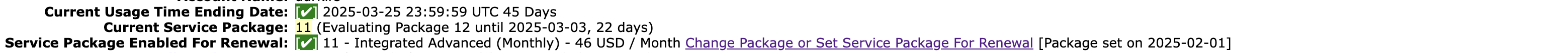

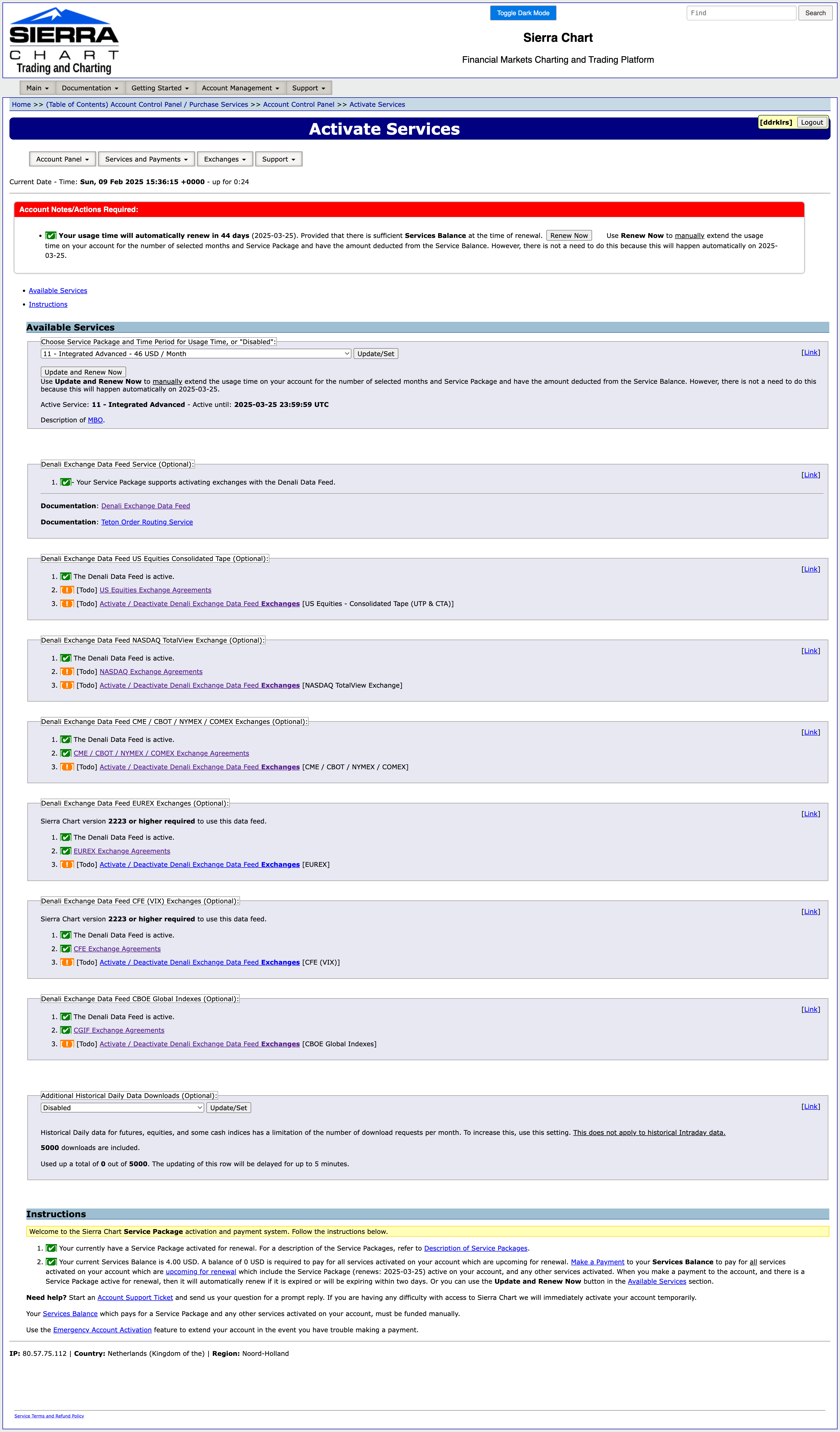

User765799 - Posts: 3
I just wanted to chip in but I'm a new user to SC so maybe I'm missing something obvious but for the the numbers bars studies also doesn't load.
context;
- M3 mac
- Parallels (windows 11).
- SC 2736
- data package 11
- data service settings (SV)
Based on my understand, this should give me the option to use the numbers bars studies on various derivates, including FX. I'm connected I'm adding some screenshots, if this is not relevant to the topic I'll remove my comment and create a separate thread. When I try to add the numbers bars study it goes blank and simply doesn't show anything.
Date Time Of Last Edit: 2025-02-09 16:58:05
image06.png / V - Attached On 2025-02-09 16:55:42 UTC - Size: 1.44 MB - 588 views
image07.png / V - Attached On 2025-02-09 16:55:48 UTC - Size: 74.01 KB - 516 views
[2025-02-10 01:01:17]
Sierra_Chart Engineering - Posts: 25095
You will want to run the ARM 64 version of Sierra Chart from the Sierra Chart installation folder:
SierraChart_ARM64.exe
First exit from the current instance of Sierra Chart you are running. Then run the above executable from the Sierra Chart installation folder.
Date Time Of Last Edit: 2025-02-10 01:01:35

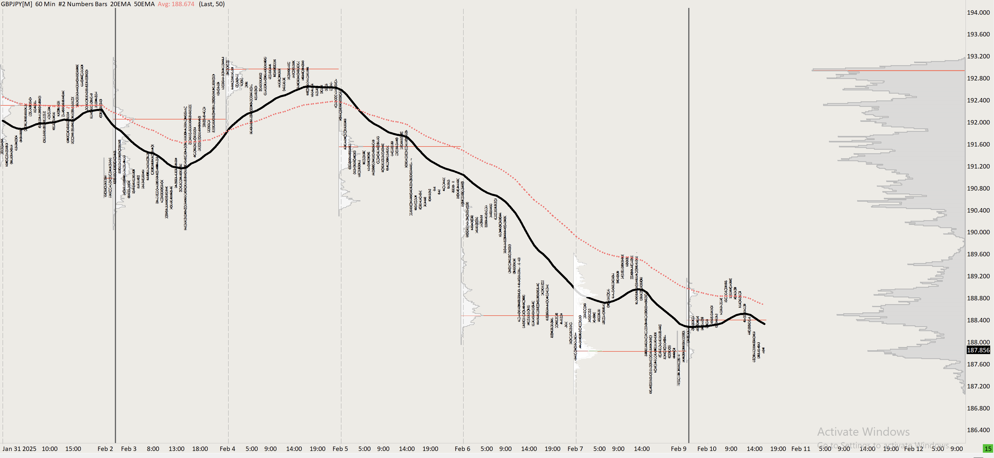

I just wanted to give an update, it seems that the numbers bars study is now loading on my chart (before it was blank).
Specs before:
- M3 mac
- SC 2736
- data package 11
Specs after:
- M3 mac
- SC 2739
- data package 11
-> application opened via ARM64
PS: I'm very new to SC so I think I just need to customise my numbers bars to make it readable. It loads, that's what I know, and it didn't load before.
imageScreenshot 2025-02-10 at 17.05.52.png / V - Attached On 2025-02-10 16:07:37 UTC - Size: 384.16 KB - 569 views
