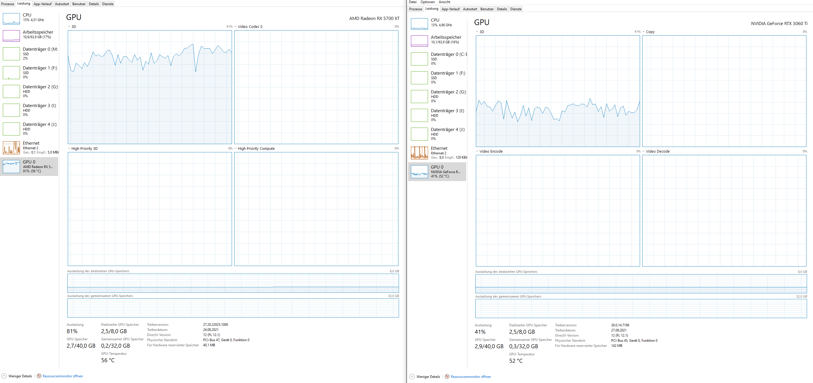

RIFT - Posts: 124
I bought an Nvidia GPU, I don't have any flickering with it...
imageAMD_vs_NVIDIA.png / V - Attached On 2021-09-20 16:17:50 UTC - Size: 173.23 KB - 720 views
[2021-09-21 07:51:57]
Kiwi - Posts: 375
My Nvidias have been free of flickering too.
But I found back when this was first possible that the odd drawing of diagonal trend lines put me off. I also didn't see much reduction in CPU load. So I dropped opengl.
But I thought I'd try again with my current desktop (dwm on top of a mate / debian stack) and 1) the distortion of the trendlines is lower (acceptable) and I get a substantial reduction in CPU load whether running changes with 2.5 second refresh or 200ms refresh.
So I'll stick with it for while.

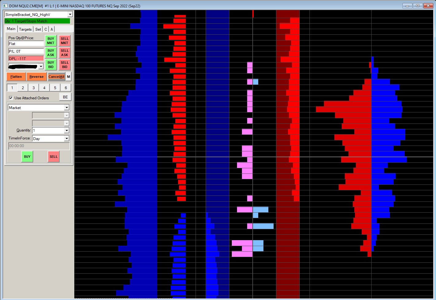

virtualcointrading - Posts: 48
I have just acquired an nVidia RTX 3x series card, with OpenGL enabled SC is globally much faster however text no longer show in the DOM.
[2022-07-13 13:18:03]
Provide us that trading DOM by following these instructions and we will test:
In order for us to accurately reproduce this can you also use the chart specific color settings, for the text colors. Refer to:
Graphics Settings: Using Different Color and Graphics Settings for Specific Charts
[2022-07-13 17:54:52]
Hello Sierra Chart Engineering,
Chartbook attached.
Regards,
Previously from user:
Date Time Of Last Edit: 2022-07-20 07:00:39
attachmentOpenGL_issue_DOM_for_SC_support.Cht - Attached On 2022-07-13 17:51:13 UTC - Size: 4.32 KB - 701 views
image2022-07-13 195331.jpg / V - Attached On 2022-07-13 17:54:10 UTC - Size: 256.65 KB - 675 views
[2022-07-17 13:23:29]
Acro - Posts: 459
VirtualContrading fyi some fonts work better than others for OpenGL.
For example, the SansungOneUI and the google fonts work better with OpenGL than the default Sierra ones

[2022-07-23 06:52:36]
Switching to nVidia GPU fixed my issue with OpenGL, I am running AMD Ryzen first gen CPU with RTX 3XXX series GPU.
As mentioned above if you don't see text after switching make sure your font is supported.
