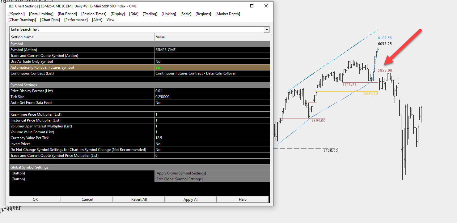

Can you remind me how to display the continuous on the daily chart?
imageDaily ES.jpg / V - Attached On 2025-04-24 17:47:46 UTC - Size: 225.6 KB - 272 views

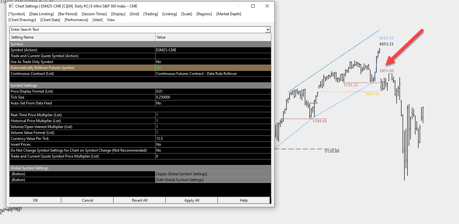

Now, please help me set up the attached chart so I can view the continuous ES contract instead of switching manually between H and M contracts. I hope I was clear?
imageDaily ES.jpg / V - Attached On 2025-04-24 18:26:43 UTC - Size: 225.6 KB - 266 views
[2025-04-24 19:32:15]
You are not clear. We gave you the link to the instructions for the Continuous Futures contract. And we see that you have added it to your chart.
We think you may be asking about discontinuity between the prices at rollover, but as we cannot see the dates, we are not certain that this is really the issue.
If it is, then what you need to do is use a "Back Adjusted" Continuous Contract option. Refer to the following:
Continuous Futures Contract Charts: Continuous Futures Contract - Date Rule Rollover, Back Adjusted

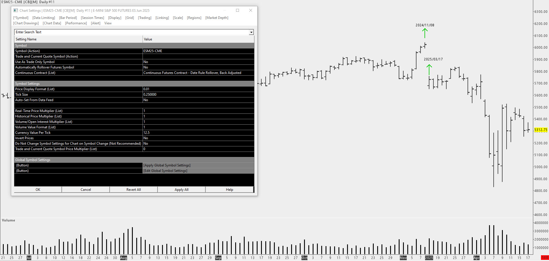

There is missing data on the chart from 2024/11/08 to 2025/03/17. I believe this may be related to the rollover between futures contracts.
Thanks for pointing me in the right direction.
imageDaily ES_M.jpg / V - Attached On 2025-04-24 19:56:42 UTC - Size: 275.5 KB - 332 views
[2025-04-24 20:38:37]
Follow these instructions to redownload missing data for a continuous futures contract:
