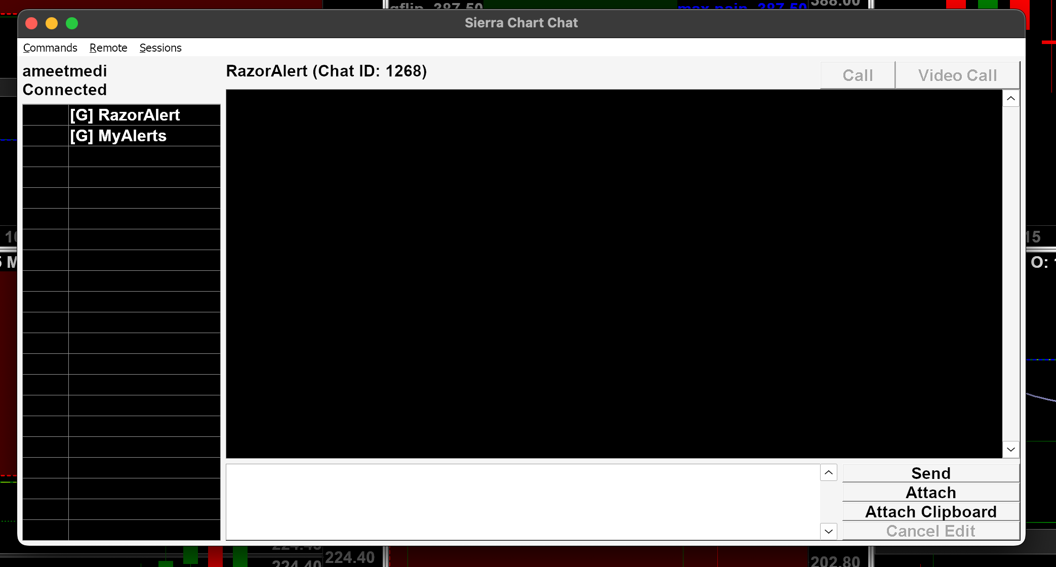

John, While I have your attention, can you help me with another error. Earlier I was trying to setup the Chat and I configured a chat group called MyAlerts. For some reason, I never got any alerts in the chat window. So today I setup another group, updated the the chat ID and setup the NTFY app and I'm getting the alerts on mobile device. IT however also opens up the chat window but the alerts are not in there.. Also, the chat window freezes and I can't close the window or do anything with the chat menu. I think it may be related to the earlier chat group I created, because as soon as I click on that group, everything freezer. I'm wondering if there is a way for me to delete that group to see if that's the issue. Unfortunately since as soon as I click into it, it freezes I cannot access the menu to see If I can delete it. Is there another way for me to delete it off the data files? Attaching screenshot, I would like to delete the group MyAlerts, Thanks |

Actually, it's not just the MyAlerts chat group. Even I click into the other chat, the window becomes unresponsive.. Is there a way I don't have to have that window pop up on an alert so I never open it, unless there is a a solution for the freezing. Once it freezes SC cannot gracefully exit. Saving doesn't work and I have to force close the application

We noticed from the image that you are running the software on a MAC computer. We do know of an issue with the Chat on MACs (or other emulator software). This is still being looked into, so for the moment the only option would be to not use the chat for alerts. We do not have a timeline on this at this time. To reset the chat to an original state, so you can move forward, you can delete the files and folders in the "ChatDataHistory" folder under the main Sierra Chart installation folder. For the most reliable, advanced, and zero cost futures order routing, use the Teton service: Sierra Chart Teton Futures Order Routing |

This is a known issue when using Sierra Chart with Wine: Also, the chat window freezes and I can't close the window or do anything with the chat menu. I think it may be related to the earlier chat group I created, because as soon as I click on that group, everything freezer.
We have not yet implemented a solution. It is not so simple. Sierra Chart Support - Engineering Level Your definitive source for support. Other responses are from users. Try to keep your questions brief and to the point. Be aware of support policy: https://www.sierrachart.com/index.php?l=PostingInformation.php#GeneralInformation For the most reliable, advanced, and zero cost futures order routing, use the Teton service: Sierra Chart Teton Futures Order Routing |

Regarding post #19, we are testing a solution now to this. Not sure if we will be successful.

Yes we have a solution. Refer to: Good News: Chat, Remote Alerts, Screen Sharing now Should Work on Linux/Wine/Mac/Crossover Sierra Chart Support - Engineering Level Your definitive source for support. Other responses are from users. Try to keep your questions brief and to the point. Be aware of support policy: https://www.sierrachart.com/index.php?l=PostingInformation.php#GeneralInformation For the most reliable, advanced, and zero cost futures order routing, use the Teton service: Sierra Chart Teton Futures Order Routing |
