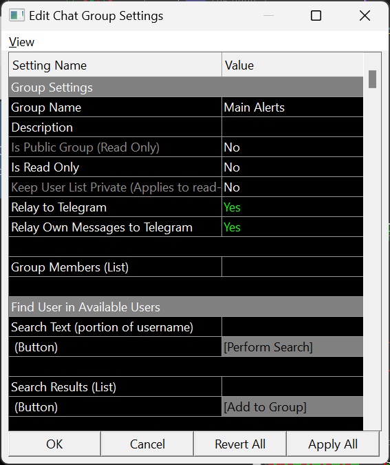

If you still get the error,, select chat 99 and then go to Commands >> Edit Chat.
Is Is Admin set to Yes, and are you in the list of Group Members?

I did what you said in your first reply and it didn't fix. FWIW deleting that folder did not clear the messages i was seeing in the chat. But could it be that I had other instances open?
I don't see an option for Is Admin.

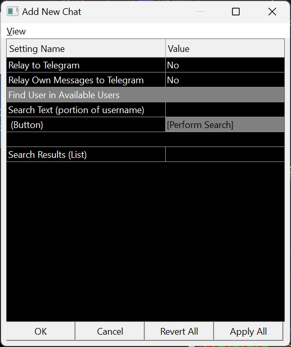

Also separately when I try to create a "New Chat" I don't see an option/field to name it so when i click ok it says the name is not long enough...
I tried attaching shot of settings window since i wasn't sure if the builtin screenshot feature would work. Sorry if this is not protocol.
I may try to create a new group chat. But wanted to get your take on what might be happening first.

You cannot name a peer to peer (user to user) chat as we call them:
You can only give a name to a Group Chat. The name must be at least five characters.
