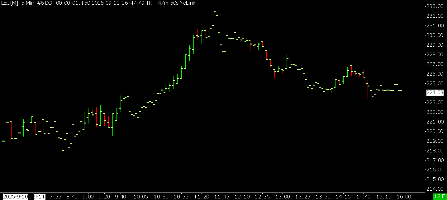

[2025-09-11 05:32:06]
User393999 - Posts: 7
I’ve subscribed to Package 11 with the intention of accessing market depth from all stock exchanges. However, as you mentioned, Sierra Chart currently does not provide market depth for the consolidated tape. But I noticed on Sierra Chart a service called “US Equities Consolidated Tape with Depth” — is this a newly added feature? and if so, how can it be activated and used?
Additionally, since I’m new to the stock market and recently shifted from futures trading, I observed on IBKR that there are multiple stock data sources (e.g., NYSE ArcaBook (L2), NYSE OpenBook (L2), etc.), but I haven’t seen these options available in Sierra’s trade service. Does this mean that Denali Data feed not yet support some of these stock data feeds?

[2025-09-11 15:48:45]
John - SC Support - Posts: 48408
We do not know what "NYSE ArcaBook" and "NYSE OpenBook" are exactly. You would need to check with Interactive Brokers on what those are specifically referring to.
Our "U.S. Equities Consolidated Tape" has the data for the 19 exchanges that make up that data. This is the typical data you will see when looking at U.S. equities.
The "U.S. Equities Consolidated Tape with Depth" has been available for awhile now. We can't even remember exactly how long now, so it's been at least a year or two. Refer to the following for the information on this option:
Denali Exchange Data Feed: U.S. Equities Consolidated Tape with NASDAQ TotalView
[2025-09-11 16:25:10]
I tried the way of combining both data as shared in the link, and both charts not moving either the -NQTV or the one with _MBO
[2025-09-11 16:30:08]
Keep in mind that since you do not have the exchanges themselves active, you will only get the "Delayed Streaming Data", which is 15 minutes behind the actual market. As such, it is possible that when you first open a chart for a symbol that you are getting the data up to the current time. In this case, you then have to wait for 15 minutes before the chart will start updating, so be sure to give it this time to see what happens.
Also, be aware that the Market Depth data from the NASDAQ TotalView is not available with the Delayed Streaming data. So you will not get any Market Depth data in this case.
[2025-09-11 18:09:56]
Even after 15 minutes, the chart in _MBO is not updating, and the candles are not moving. From what I understood of the method you shared, it should synchronize with -NQTV while it’s open. Also, part of my question wasn’t fully addressed; specifically regarding NYSE OpenBook (NYSE Level 2) support; is this supported by the Denali feed?
[2025-09-11 19:41:04]
Please get us your Message Log by following these instructions:
Close all of the Chartbooks with "File >> Close All Chartbooks".
Open a single chart for the symbol you have an issue with through "File >> Find Symbol". Tell us that symbol of the chart. Tell us about *one* symbol only.
We stated in our first response: "We do not know what "NYSE ArcaBook" and "NYSE OpenBook" are exactly. You would need to check with Interactive Brokers on what those are specifically referring to."

[2025-09-11 20:33:07]
Your log is not showing any errors or issues.
And you are still not getting any updates for this chart for LEU?
In looking at the chart for LEU, we see that it is fairly sparsely traded and there are times where a few minutes may pass between trades.
Please open a chart for a much more traded equity - such as AAPL or TSLA. And then let us know if you are not seeing updates to the chart.

[2025-09-11 21:50:45]
Attached is an image of LEU with a 5 minute bar period.
imageLEU[M] 5 Min #6 2025-09-11 16~48~51.640.png / V - Attached On 2025-09-11 21:50:42 UTC - Size: 26.57 KB - 322 views
