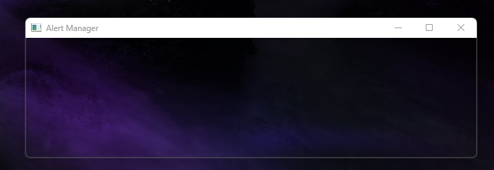

Hey guys, some technical info:
Running Sierra Chart latest version on Windows 11 and I have the Alert window open at all times.
I've tried updating my drivers, updating Windows, nothing helped.
The problem:
Every once in a while the Alert window just hangs and stays, it doesn't have any content in it, it doesn't matter if I turn Sierra off, switch windows, close Sierra from the task manager, restart the file explorer, the window just stays consistently and is immovable and non-interactable.
Only way I've found to fix the issue is restart my whole PC.
Now it's quite a new issue and seems to happen at random, I am not able to replicate it on my end consistently unfortunately due to the random nature of it.
I have attached an image of what the window looks like, would really appreciate some help because it makes some other apps completely unusable for me till I restart my PC, which of course during trading is less than ideal.

[2024-01-19 17:41:39]
If Sierra Chart is closed and the window is still there, then this would be an Operating System issue. Still, when this occurs, check to ensure that Sierra Chart is actually not running at all by opening the Task Manager. If it is still running, then end the task in the Task Manager and see if the window goes away.

User314793 - Posts: 4
Hey John, thanks for the quick reply, as I've mentioned the window remains even after closing Sierra via the Task Manager.
Tried searching online but no luck, I'll keep looking, thanks for the quick reply!
[2024-01-19 21:57:38]
This would be something about the Operating System then.
We are curious, when this occurs, are you able to interact with Sierra Chart as normal, or is Sierra Chart also locked up?

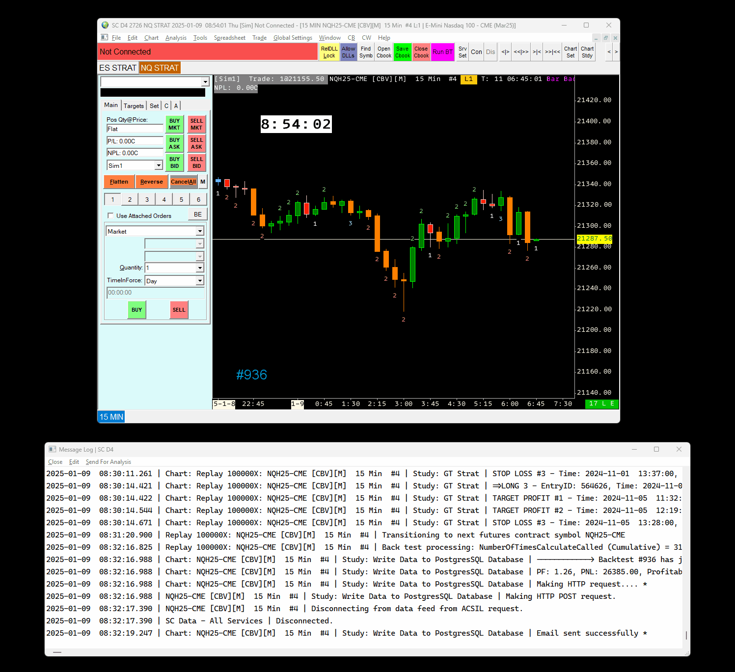

[2025-01-09 14:05:47]
gtaranti - Posts: 99
The same behaviour has been observed many times in the past weeks.
It doesn't matter what SC version.
This last one is with version 2726.
You can witness this in the attached GIF file. After closing the SC app the MessageLog window stayed stuck on the screen. I have to reboot to get rid of it.
(If the uploaded GIF file does not work, I have uploaded to an online service https://imgur.com/SlCZiQg)
Date Time Of Last Edit: 2025-01-09 14:06:02
imageSC Ghost MessageLog.gif / V - Attached On 2025-01-09 14:02:13 UTC - Size: 5.87 MB - 272 views
