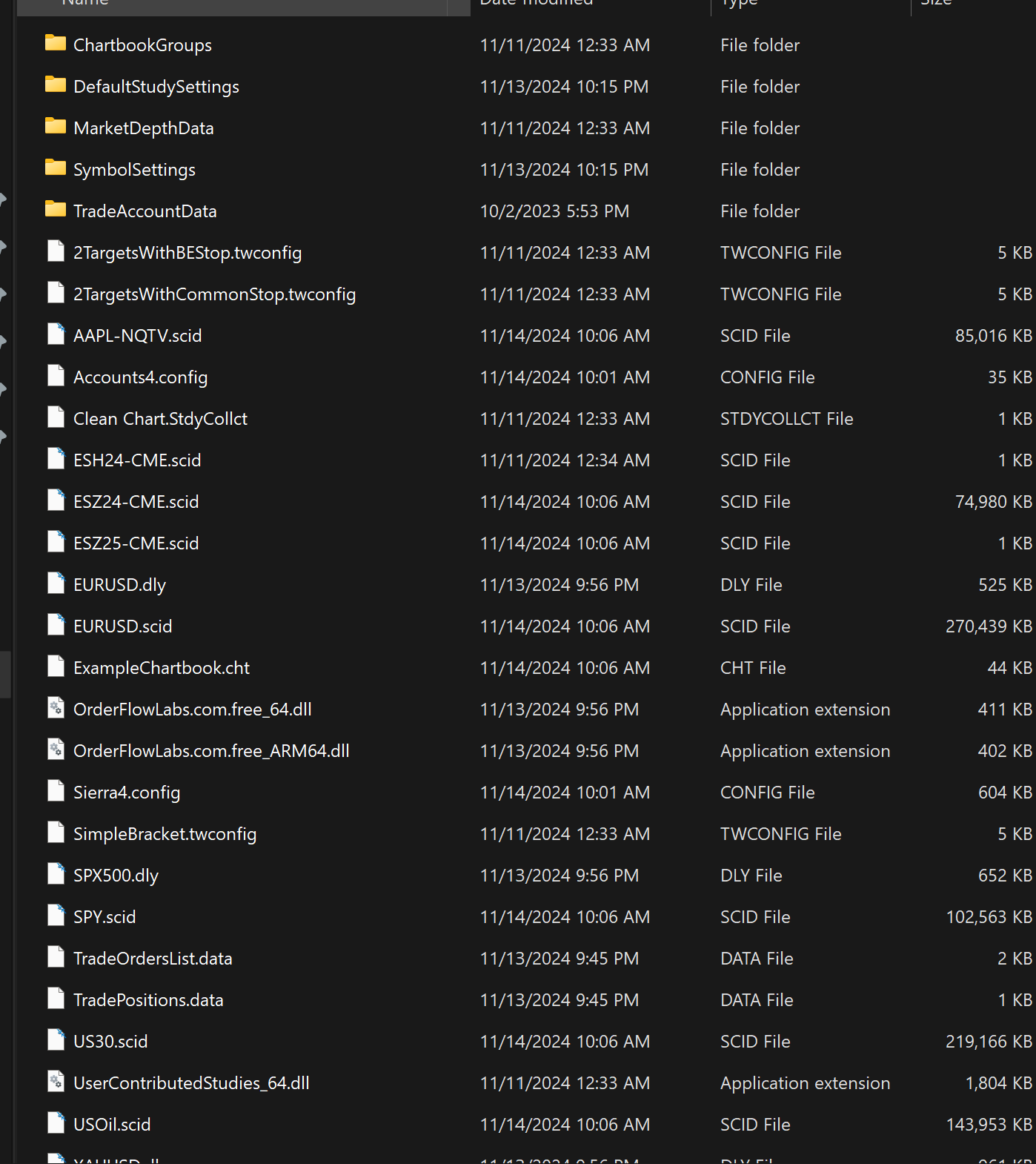

Yes I had already downloaded sierra onto the new computer. I also copied the files into the data folder but still when I open
sierra it's still opening to the default charts. I even went to open a open a chartbook. When I did this I selected all files from the drop down
when I did this I could see the files that I copied into the data files but when I tried to open them nothing happened. Is there anyway I could get some
assistance with this. I'd be willing to make a donation. :)
imageScreenshot 2024-11-14 101604.png / V - Attached On 2024-11-14 15:16:34 UTC - Size: 187.5 KB - 230 views

The reason why the default chartbook is opening is that you have not configured that new system to open the chartbook(s) you want.
The easiest way to resolve this is to copy the file named "sierra4.config" from the old computer to the new one. This file is located in the main Sierra Chart installation folder (typically C:\SierraChart). Make sure Sierra Chart is not running on either computer when you copy the file from and to the computers.
This file - sierra4.config - contains all of your global settings, including the files to open on startup.
That aside, you should be able to open the chartbooks with "File >> Open Chartbook". What exactly occurs when you do this for one of your existing chartbooks? What are you seeing, or not seeing? Your system may need to redownload the data, so it could take a few minutes to get the data downloaded to your new system.

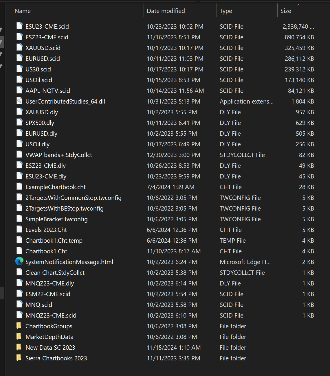

[2024-11-15 17:43:09]
Ghosttrader - Posts: 40
I was at work responding by memory but now i'm home. So no you were correct when I select open chartbook the charts I've built are there. But again on my main computer when I go
to the C drive/Sierra chart/Data none of my built chartbooks are in there. But if I go to the C drive/sierra/backups they are in the backups folder. I've attached images of both the data and
backups folder.

[2024-11-15 19:35:17]
Do not worry about, or pay any attention to the "Backups" folder at this time.
We are very confused by these statements:
"when I select open chartbook the charts I've built are there"
"on my main computer when I go to the C drive/Sierra chart/Data none of my built chartbooks are in there"
If you have your chartbooks in the "Data" folder on one computer but not the other. The copy the files with the .cht extension from the computer that has them to the computer that does not. You need to copy them from the "Data" folder on one system to the "Data" folder on the other.
Once you do that, you should have the same chartbooks on both systems, at least for that moment. Once you start making changes on a system to the chartbooks, you would need to copy the chartbooks to the other system in order to have them in the same state.
