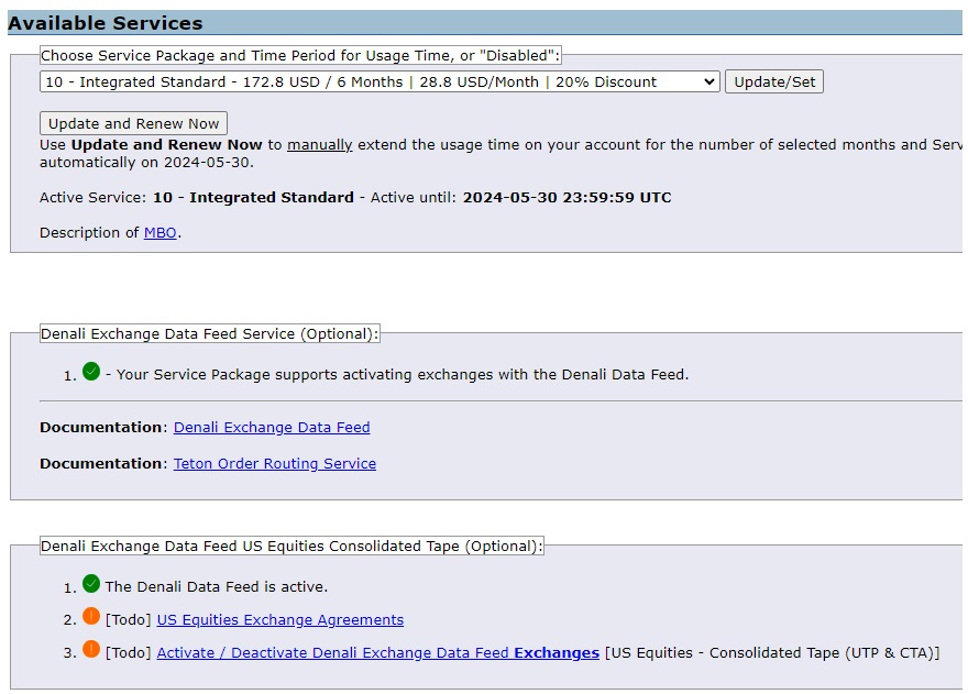

User788463 - Posts: 22
When checking my accounts, it should be Teton order routing.
The attached file is a snapshot of my account information.
imageSC_DataFeed.jpg / V - Attached On 2024-01-23 16:59:14 UTC - Size: 136.01 KB - 121 views
[2024-01-23 17:01:56]
John - SC Support - Posts: 47955
We need to know how your Brokerage account is setup. Your brokerage will have set you up to use Teton, CQG, or Rithmic. We need to know which one in order to give you the proper instructions to connect.
[2024-01-26 12:35:10]
My account is set up on Teton order routing, and the clearing firm is IronBean.
Now, SC can show my account information. But I can't receive real-time data.
How to fix it??
