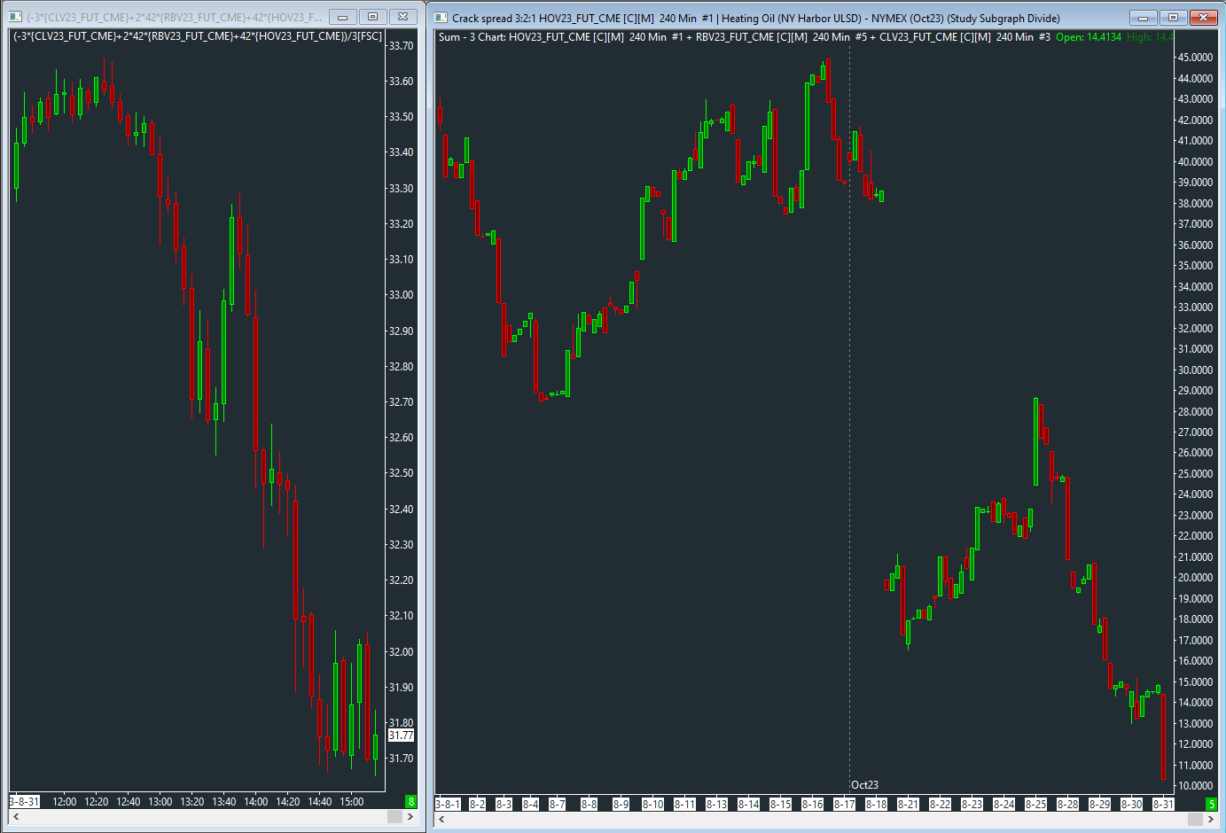

Price now is 31.77 correct and this chart is 10 I am using Teton with Sierra
imagecrack321.PNG / V - Attached On 2023-08-31 14:31:47 UTC - Size: 71.42 KB - 311 views

The chart on the left of the previous image is the custom symbol, this is not ideal as I need to be able to chart more data and roll forward. the chart on the right is using two studies. The price is not correct since rollover and I cannot workout whats wrong, can you confirm I am using the correct method and if not, provide the correct method?

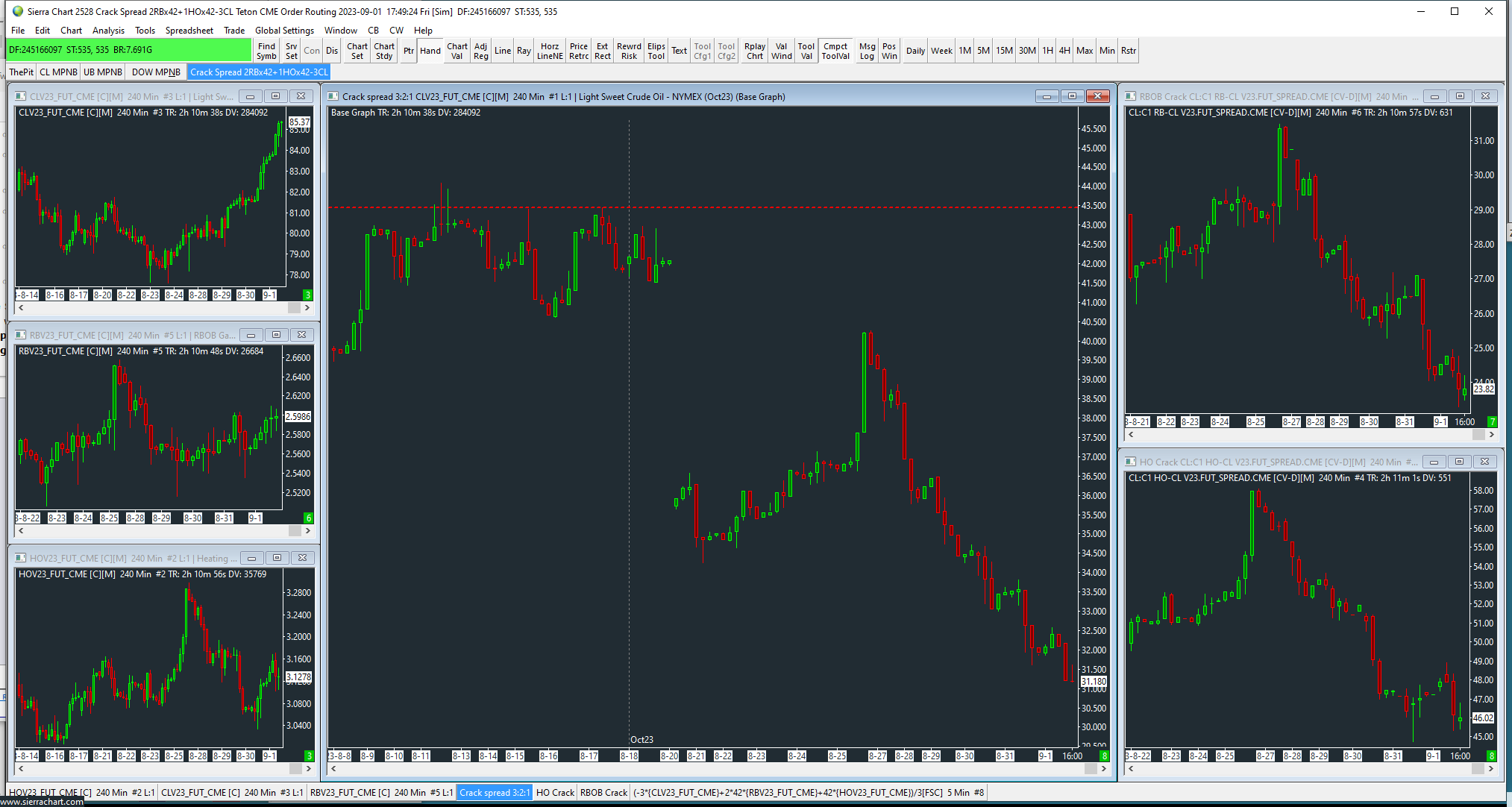

I have uploaded a screenshot https://www.sierrachart.com/image.php?Image=1693586589362.png
I think the bug is related to the Spreadsheet formula (Bar) study, if I make any changes to this study and then click Apply and OK the screenshot shows the result, as mentioned, If I then open chart settings and press OK it reloads the chart data

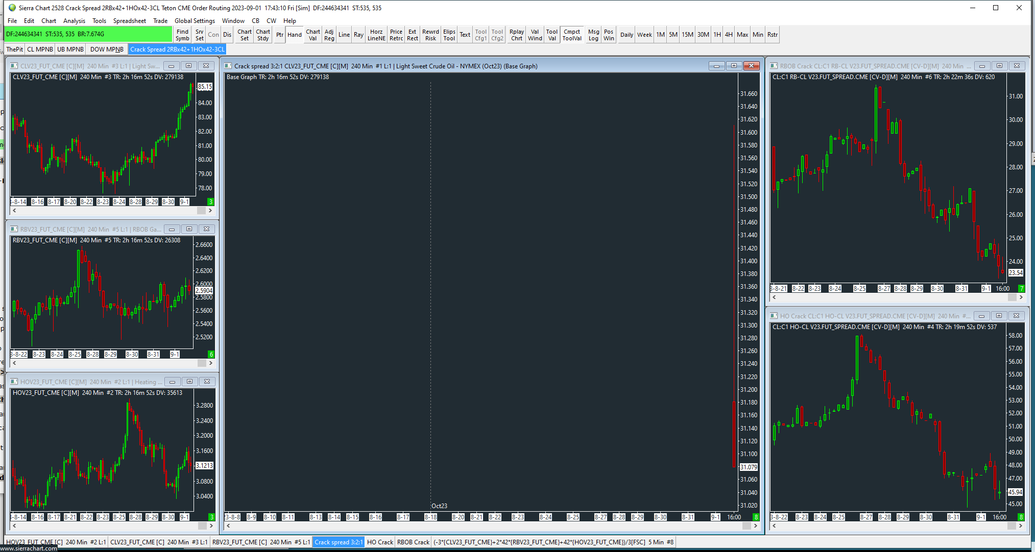

like this https://www.sierrachart.com/image.php?Image=1693586964477.png
Hope this helps

User720879 - Posts: 29
With the uploaded chartbook, When you open it, there is no display? Open chart settings on the main chart and just click OK and the data will load.

We think we know what is occurring - since you have the "Spreadsheet Formula - Bar" set to be the Main Price Graph, this sets the priority for that study to be the highest one, therefore the system is calculating that study prior to the "Study/Price Overlay" studies being calculated. Therefore, it does not have the information it needs to display properly.
This is going to sound a bit odd, but the solution is to not set the "Spreadsheet Formula - Bar" to be the "Main Price Graph" in the chart where you have it right now. Rather, just make it another study in another region, you can even hide it if you want. Then you will need one more chart of any symbol (it doesn't matter) and use a "Study/Price Overlay" to get the "Spreadsheet Formula - Bar" information into that chart. Then set the "Study/Price Overlay" to be the Main Price Graph in that chart.
