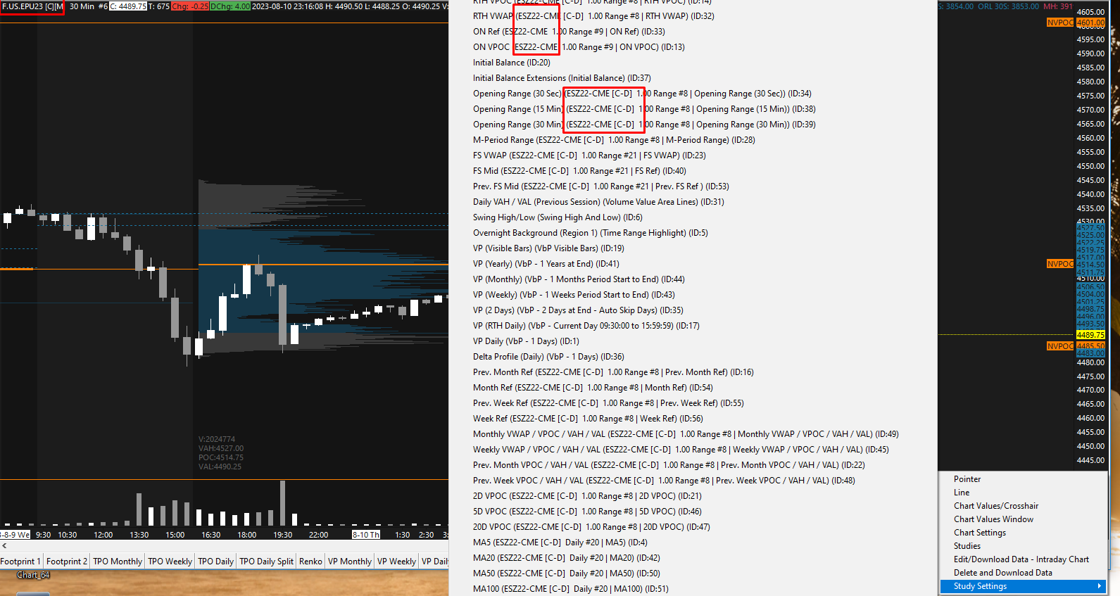

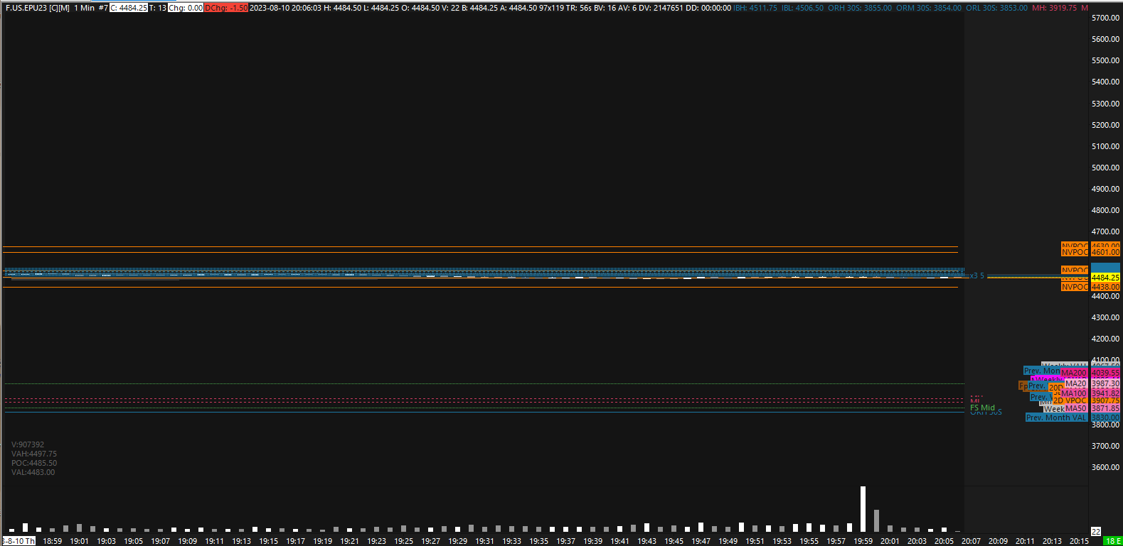

Upon getting Denlai live data my custom studies are no longer working, It loads with an expired ES contract on the chart upon changing the symbol I lose many of the studies. Ive noticed the studies are here but at the prices from the chart my chartbook loads with. How do I fix this?
imageScreenshot_2455.png / V - Attached On 2023-08-10 20:06:44 UTC - Size: 46.66 KB - 239 views
imageScreenshot_2454.png / V - Attached On 2023-08-10 20:06:54 UTC - Size: 38.07 KB - 240 views
[2023-08-10 21:13:59]
A study, or studies, are set to "Automatic" scaling which is causing a wider range of the scale to show up than it should. You would have to figure out what study(s) are doing this and change their scale (make it Same as Region) or remove them.

[2023-08-11 12:43:09]
Either that is part of the "Short Name" that has been entered for the study, or the study is a "Study/Price Overlay" and that study is referencing a chart that is set to the ESZ22-CME symbol.

[2023-08-14 15:26:55]
If it is just the "Short Name", then you need to pull up those studies and change the "Short Name". Refer to the following:
Chart Studies: Settings and Inputs Tab >> Short Name
If the study is a "Study/Chart Overlay" then you need to find the chart that it is referencing and either update the chart, or change the "Study/Chart Overlay" to reference a chart and study that is setup as you want it. Refer to the following:
