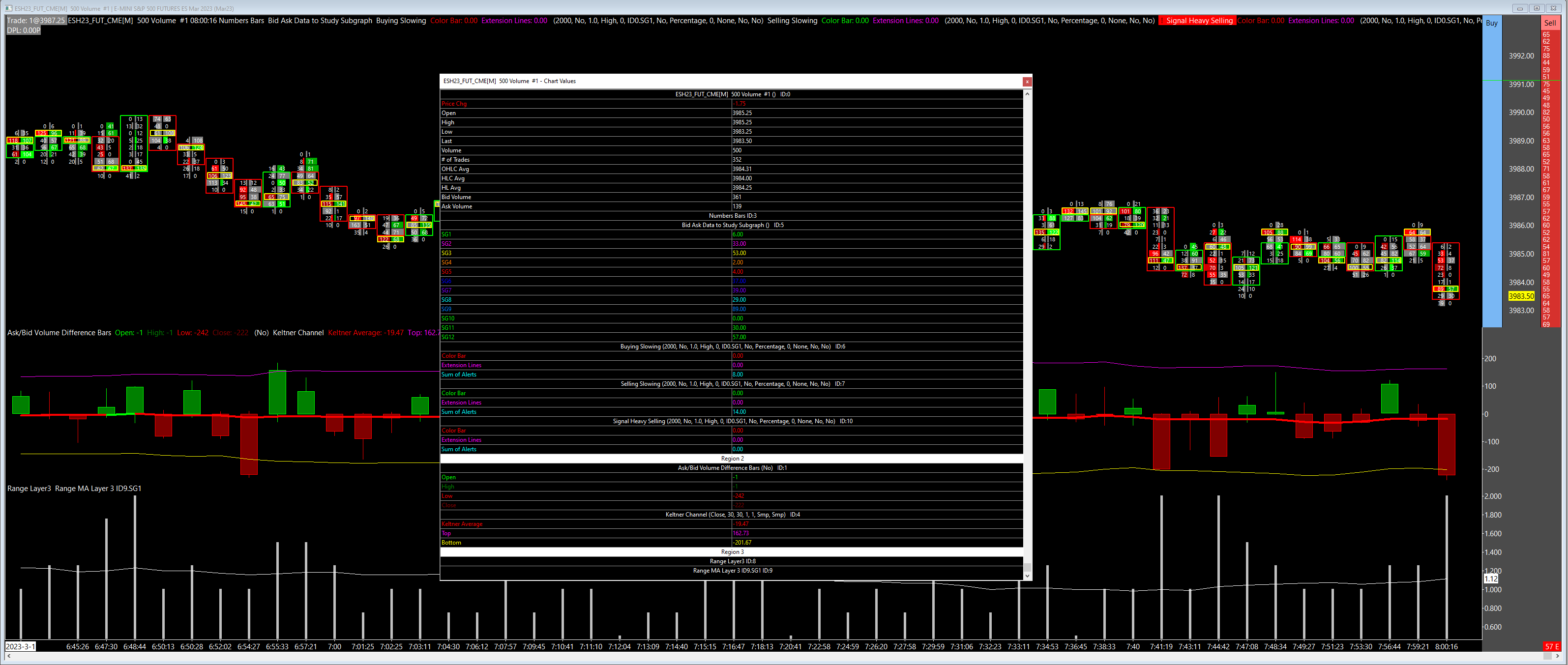

I frequently have this problem, create a data point I want to use in this case range H-L and then a moving avg of it to compare range to the avg but then when putting in the correct ID and SG in this case ID9.SG1 the alert doesn't work. In Chart Values window there's simply no data for my range or moving avg of the range. It's happened dozens of times can't figure it out.
imageCapture.PNG / V - Attached On 2023-03-01 13:43:36 UTC - Size: 206.28 KB - 292 views
[2023-03-01 21:24:44]
The subgraphs for the Range and Range Moving Average must be set to not display in the Tool Values Window. Refer to the following setting:
Chart Studies: Subgraphs Tab >> Display Name and Value in Chart Values Windows
But the real question is what is your Alert formula?

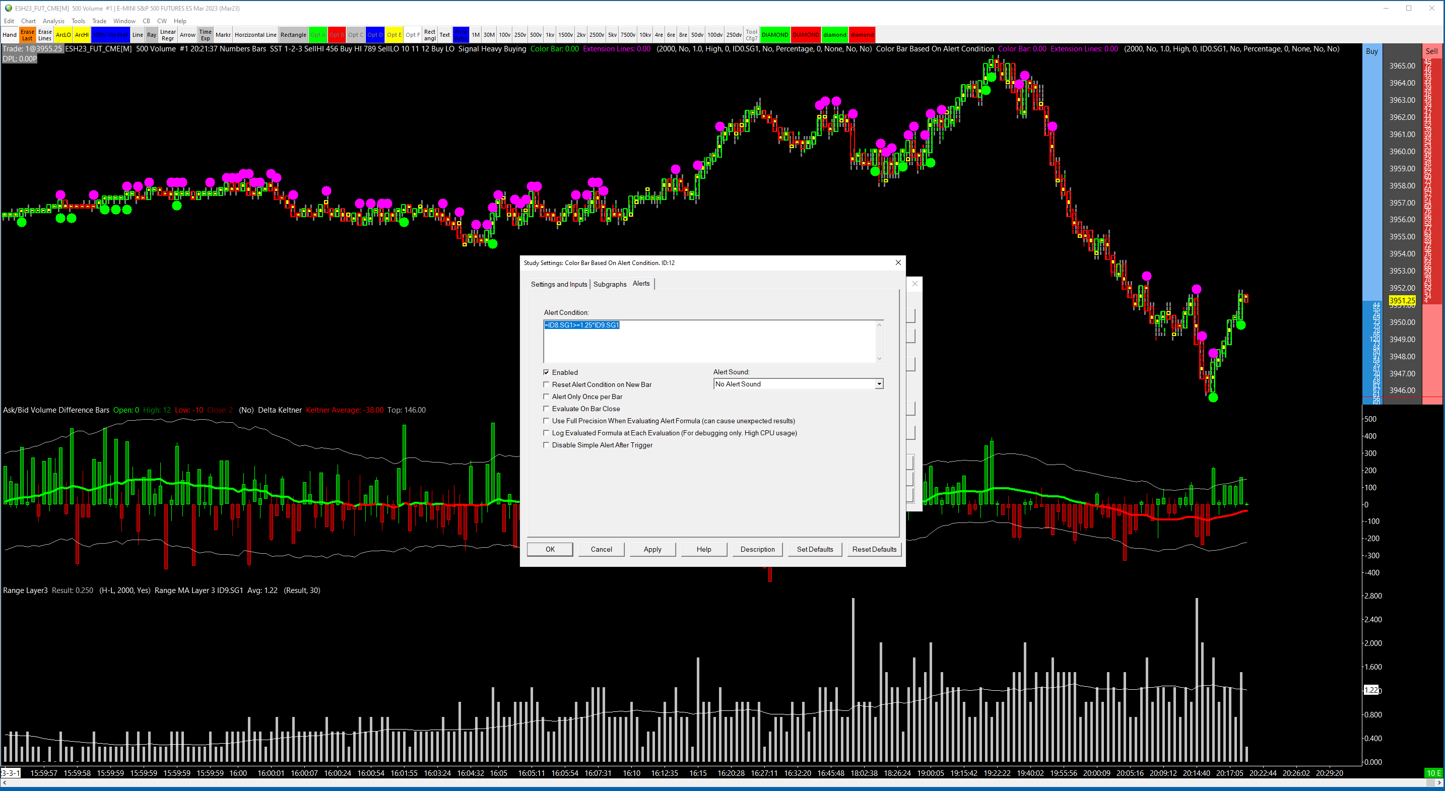

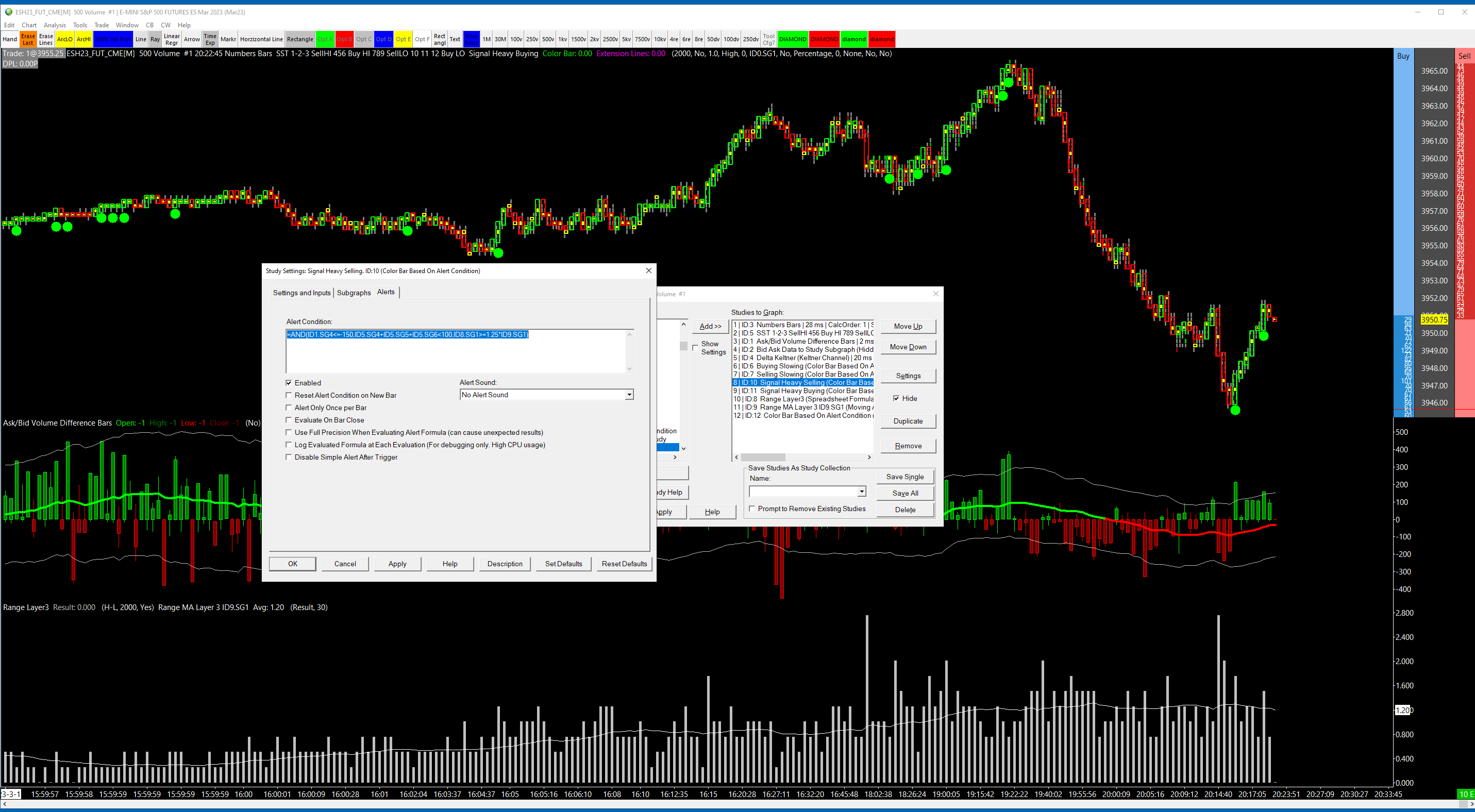

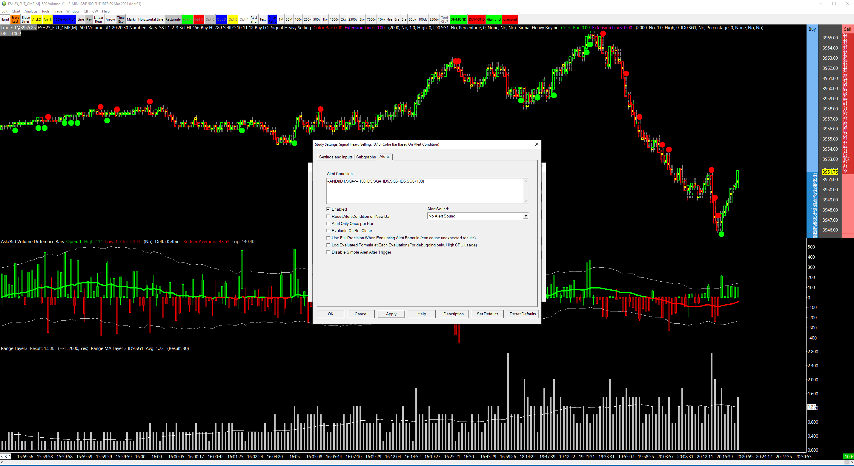

TopGunTrader - Posts: 313
I take it back when I created a new color bar alert with that ONE rule it showed up, when I added it to previous signal they no longer showed up even though when as a single rule they 'signaled' on most of those bars.
I posted pics of all 3 sell signals by themselves without this extra rule, the one rule which works and then lastly adding that rule to original one and there were no signals at all. This has happened to me so many times in the past where I eventually give up on trying to write signals even though I need them.

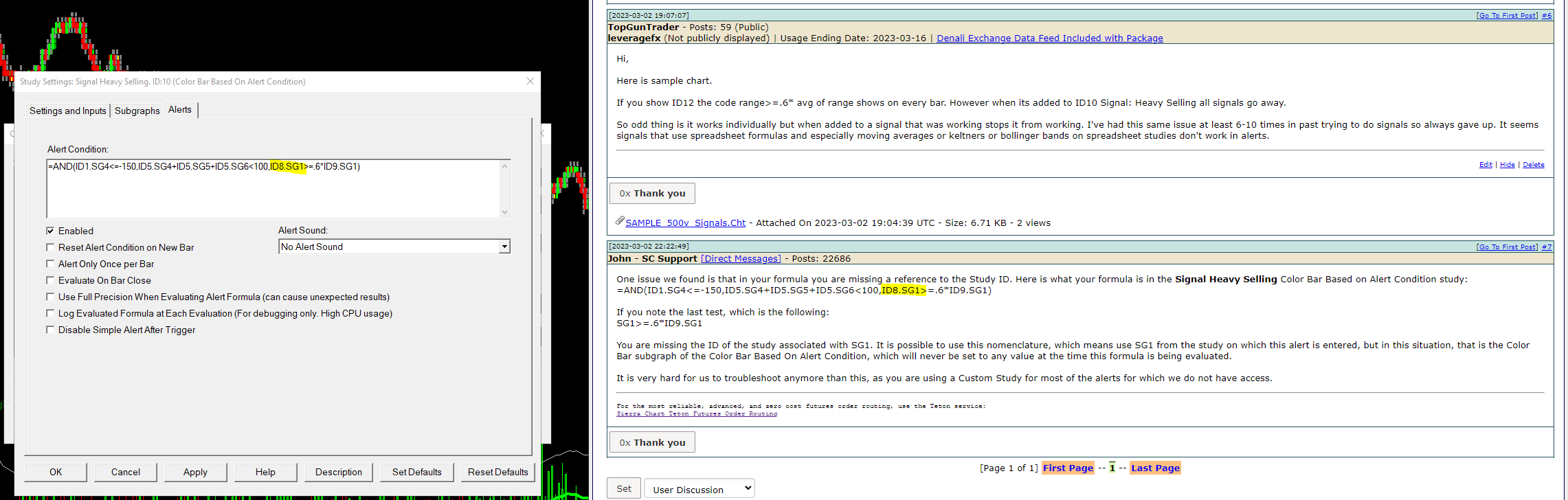

One issue we found is that in your formula you are missing a reference to the Study ID. Here is what your formula is in the Signal Heavy Selling Color Bar Based on Alert Condition study:
=AND(ID1.SG4<=-150,ID5.SG4+ID5.SG5+ID5.SG6<100,ID8.SG1>=.6*ID9.SG1)
If you note the last test, which is the following:
SG1>=.6*ID9.SG1
You are missing the ID of the study associated with SG1. It is possible to use this nomenclature, which means use SG1 from the study on which this alert is entered, but in this situation, that is the Color Bar subgraph of the Color Bar Based On Alert Condition, which will never be set to any value at the time this formula is being evaluated.
It is very hard for us to troubleshoot anymore than this, as you are using a Custom Study for most of the alerts for which we do not have access.

User431178 - Posts: 910
Your alerts need to be moved down the list, below the studies they are referring to.
Spreadsheet formula and color bar based on alert condition both have the same calculation precedence, so if spreadsheet is below CBBOAC in the list of studies the result of the spreadsheet formula is calculated after the CBBOAC condition is evaluated.
