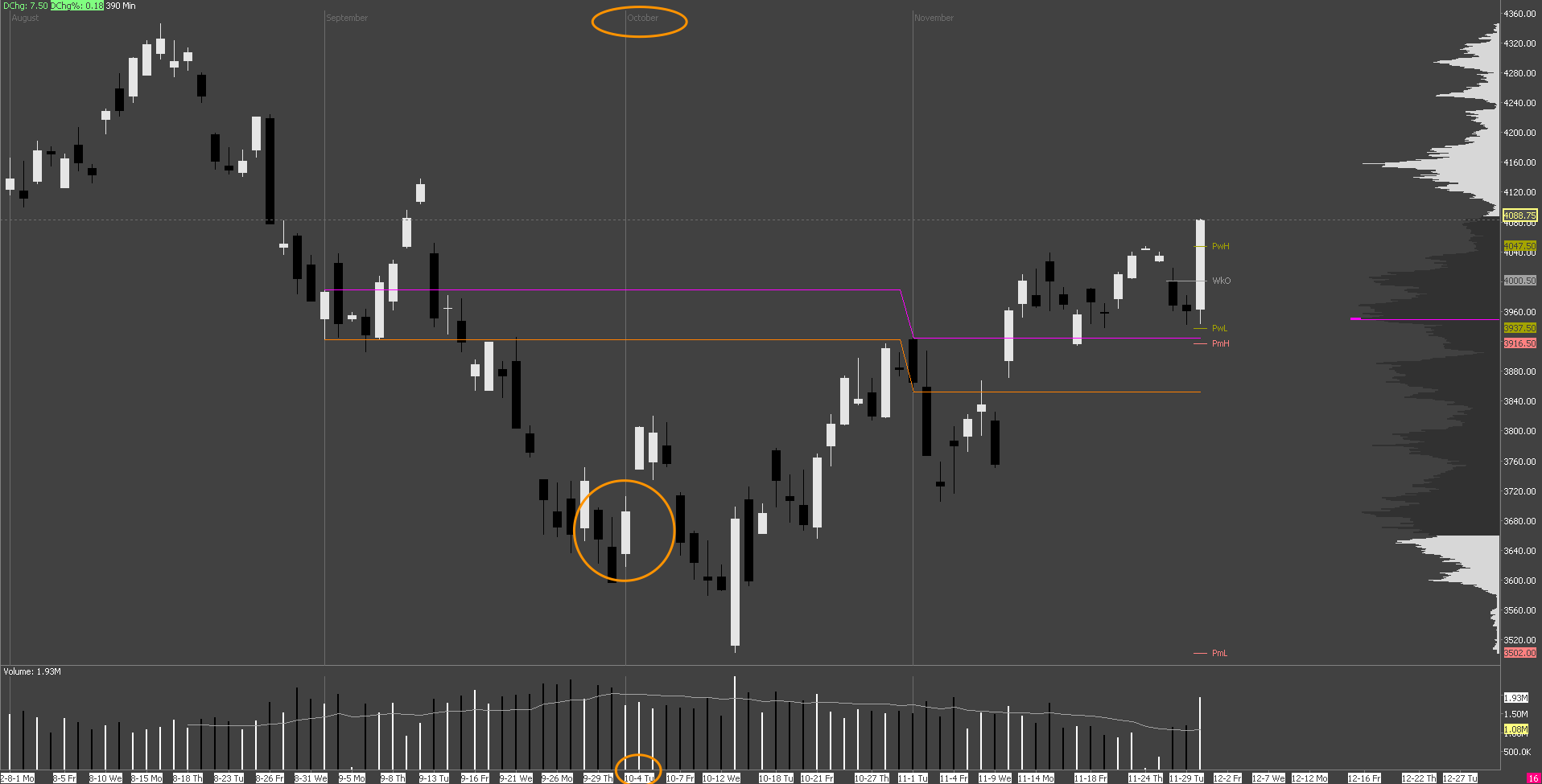

I'm curious if there is a way to extend the high/low for the first trading day of each month, going back a specified number of months. Currently I look back about 4 months, and manually draw in the high/low for first trading day of each month and extend it all the way to the right. You can see the automation in pink/orange, and my manually drawings in light blue shaded rectangles. I've also noticed that it has skipped October for some reason?
Anyway, I've attached an image to show what I mean. It may be too complicated, or simply not possible. But If you have any insight it'd be greatly appreciated.

You could use the Study Subgraph Reference to create another copy of the data and then set the Draw Style to Line at last Bar Left to Right. You would have to add this study for each line per month. And then you would need to use the Displacement option to get the previous months data. Refer to the following:
Chart Studies: Line at Last Bar Left to Right (ACSIL: DRAWSTYLE_LINE_AT_LAST_BAR_LEFT_TO_RIGHT)
Chart Studies: Subgraphs Tab >> Displacement

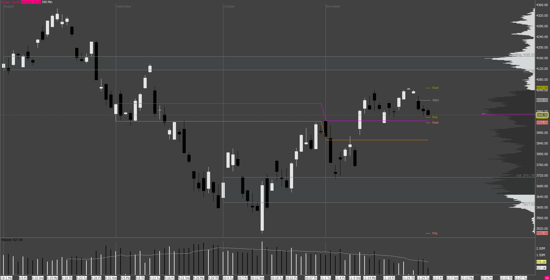

When I use "=IF(DAY(A3) = 1, ID1.SG1@3, 0", it returns the data for the 1st calendar day of the month. However, the first calendar day of the month isn't always the first trading day of the month.
I am trying to create a study that illustrates the monthly opening range; I define this as the cash session high and low of the first trading day of the month.
In the image I've attached you can see that the month of October has been skipped due to the first trading day being on 10/4.
imageESZ22 [CBV][M] 390 Min #12 2022-11-30 22_34_17.887.png / V - Attached On 2022-12-01 06:34:52 UTC - Size: 70.69 KB - 378 views

Unfortunately, we can not think of a solution to this particular problem.
There is a user named TomGilb that monitors this forum and he is an expert in the Sierra Chart Spreadsheets. Hopefully he will see this and give an answer if it can be done.

Sawtooth - Posts: 4361
This returns the first Business day of the month:
=WORKDAY(EOMONTH(A3,-1), 1)
Not sure if it will always match the first trading day.
I think this example could be modified to do what you want:
Opening 30min range for every month
See post #5.
If you need more help, post again.

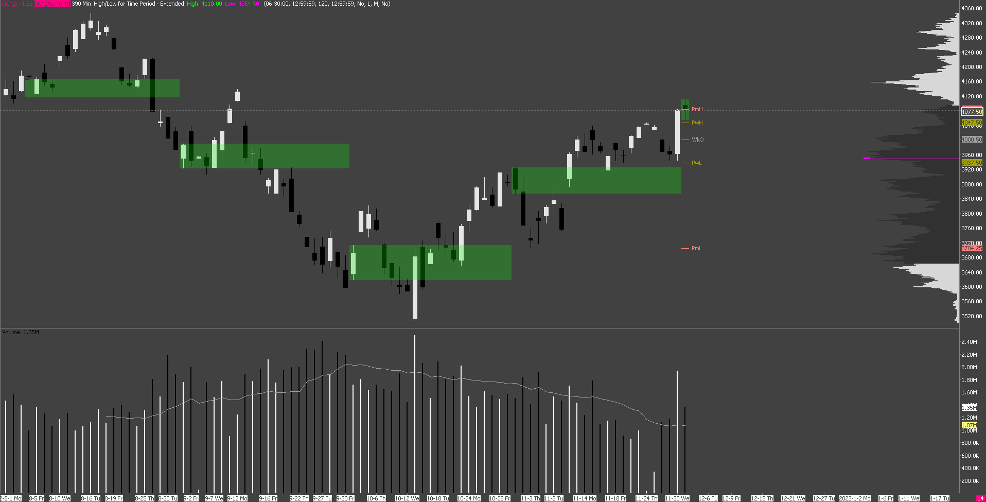

I was able to use your formulas, and then add the "highlight High/low for time period - extended study" to do exactly what I was looking for. Thank you very much! Last question to complete this study: I've used "transparent fill rectangle top/bottom" to shade the monthly opening ranges. Is there any way to extend each rectangle to the end of the chart?
I've included an image for reference.
It is not possible to extend to the chart's right edge with spreadsheet studies.
Also, spreadsheet studies are limited if you want to extend more than one rectangle to the current bar.
You would need a pair of Formula Columns for each rectangle, and only the most recent ones would be displayed, older ones would vanish.
It is even more limited and complicated to extend until future intersection.
Update, a workaround:
You could use two Color Bar Based On Alert Condition studies to extend H and L lines,
Then use the Study Subgraphs Reference study to shade between them.
