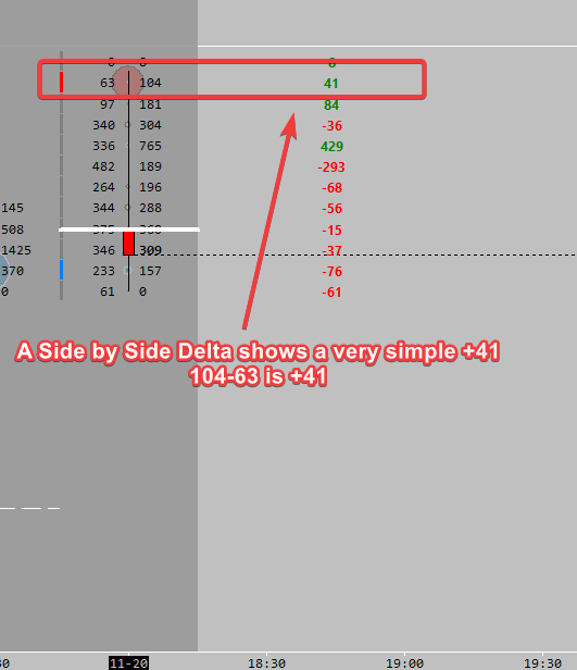

hello!
I mentioned this awhile ago and was told you guys would look to add it to future releases, should be pretty easy and wanted to ask again, if possible to add a "diagonal Delta" option to number bars?
i know there is a "askvol/bid Vol diagonal diff" but its not the same, if we could have a basic "diagonal delta" would be a very welcome option! that was we only see 1 number per vol multiplier bar vs a dual column like the "askvol bidVol diagonal difference" does. even a SxS delta would be welcome! or Both! i think this would be a very easy to add?
Anyways thank you for reading this! hoping it can be added in the future
[2022-11-20 15:46:46]
HeyUgly - Posts: 288
picture attached for reference
imageCapture.PNG / V - Attached On 2022-11-20 15:46:39 UTC - Size: 82.33 KB - 701 views

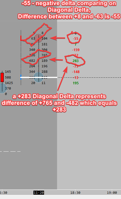

You bet very easy
Basically Delta equals difference between bid/ask vol, weather it be a + or -
Here are a few examples in the picture attached.
Sierra actually does it already , as you can see in the first picturei uploaded in the original post, i just want to know if we can Just have that first column in the first pic, and not the second column. You see how the first column, and my delta study are the same? if you could just tweak it to remove the secondary column would be an easy fix!
anyways , i have attached pictures showing Side by Side delta, and a diagonal delta in relation to the number bars, very simple.
imageCapture.PNG / V - Attached On 2022-11-20 23:27:38 UTC - Size: 49.92 KB - 643 views
imageCapture1.PNG / V - Attached On 2022-11-20 23:27:44 UTC - Size: 26.37 KB - 538 views

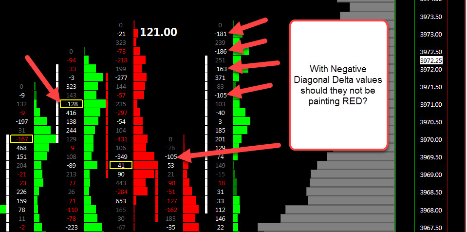

User24791 - Posts: 49
I see on my chart using Ask Vol Bid Vol Diff Diagonal 1 Side Negative deltas painted white color...Should they not be RED color?
imageDiagonal Delta.jpg / V - Attached On 2023-02-26 02:14:52 UTC - Size: 146.13 KB - 448 views

It depends on your settings. Please get us your chart so we can take a look. Follow these instructions:
I have attached Number Bars Chart book for review
attachmentORDER FLOW NUMBER BARS.Cht - Attached On 2023-02-27 19:09:32 UTC - Size: 4.1 KB - 624 views
[2023-02-27 22:42:36]
The way you have this setup is that you are coloring the numbers in the first column based on Diagonal Dominant Ask Vol Bid Vol - Actual. As such, it is not the difference values that are being used, but the raw Bid and Ask values. In this particular case, whenever the Bid side is dominant and the actual Bid value is greater than 100, then the value will be colored red. Refer to the information for this setting here:
Numbers Bars: Text Coloring Based On Diagonal Dominant AskVol BidVol - Actual
So nothing is wrong, it is working properly.
If this is not what you are wanting, then please describe what you want to have an we will see if there is a way to set it up (most likely there is an option for it already).
Date Time Of Last Edit: 2023-02-27 22:42:48
Hi John,
Thanks for your response..Let me describe...Perhaps I am not using the proper setting, as there are many choices. So, I am currently using the Ask Vol Bid Vol Diff Diagonal 1 Side My understanding is that the diagonal dominant difference if negative number should paint RED (bid column) and if positive number paint WHITE (ask column). (note: number colors are my choice)
Hopefully I am understanding this concept correctly and if so, what setting should be used? As I thought the Actual Diagonal Dominant was the proper choice.
Blessings,
David
[2023-02-28 17:41:06]
There is not a way to do exactly what you are stating.
But we wonder if you are really wanting to display the Ask Vol Bid Vol Diff Diagonal 1 Side. In this particular option, you are always viewing the Bid Side Diagonal Difference Calculation. This does not mean that a positive value is Ask Dominant or that a negative value is Bid Dominant, as it is just displaying the Next Higher Ask minus the Bid. It is not showing anything related to dominance.
If you let us know what you are wanting to see, again, we can help you determine what is the best option.
Hi John,
So based on your response, the Ask Vol Bid Vol Diff Diagonal 1 Side selection is not what I am looking for. I am looking for what you describe: "positive value is Ask Dominant or that a negative value is Bid Dominant"
By way of example #1: Bid Value:200 Ask Value:100 IF (Diagonal Ask Vol - Diagonal Bid Vol) THEN, Net Diagonal Difference = -100 This net Diagonal Difference value being negative would be displayed as -100 (RED) in a single value column.
By way of example #2: Bid Value:150 Ask Value:300 IF (Diagonal Ask Vol - Diagonal Bid Vol) THEN, Net Diagonal Difference = +150 This net Diagonal Difference value being positive would be displayed as +150 (Green or White) in a single value column.
Does this make sense? I do not see a selection for this type calculation. From my perspective this is the TRUE DIAGONAL ASK VOLUME - DIAGONAL BID VOLUME NET DOMINANT VALUE.
Hope this helps explain
Thank you for your assistance,
Regards,
David
[2023-03-02 16:48:06]
We do not have an implementation of the example you provide where it does a diagonal comparison of the Bid and Ask separately (which we do have - Ask Vol Bid Vol Diagonal Difference) and then does a difference of those values (which we do not have).
Therefore, the closest option we have is the Ask Vol Bid Vol Diagonal Difference for the text display. Refer to the following:
Numbers Bars: Numbers Bars Text Types
[2023-03-02 18:07:16]
Thanks John for your explanations...Not exactly what I am looking for compared to my knowledge of how Diagonal Dominant Values should be calculated i.e. Market Delta
I will work with what SC has which is an excellent product.
