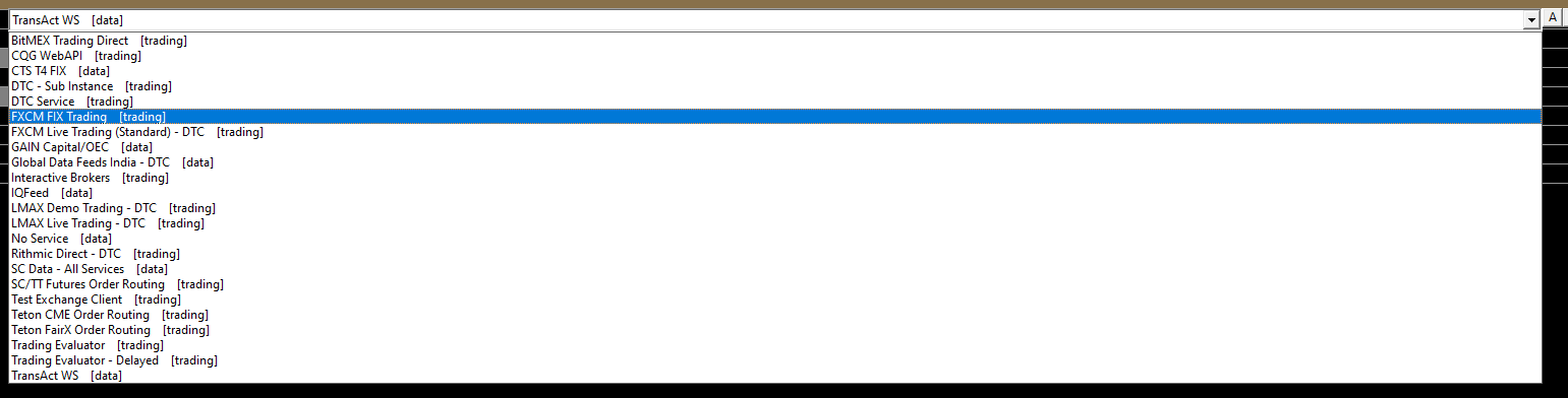

[2022-09-09 12:34:38]
Steve Leon - Posts: 319
In regards to the Teton Futures order routing/data setup.
This is what I am seeing (attached picture).
Should I be selecting Teton CME Order Routing (trading) on the dropdown menu for Current selected server ? Does that automatically use Denali data ?
I do not see: SC CME Futures Order Routing / Teton CME Order Routing (new name) which is what you reference in the materials ?
Thank you
imageSierra DTS server settings.PNG / V - Attached On 2022-09-09 12:34:30 UTC - Size: 21.96 KB - 205 views
[2022-09-09 13:05:29]
Sierra_Chart Engineering - Posts: 25348
You need to select "Teton CME order routing" and that does automatically use Denali data.

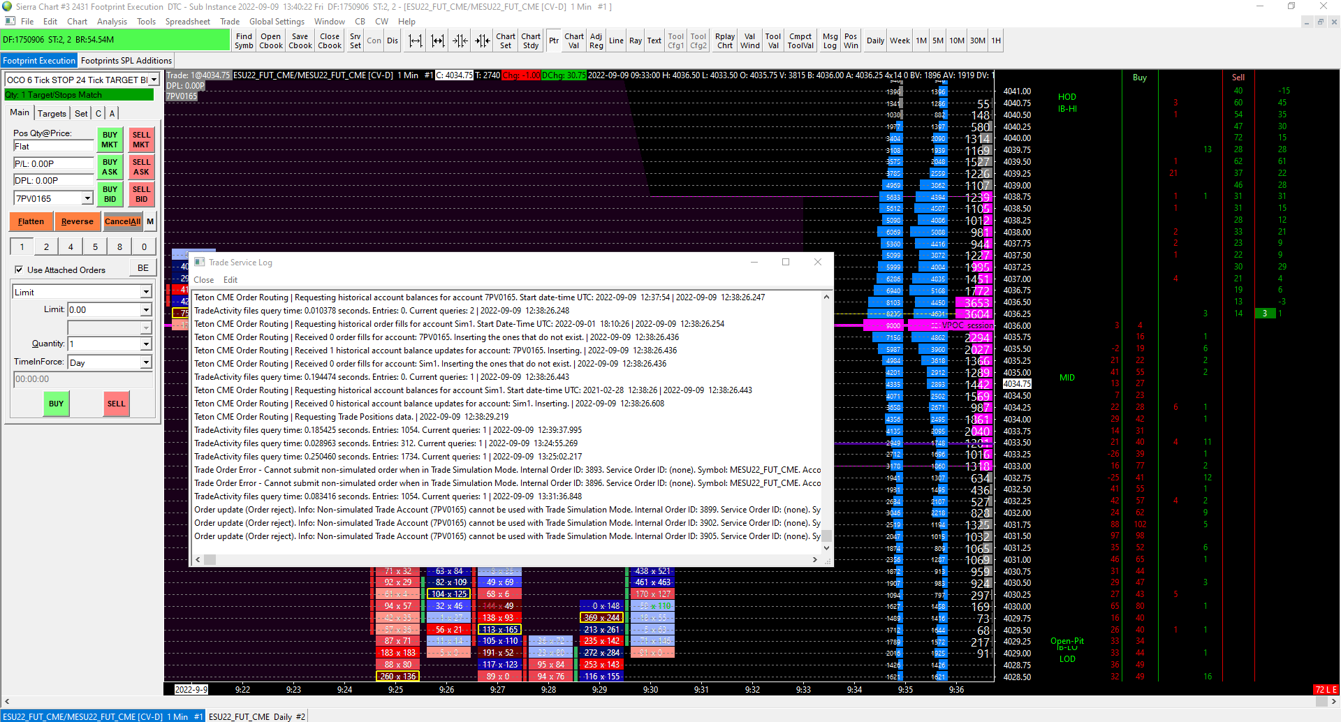

i have Teton CME order routing selected on my main instance selected.
When I go to my subinstance to try to place a trade i am getting the following error even though i have Trade Simulation Mode not selected
Not sure what is happening ?
I get two error messages in two separate monitors that are the same but slightly different (see attached)
Thank you
imagesierra trading error subinstance..PNG / V - Attached On 2022-09-09 13:43:01 UTC - Size: 208.79 KB - 213 views
[2022-09-09 16:15:54]
Sub-instances connect to the outside world through the main instance. As such, when a sub-instance is not in simulation mode, it is sending the trade information to the main instance to then send to the exchange.
Given the message you provided, it tells us that your main instance is still in Simulation mode while your sub-instance is not. In order to get the trade from the sub-instance to the exchange you need to connect your main instance to your trading service and turn off simulation mode.

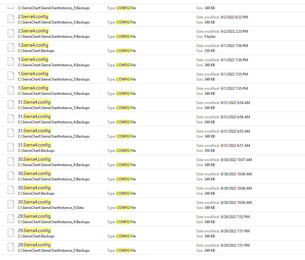

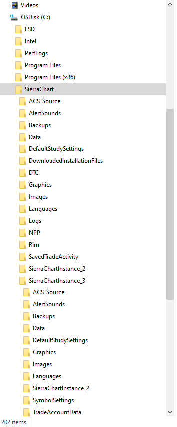

In terms of trying to retrieve my previous global settings I having some trouble.
When i search for Sierra4.config I pull up a number of files. Again the Graphics global setting were created in subinstance 3. Should i have created them in the main instance ? and could they be used in the subinstance from there ?
I believe if i go back to August 31 the settings should be the ones I am looking for (see attached). Should i try to use 31.Sierra4.config for subinstance 3 backups or the backups for the main subinstance ? I assume the former.
I am not exactly sure what to do with this file or where to put it ? (see attached) Should i just put it in the main sierra folder ? and where would i look to find those setting in the main instance or the subinstance ? Sorry I am a bit confused.
Thank you
imagesierra4 config files.PNG / V - Attached On 2022-09-12 00:19:17 UTC - Size: 86.4 KB - 220 views
imagesierra charts folders.PNG / V - Attached On 2022-09-12 00:21:27 UTC - Size: 27.85 KB - 204 views
[2022-09-12 14:42:55]
The first thing to keep in mind is that each sub-instance is its own "installation" of Sierra Chart. So you need to start with the instance on which you had the settings the way you wanted them. If that was in Sub-Instance 3, then you need to go to the folder for Sub-Instance 3 and get the Sierra4.config file from that installation. In your case, it will be in the following folder:
C:\SierraChart\SierraChartInstance_3\Backups
Then decide which particular backup file you want to try and copy and paste it to the main folder for the instance you want to try it out in. We recommend just using the main instance to make things easy. So copy it to the following folder:
C:\SierraChart
Then change the name of the existing configuration file in that folder from Sierra4.config to something like Sierra4.config.sav This just makes sure you can recover the settings are they are currently are if the other file does not work out. Then change the name of the file you just copied to be Sierra4.config (get rid of the number on the front). Then start Sierra Chart and see if this is the file you want.
If it is, then copy the Sierra4.config file from the main instance to each of your sub-instances. Each sub-instance has a folder under the main Sierra Chart installation named "SierraChartInstance_#" where # is replaced with the sub-instance number. You would copy the file to each of these folders.
If it is not the file you want, then repeat the process until you find one that has what you want.

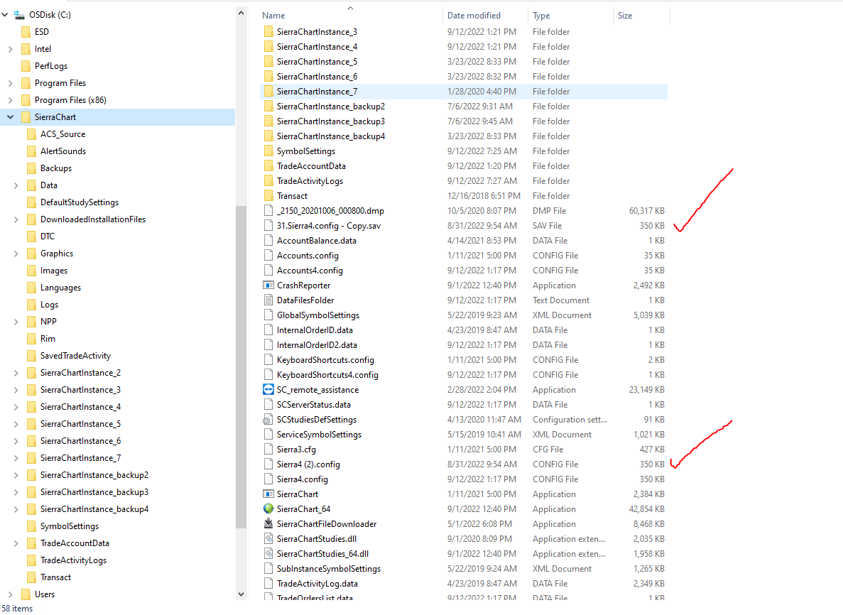

[2022-09-12 17:32:10]
I cant seem to get this to work
I am attaching the way the files appear in my File Explorer
I think I did what you are saying. I copied the Sierra4.config backup file from my subinstance and placed it in my main sierra folder which is attached.
I then copied and renamed it Sierra4.config.sav. I then removed 31. from the front and it asked me to save as Sierra4(2).config because another file was named that. I also tried to put the 31.Sierra4.config file in subinstance 3. I was not able to pull up the name of the saved graphics settings under Graphics Settings - Global either in the main instance or the subinstance. I am pretty sure that the file from this date should have the settings I am looking for.
Thank you for your help
imageSierra Charts Sierra4Config file.PNG / V - Attached On 2022-09-12 17:31:59 UTC - Size: 115.73 KB - 248 views
[2022-09-12 18:40:02]
It sounds like you did not get the replacement into the right place. From the image you provided, here are the steps you need to take. All single quotes are just to denote the filename and are not to be used (i.e. 'Sierra4.config' is meant to mean the file named Sierra4.config)
- Close Sierra Chart (if running)
- In the folder you showed in the image, rename the file named 'Sierra4.config' to 'Sierra4.config.sav'.
- In that same folder, rename the file named '31.Sierra4.config-Copy.sav' to 'Sierra4.config'.
Start Sierra Chart and see if these are the settings you want.
[2022-09-12 19:20:25]
So i made a little progress
I renamed Sierra4(2).config to Sierra4.config because this was the way I renamed the folder that i thought had the data because i did not follow what you said in the first explanation.

I copied the Sierra4.config file from my main instance into my subinstances and overwrote the old file ? I thought i did this a couple of times previously ??? maybe the file was somehow different than the one i was copying ? who knows ?
1) The only thing I am trying to retrieve without rebuilding it is my keyboard shortcuts ? they seem to be erased ? does that make sense ? or are they part of the Sierra4.config file ?
2) In the future. If I create and save a global graphics setting in my main instance, will that show up in the global graphics settings of my subinstances ? If not what is the best way to transfer that information over to the subinstance ?
Also going in reverse, what is the best way to "transfer" a global graphics setting that is saved in the subinstance to the main instance ?
Thank you
