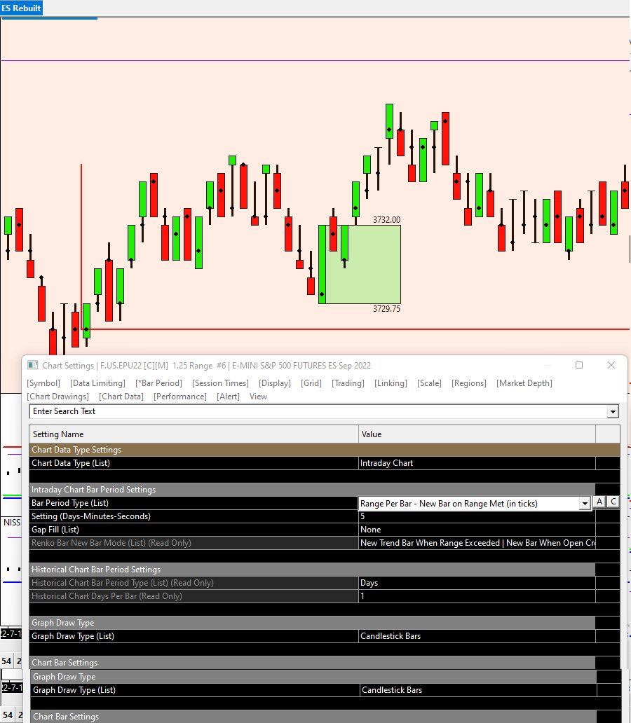

I'm using a 5 Range bar chart and there area lot bars that are more that 5 ticks.
In the example attached their is a range bar is 9 ticks.
I had tried all the various Range bat setting (Standard, True, New Bar on Range Met etc)
If I "delete and download data" it doesn't help.

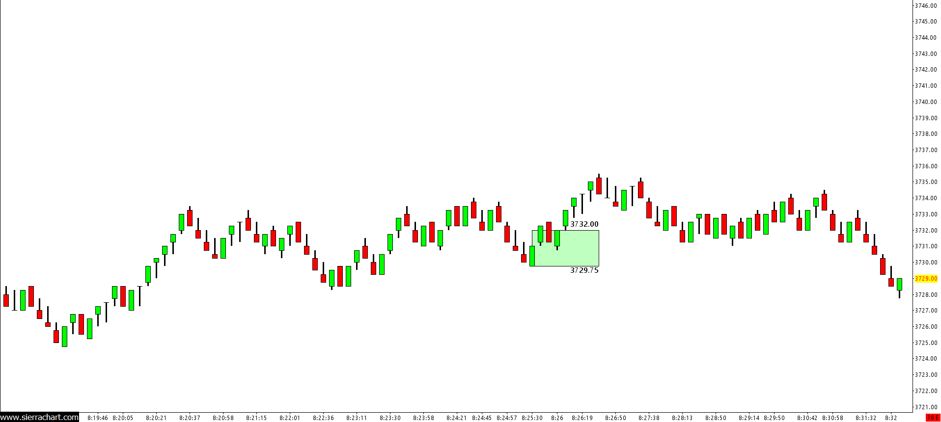

The linked image shows what we see, which is that the bars are look fine, and that particular bar is showing correctly.
https://www.sierrachart.com/image.php?Image=1657820675393.png
Have you selected Edit >> Delate All Data and Download? As opposed to selecting the option on the right-pointer click, as this will remove all data from that chart and reload it.

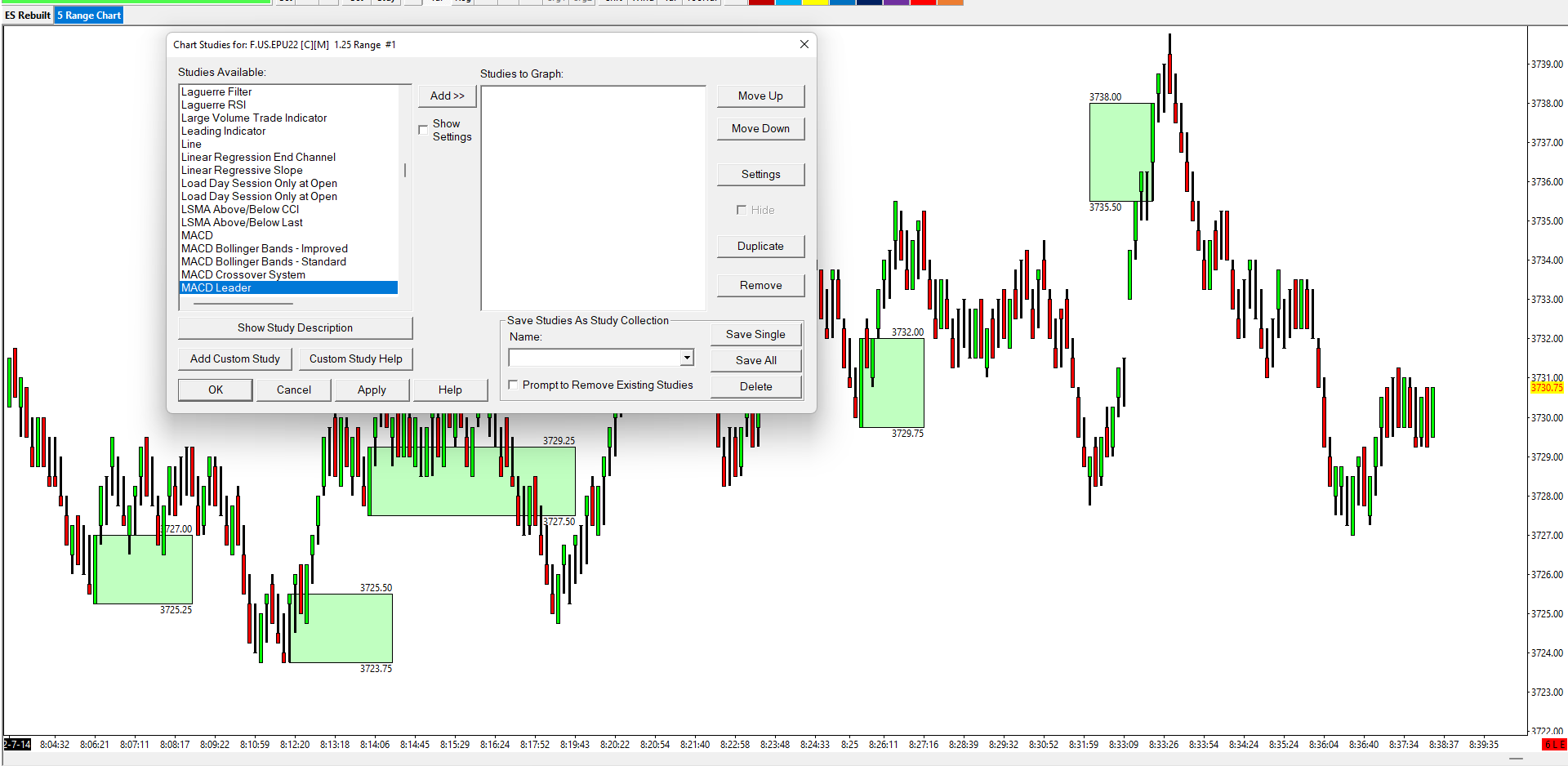

Remove all the studies from the chart and see if the reason the bar "appears" to be at 9 ticks is due to a study.

Dan the Man - Posts: 111
Hi John,
On my end I just "deleted and download data" but t did not help.
I attached a screen shot of the chart after the "delete and download data".
Regards,

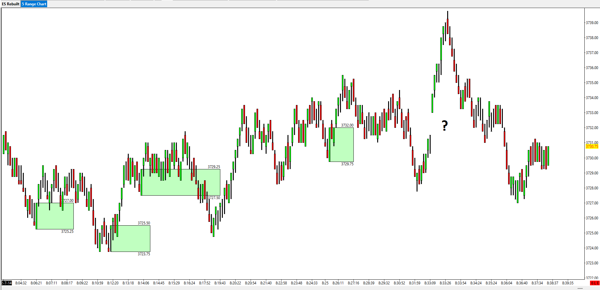

Hi John,
I looked a littler closer and found a few more 9 tick range bars on a 5 Tick range chart.
This is after I "deleted and download data"
Regards,
image5 Range Chart 1.png / V - Attached On 2022-07-14 20:21:04 UTC - Size: 83.16 KB - 514 views

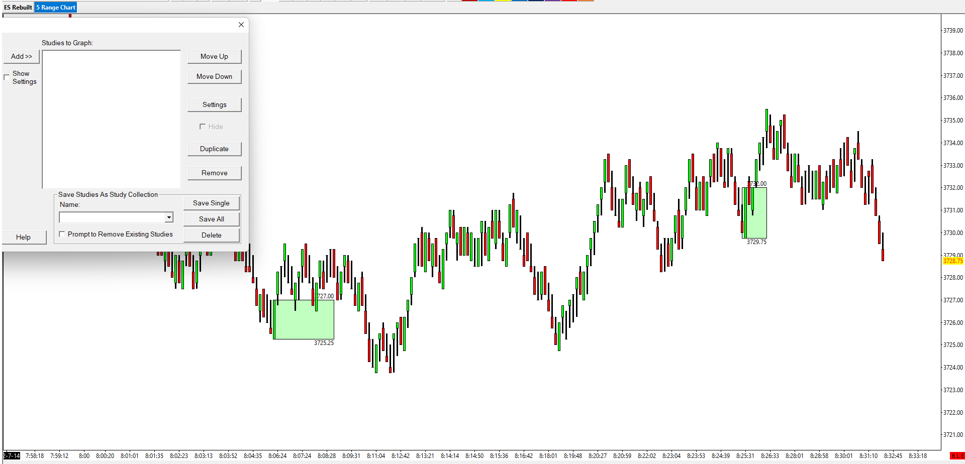

Did you remove all the studies from the chart? If you want, you can duplicate it and then remove the studies from the duplicate. We have seen this before where there is a study that is causing the bar to show further than it should.
[2022-07-14 21:03:19]
Hi John,
I did.
please attached screen shot.
Regards,

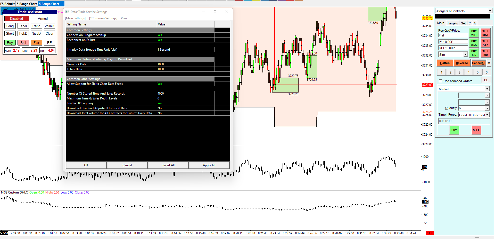

Can you please check the following setting - Global Settings >> Data/Trade Service Settings >> Common Settings >> Allow Support For Sierra Chart Data Feeds and let us know what this is set to.
[2022-07-14 21:43:45]
Its set to Yes
screen shot attached
Regards,
image5 Range Chart 3.png / V - Attached On 2022-07-14 21:43:06 UTC - Size: 112.86 KB - 422 views

Found that the Intraday Storage Time Unit was set to 1 second. Changed it to 1 tick and deleted all data and redownloaded.

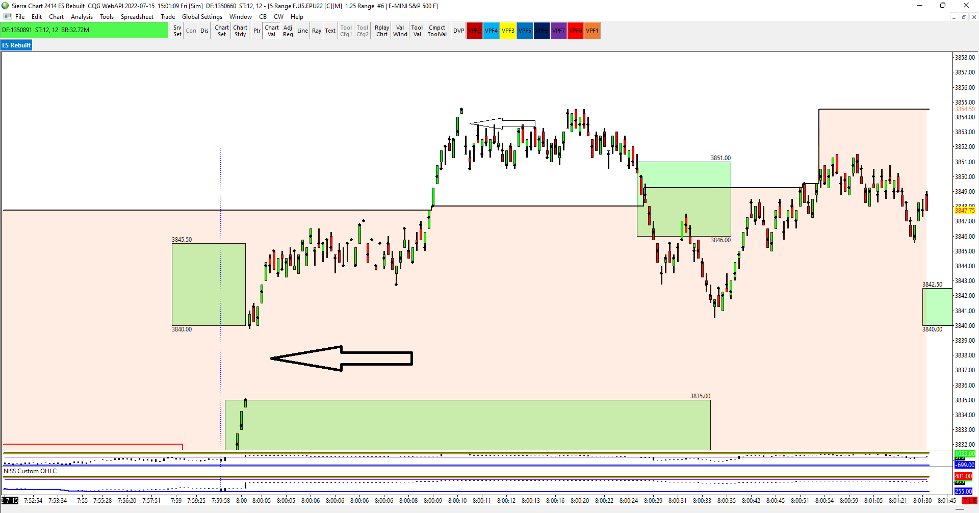

Hi John,
After Intraday Storage Time Unit was changed to 1 Tick and redownlaoded, the 5 range bars look like 5 range bars :)
But I do a few gaps.
Please see attached screen shot
Regards,
Dan
imageGaps.png / V - Attached On 2022-07-15 15:04:56 UTC - Size: 76.59 KB - 409 views
[2022-07-15 15:09:57]
That is because you are using the Range Bar - True. Refer to the information here:
Chart Settings: Range Per Bar - True (in ticks) (Chart >> Chart Settings >> Bar Period >> Intraday Chart Bar Period >> Bar Period Type
If you use the Standard Range Bar you will not have the gaps.
[2022-07-15 15:12:44]
Actually, that is not it, at least not with regards to the specific gap you are seeing. We also see that gap when using the Range Bar. In this case, it is correct, as we see the same thing. It is how the data is. If you do not want to see the gap, then you would want to use one of the Gap Fill options. Refer to the following:
Chart Settings: Gap Fill (Chart >> Chart Settings >> Bar Period >> Intraday Chart Bar Period Settings)
