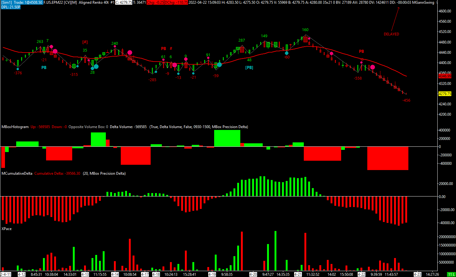

Hello, I have a Delay of 4 seconds on my Data. Can you please help me we that? I have other users here that are using the same Data on their laptops, but I'm the only one with the delay. https://www.sierrachart.com/image.php?Image=1650654544598.png Thank you, |
| [2022-04-22 21:10:38] |
| John - SC Support - Posts: 48527 |
Most likely that is just a difference in the time of our server and the time of your local computer. Any difference will show up as a delay, although it is not a real delay. Check your Message Log (Windows >> Message Log) and look for a line at the top that starts with Local Computer UTC Time and Server UTC Time Difference. Most likely this is going to report a 3 or 4 second time difference. If you want to synchronize your computer clock with our servers then refer to the following: Global Settings Menu: Set System Date-Time from Server (Global Settings menu) For the most reliable, advanced, and zero cost futures order routing, use the Teton service: Sierra Chart Teton Futures Order Routing |

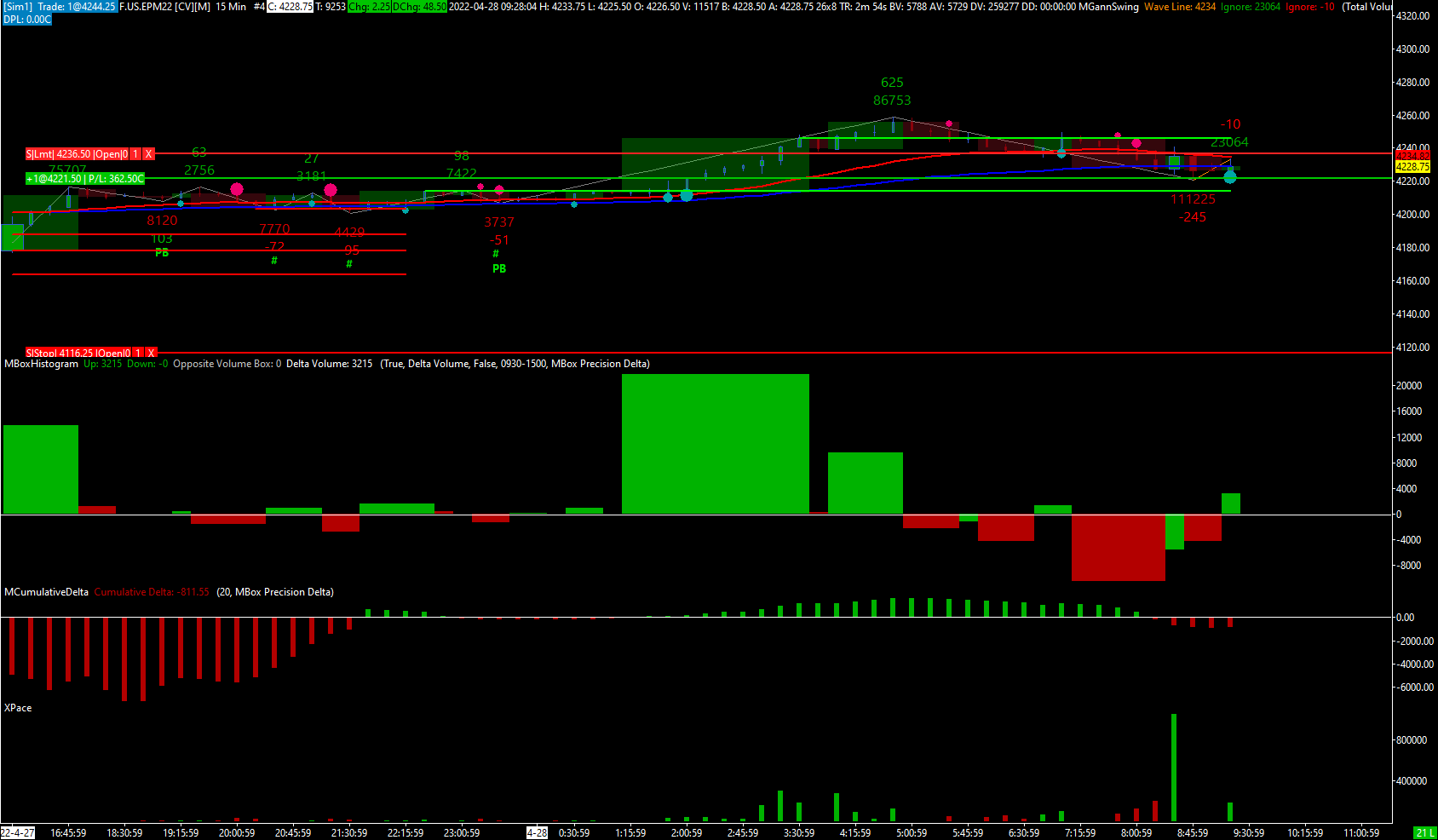

Hello, This morning I turned my laptop on to find myself in a trade. My laptop is completely turned off every night with Sierra Chart closed. I also had the same issue yesterday during the day on my laptop and my husband's laptop, we had just come off a trade when the system kicked us both back in at the same time for a trade automatically. Below is a screen shot of this mornings trade as soon as my laptop was turned on prior to the start of the market New York time. Thanks. https://www.sierrachart.com/image.php?Image=1651152486864.png |
| [2022-04-28 15:30:50] |
So that position that you see is not something that you intended?

No. This was there as soon as I turned my laptop on this morning before the start of the market.
| [2022-04-28 16:36:27] |
We need to know the origin of that order. Refer to the information here to determine this: Trade Activity Log Analysis: Determining the Origin of a New/Modified Order Sierra Chart Support - Engineering Level Your definitive source for support. Other responses are from users. Try to keep your questions brief and to the point. Be aware of support policy: https://www.sierrachart.com/index.php?l=PostingInformation.php#GeneralInformation For the most reliable, advanced, and zero cost futures order routing, *change* to the Teton service: Sierra Chart Teton Futures Order Routing |

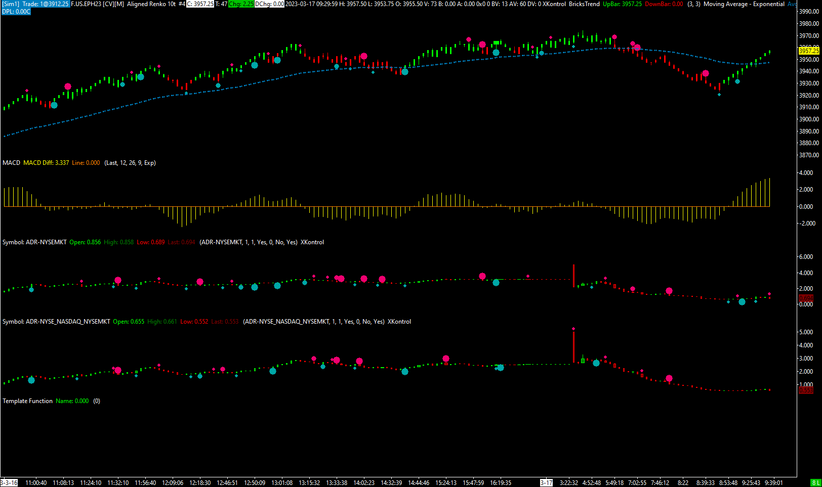

Hi, Here is the program in C++. My problem is that it shows no graph on my chart. I will try to send a screen shot of what I see when I add this to my custom study for your reference. #include <sierrachart.h> SCDLLName("Moving Average Strategy") // Set the values of the moving average period and the buy/sell threshold SCSFExport scsf_MovingAverageStrategy(SCStudyInterfaceRef sc) { SCInputRef movingAverageLength = sc.Input[0]; SCInputRef buyThreshold = sc.Input[1]; SCInputRef sellThreshold = sc.Input[2]; SCInputRef shares = sc.Input[3]; // Set the data series for the close price SCSubgraphRef close = sc.Subgraph[0]; close.Name = "Close"; close.DrawStyle = DRAWSTYLE_LINE; sc.Input[0].SetInputDataIndex(SC_LAST); // Create a subgraph for the moving average SCSubgraphRef movingAverage = sc.Subgraph[1]; movingAverage.Name = "Moving Average"; movingAverage.DrawStyle = DRAWSTYLE_LINE; // Set the moving average length sc.MovingAverage(sc.Close, movingAverage, MOVAVGTYPE_SIMPLE, movingAverageLength.GetInt()); // Initialize the position to flat int currentPosition = 0; // Loop through the chart data for (int i = sc.UpdateStartIndex; i < sc.ArraySize; i++) { // Check if the price has crossed above the moving average by the buy threshold if (close > movingAverage && close[i-1] <= movingAverage[i-1] - buyThreshold.GetFloat()) { // Enter a long position sc.BuyEntry(i, shares.GetInt()); // Set the current position to long currentPosition = 1; } // Check if the price has crossed below the moving average by the sell threshold else if (close < movingAverage && close[i-1] >= movingAverage[i-1] + sellThreshold.GetFloat()) { // Enter a short position sc.SellEntry(i, shares.GetInt()); // Set the current position to short currentPosition = -1; } // Check if the current position is long and the price has crossed below the moving average else if (currentPosition == 1 && close < movingAverage) { // Exit the long position sc.SellEntry(i, shares.GetInt()); // Set the current position to flat currentPosition = 0; } // Check if the current position is short and the price has crossed above the moving average else if (currentPosition == -1 && close > movingAverage) { // Exit the short position sc.BuyEntry(i, shares.GetInt()); // Set the current position to flat currentPosition = 0; } } } https://www.sierrachart.com/image.php?Image=1679597300708.png |
| [2023-03-23 19:00:06] |
| User352781 - Posts: 27 |
When you open the screen shot of the Chart you will notice at the bottom of chart ( Template Function Name: 0.000 (0) ) this is generated by the program, but no graph or inputs of any source. Is data automatically generated into the study? or do we have to enable an option for that to take place?? |
| [2023-03-28 13:40:59] |
Hello, Just wondering if you have an update for me. Thank you. |
| [2023-03-28 14:45:41] |
| Sierra_Chart Engineering - Posts: 25425 |
The study code given in post #19, is not a proper ACSIL function. One obvious thing is that is missing an sc.SetDefaults code block. Step 17 shows what a function should look like: Advanced Custom Study Interface and Language (ACSIL): Step-By-Step Instructions to Create an Advanced Custom Study Function Your function uses manual looping so it needs sc.AutoLoop = 0; Sierra Chart Support - Engineering Level Your definitive source for support. Other responses are from users. Try to keep your questions brief and to the point. Be aware of support policy: https://www.sierrachart.com/index.php?l=PostingInformation.php#GeneralInformation For the most reliable, advanced, and zero cost futures order routing, use the Teton service: Sierra Chart Teton Futures Order Routing |
