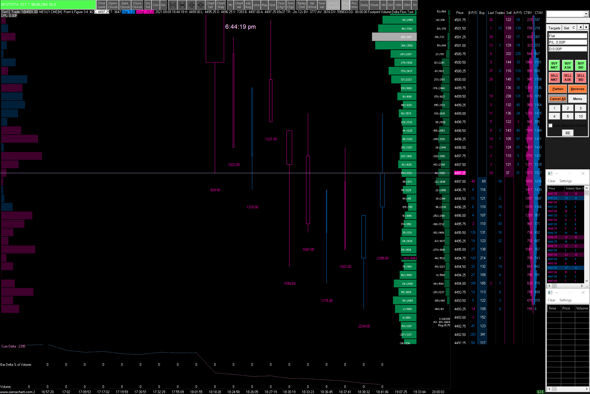

| Colin Simpson - Posts: 9 |
http://www.sierrachart.com/image.php?Image=1631209460834.png I should have delta bars one side of the candle and volume bars the other side, also bar delta % of volume and volume under the main chart. Thanks |

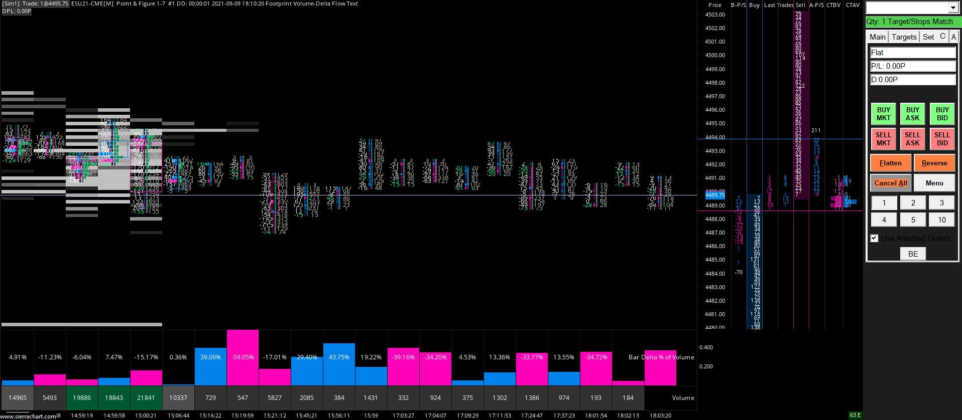

Everything looks good in the Chartbook we received. Here is an image of what we see: http://www.sierrachart.com/image.php?Image=1631229024591.png If you open that Chartbook yourself, do you get the data showing, or is it also missing the data as shown in the image you provided? For the most reliable, advanced, and zero cost futures order routing, use the Teton service: Sierra Chart Teton Futures Order Routing |

The image that you sent is what its supposed to look like but the one i sent you is what i get. Why is that, have i connected Rithmic properly and how does Denali feed in to all this. Everything worked fine when CQG was the only data provider but when ive made the swap this problem occurred.
