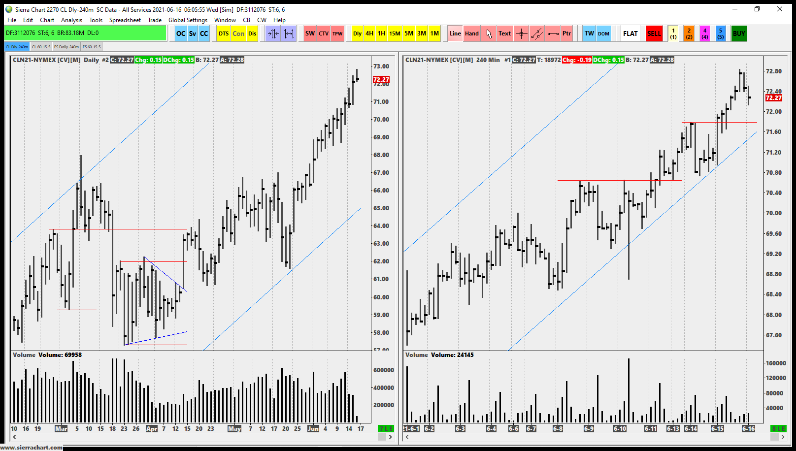

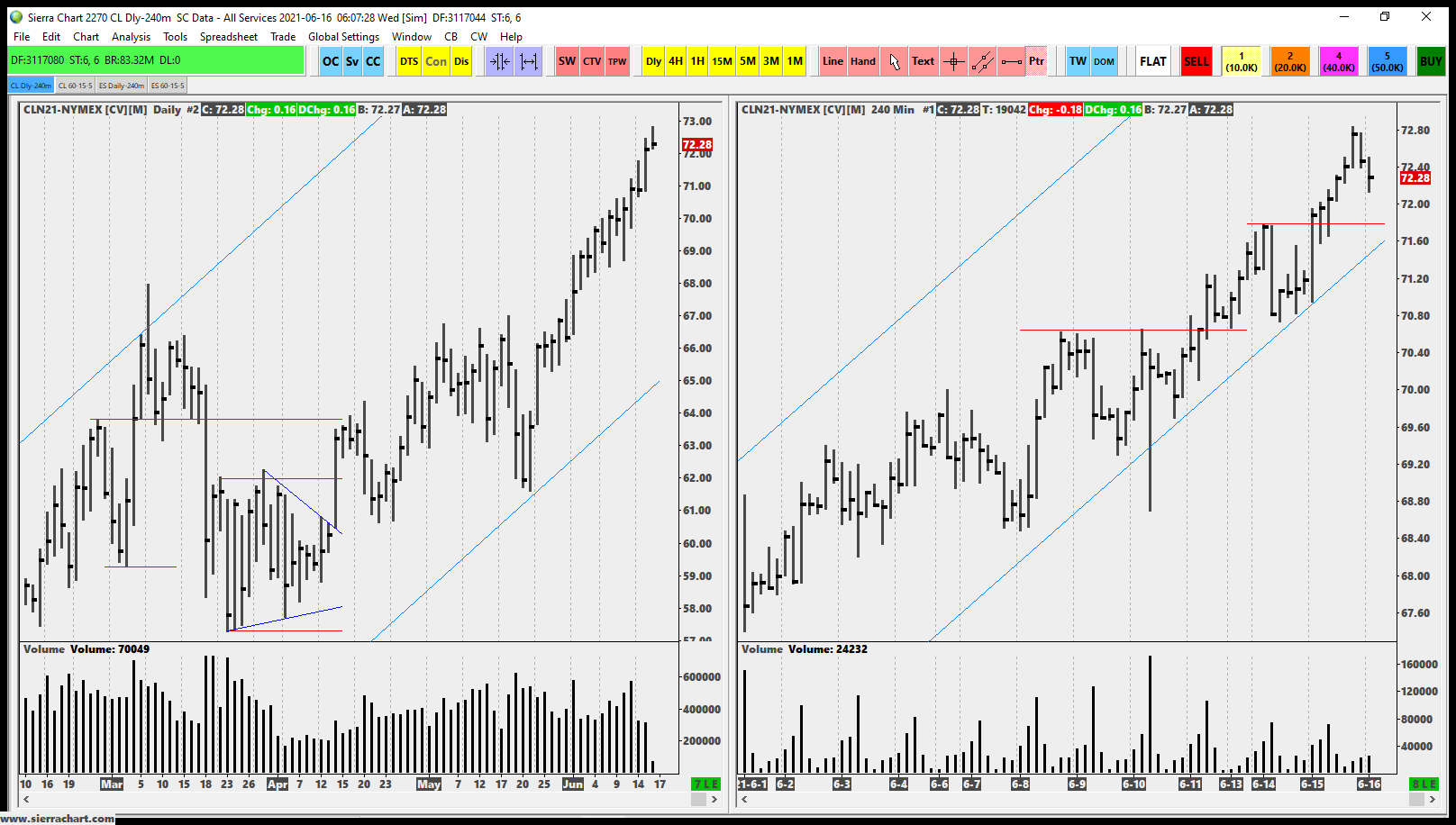

Version 2270, I have 4 chartbooks up, 2 with CL and 2 with ES. Daily/240 minute in 1 chartbook & 60-15-5 minute in the other chartbook for both symbols. Only on the CL Daily/420 minute when I right click on the chart my narrow control bar buttons actually get wider than the other buttons on both CL chartbooks. Sometimes just going from the ES chartbook to the CL chartbook will cause the buttons to get bigger. This does not happen with the 2 ES chartbooks. I have to go to the CL 60-15-5 minute chart and right click on the 5 minute chart and the buttons will sometimes change back, if not I can select one of the drawing tools and then the buttons go back to the smaller size on both CL chartbooks. The only smaller buttons are order quantity buttons.

imageSierra Chart MainWindow 2021-06-16 06_07_26.565.png / V - Attached On 2021-06-16 11:09:13 UTC - Size: 68.13 KB - 513 views
imageSierra Chart MainWindow 2021-06-16 06_05_53.379.png / V - Attached On 2021-06-16 11:09:35 UTC - Size: 67.17 KB - 533 views

The reason for the changes in the Control Bar Buttons is due to the addition of the Quantity values for the Quantity buttons associated with the Trading Window. You will see the values change from (1), (2), (4), (5) to (10.00C), (20.00C), (40.00C), (50.00C).

The quantity buttons were changed a few months ago to show the actual Quantity values associated with the buttons. In the images you provided, the numbers were (1) for one situation and (10.00C) for the another. That is why the difference in the sizes.

What we are seeing is that the buttons change when you change between the Charts, as each chart has its own Trading Window with different values set for the Quantity Buttons.
In particular, you have values of [1; 2; 3; 4; 5; 6] for your quantity buttons for the ESU21-CME chart, but you have values of [10,000; 20,000; 30,000; 40,000; 50,000; 60,000] for the CLN21-NYMEX chart.
The reason why it happens when you click in the window, from what we see, is simply because you have your windows floating, therefore when you click in the chart window, you are then changing the chart to that one and then the quantities are updating for that change in the chart.

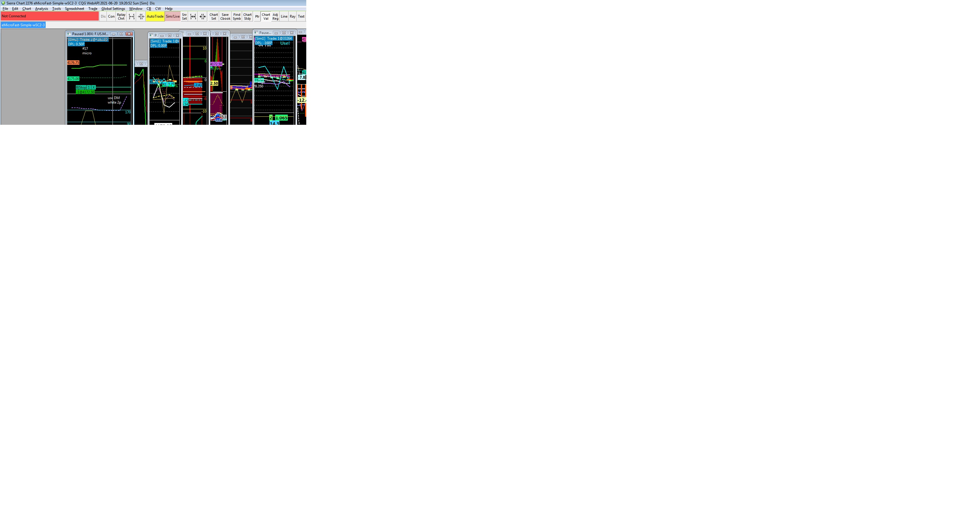

V2076 - Did the ability to adjust (customize) width of Status in Control Bar1 .. go away?
Connection status is unnecessarily huge. See the top of my Chartbook (attached).
That's over twice too wide, messing up my layout from V1991.
I recall V1991 allowed standard drag of edge to resize that? Surely that flexibility has not gone away?
For many reasons, my chartbook spans onto 3 monitors (each in portait,for needed height), the center monitor having most of the CB.
Each side of CB flows about 8 centimeters onto Monitors 1 and 3. (One important chart on each side monitor).
Adjusting the Status bar allowed me to precisely position most buttons onto the center monitor.
imageSC-ControlBar-WidthCantAdjust.jpg / V - Attached On 2021-06-21 00:38:34 UTC - Size: 253.24 KB - 460 views

John - SC Support - Posts: 48504
Refer to the following:
General Settings Window: Status Bar Width in Characters (Global Settings >> General Settings >> GUI >> Application GUI)
