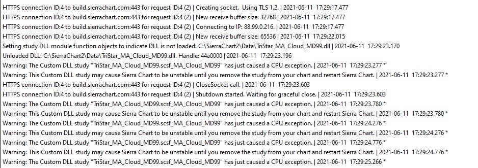

About a week ago or so I started getting the error "caused a CPU exception" when compiling a custom study that is in use. I am using Notepad++ ver 7.8.2 and am on SC 2268. I tried compiling my oldest and most trustworthy study without code changes and I get the same error so I'm wondering if it's not anything in the code? Maybe somehwere in the development configuration? Have you heard from anyone else about this? I didn't see anything in the Support Board. Any help is appreciated. Thanks! Mike

I was thinking code problems also but it happens on any cpp I attempt to compile when the study is in use. If I do get the error I only have to remove the study, hit apply, and re-add the study to get the error to go away. Notepad++ ver 7.8.2 and am now on SC 2270. No one else has said anything huh? Then it must just be me, but it happens on ALL of my cpp's with the study in use. Evenn ones I have been using for years. Anyone? Any ideas? Thanks, Mike

You have us a bit confused. Does this problem only occur when you have a study on the chart and then you recompile it? So it's only when the recompilation is complete?

Yes sir. Exactly. If you can't duplicate the error then I would know for sure it was somewhere on my end. Attached is a very simple cpp I have been testing with.

Yes, The release and allow load works fine. Also, I have a second installation (not an instance) of SC on this PC. The same CPU error is occuring there. Same NotePad++ and SC version numbers. Both installations are behaving the same way as to teh error and as to the workaround of release and load DLL's. Message log attached. Seems ok from your end.
Since version 2268 does the sc.LastCallToFunction. Maybe something there?
Date Time Of Last Edit: 2021-06-13 23:21:04
imageCPU Error on rebuild.jpg / V - Attached On 2021-06-11 22:31:12 UTC - Size: 163.33 KB - 284 views

Program path: C:\SierraChart\ | 2021-06-14 11:52:04.309
Data Files path: C:\SierraChart\Data\ | 2021-06-14 11:52:04.309
OS Version Number: 10.0 | 2021-06-14 11:52:04.310
Locale Setting: C | 2021-06-14 11:52:04.310
DLLs: ETFISv3_64.dll, sst_FreeBundle_64.dll, TriStar_BaseDataAccess_MD99_64.dll, TriStar_DeltaAudioAlerts_MD99_64.dll, TriStar_DojiBar_MD99_64.dll, TriStar_ExtDeltaDifSignals_MD99_64.dll, TriStar_FlexRenkoPredictor_MD99_64.dll, TriStar_FL_BarColor_MD99_64.dll, TriStar_FL_Bolic_MD99_64.dll, TriStar_FL_Parabolic_MD99_64.dll, TriStar_FL_VS_FlipZone_MD99_64.dll, TriStar_FL_VS_MD99_64.dll, TriStar_FoMRelVol_MD99_64.dll, TriStar_FootprintAudioAlerts_MD99_64.dll, TriStar_FP_Parabolic_MD99_64.dll, TriStar_FuseLines_MD99_64.dll | 2021-06-14 11:52:04.310
Allowed protected custom studies: SST_FreeBundle, zyp_download_free | 2021-06-14 11:52:04.310
HTTPS connection ID:7 to build.sierrachart.com:443 for request ID:7 (2) | Creating socket. Using TLS 1.2. | 2021-06-14 11:52:16.478
HTTPS connection ID:7 to build.sierrachart.com:443 for request ID:7 (2) | New receive buffer size: 32768 | 2021-06-14 11:52:16.478
HTTPS connection ID:7 to build.sierrachart.com:443 for request ID:7 (2) | Connecting to IP: 88.99.0.216. | 2021-06-14 11:52:16.478
HTTPS connection ID:7 to build.sierrachart.com:443 for request ID:7 (2) | New receive buffer size: 65536 | 2021-06-14 11:52:21.077
HTTPS connection ID:7 to build.sierrachart.com:443 for request ID:7 (2) | New receive buffer size: 131072 | 2021-06-14 11:52:22.185
Setting study DLL module function objects to indicate DLL is not loaded: C:\SierraChart\Data\TriStar_MA_Cloud_MD99.dll | 2021-06-14 11:52:22.244
Unloaded DLL: C:\SierraChart\Data\TriStar_MA_Cloud_MD99.dll. Handle: 2560000 | 2021-06-14 11:52:22.269
Warning: The Custom DLL study "TriStar_MA_Cloud_MD99.scsf_MA_Cloud_MD99" has just caused a CPU exception. | 2021-06-14 11:52:22.279 *
Warning: This Custom DLL study may cause Sierra Chart to be unstable until you remove the study from your chart and restart Sierra Chart. | 2021-06-14 11:52:22.279 *
HTTPS connection ID:7 to build.sierrachart.com:443 for request ID:7 (2) | CloseSocket call. | 2021-06-14 11:52:22.517
HTTPS connection ID:7 to build.sierrachart.com:443 for request ID:7 (2) | Shutdown started. Waiting for graceful close. | 2021-06-14 11:52:22.517
Warning: The Custom DLL study "TriStar_MA_Cloud_MD99.scsf_MA_Cloud_MD99" has just caused a CPU exception. | 2021-06-14 11:52:22.768 *
Warning: This Custom DLL study may cause Sierra Chart to be unstable until you remove the study from your chart and restart Sierra Chart. | 2021-06-14 11:52:22.768 *
Warning: The Custom DLL study "TriStar_MA_Cloud_MD99.scsf_MA_Cloud_MD99" has just caused a CPU exception. | 2021-06-14 11:52:23.269 *
Warning: This Custom DLL study may cause Sierra Chart to be unstable until you remove the study from your chart and restart Sierra Chart. | 2021-06-14 11:52:23.269 *
Warning: The Custom DLL study "TriStar_MA_Cloud_MD99.scsf_MA_Cloud_MD99" has just caused a CPU exception. | 2021-06-14 11:52:23.768 *
Warning: This Custom DLL study may cause Sierra Chart to be unstable until you remove the study from your chart and restart Sierra Chart. | 2021-06-14 11:52:23.768 *
Warning: The Custom DLL study "TriStar_MA_Cloud_MD99.scsf_MA_Cloud_MD99" has just caused a CPU exception. | 2021-06-14 11:52:24.271 *
Warning: This Custom DLL study may cause Sierra Chart to be unstable until you remove the study from your chart and restart Sierra Chart. | 2021-06-14 11:52:24.271 *
Warning: The Custom DLL study "TriStar_MA_Cloud_MD99.scsf_MA_Cloud_MD99" has just caused a CPU exception. | 2021-06-14 11:52:24.768 *
Warning: This Custom DLL study may cause Sierra Chart to be unstable until you remove the study from your chart and restart Sierra Chart. | 2021-06-14 11:52:24.768 *
Warning: The Custom DLL study "TriStar_MA_Cloud_MD99.scsf_MA_Cloud_MD99" has just caused a CPU exception. | 2021-06-14 11:52:25.268 *
Warning: This Custom DLL study may cause Sierra Chart to be unstable until you remove the study from your chart and restart Sierra Chart. | 2021-06-14 11:52:25.268 *
Warning: The Custom DLL study "TriStar_MA_Cloud_MD99.scsf_MA_Cloud_MD99" has just caused a CPU exception. | 2021-06-14 11:52:25.771 *
Warning: This Custom DLL study may cause Sierra Chart to be unstable until you remove the study from your chart and restart Sierra Chart. | 2021-06-14 11:52:25.771 *
Warning: The Custom DLL study "TriStar_MA_Cloud_MD99.scsf_MA_Cloud_MD99" has just caused a CPU exception. | 2021-06-14 11:52:26.269 *
Warning: This Custom DLL study may cause Sierra Chart to be unstable until you remove the study from your chart and restart Sierra Chart. | 2021-06-14 11:52:26.269 *

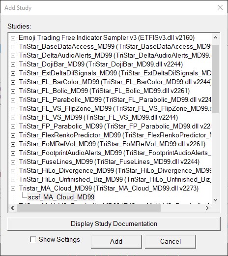

The I remove the study from the chart which stops the CPU Exception error. When I add back the study to the chart there is no exception error.
One time when adding back I got the second attachemnt but I can't seem to reproduce.
Hope this helps and THANKS! I see your name everywhere in this forum John. You must be the resident expert. :) Let me know should you need anything else.
Mike
