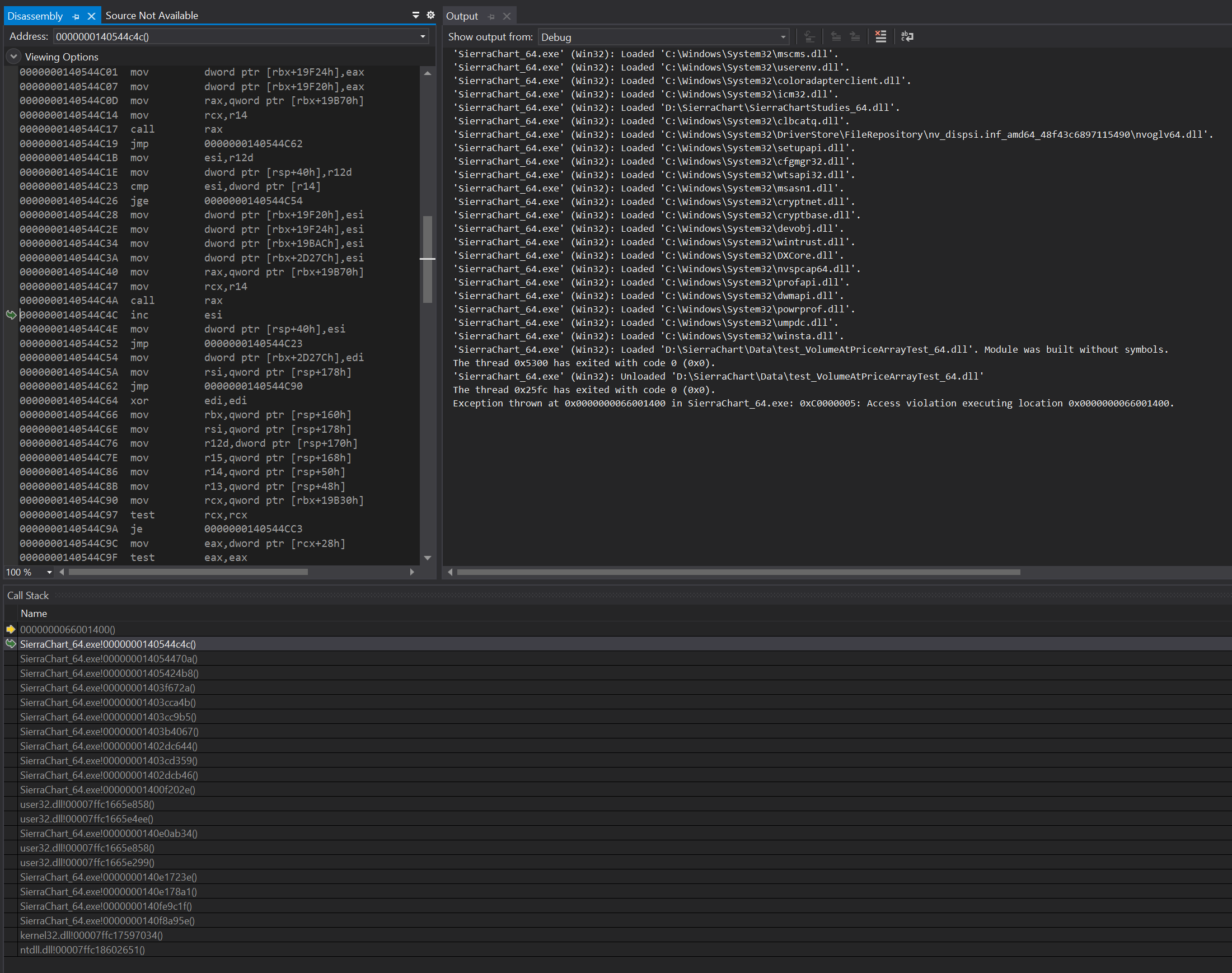

I believe I have a repro for this crash that I discovered when building a study that uses sc.MaintainVolumeAtPriceData = 1;
Repro steps:
put scsf_VolumeAtPriceArrayTest() found in Studies8.cpp into its own file and give it a SCDLLName().
Use the build dialog and select and Remote Build this file.
Add this study to a chart; I used a 1min ES chart.
Save chartbook.
-this works ok-
Build the study again while leaving the chart open.
Sierra unloads the dll and reloads it after building it.
Hit INSERT to rebuild the chart.
--> access violation, message in error log that study caused AV and Sierra is unstable.
Studies that do not use sc.MaintainVolumeAtPriceData = 1; do not experience this behavior in my observations thus far.
If you connect VS debugger to Sierra, you get the following information in the attached image.
WORKAROUND1: close all chartbooks, Remote Build, reopen chartbook(s).
WORKAROUND2: close all chartbooks, Release All Dlls, build locally, Allow Load DLLs, reopen chartbook(s).
Thanks,
Kory
imageSierraCrash.png / V - Attached On 2021-06-12 04:33:03 UTC - Size: 219.43 KB - 320 views

We still have not identified the exact problem other than we know it is related to calling the study function and setting this to true just before the DLL is unloaded:
ACSIL Interface Members - Variables and Arrays: sc.LastCallToFunction
We still need more time to look into it.
