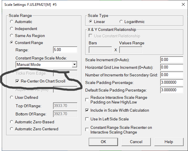

[2021-04-22 14:35:58]
User337568 - Posts: 65
I am having a scroll wheel issue in the DOM.
I can re-center the DOM with a keyboard hotkey.
I have enabled the scroll, and I am on manual.
I don't use autoscale because I experience errant limit orders on DOM.
Thank you for your help
image2021-04-22_9-24-33.png / V - Attached On 2021-04-22 14:31:23 UTC - Size: 43.69 KB - 362 views
[2021-04-22 14:43:11]
John - SC Support - Posts: 48196
What exactly is the problem you are having?
[2021-04-22 15:21:23]
The wheel scroll is not working although I have it set to the wheel scroll.
I am not sure why it stopped working
[2021-04-22 15:39:45]
So when you use the scroll wheel the chart is not moving? Or when the chart moves, the Price Ladder is not adjusting?
If the chart is not moving, then you need to change the Scroll Wheel settings as defined here:
General Settings Window: Scroll Wheel (Global Settings >> General Settings >> GUI >> Scroll)
[2021-04-22 18:11:13]
User error. I had Interactive Scale Locked and when switched to Interactive Move the scroll wheel started working.
