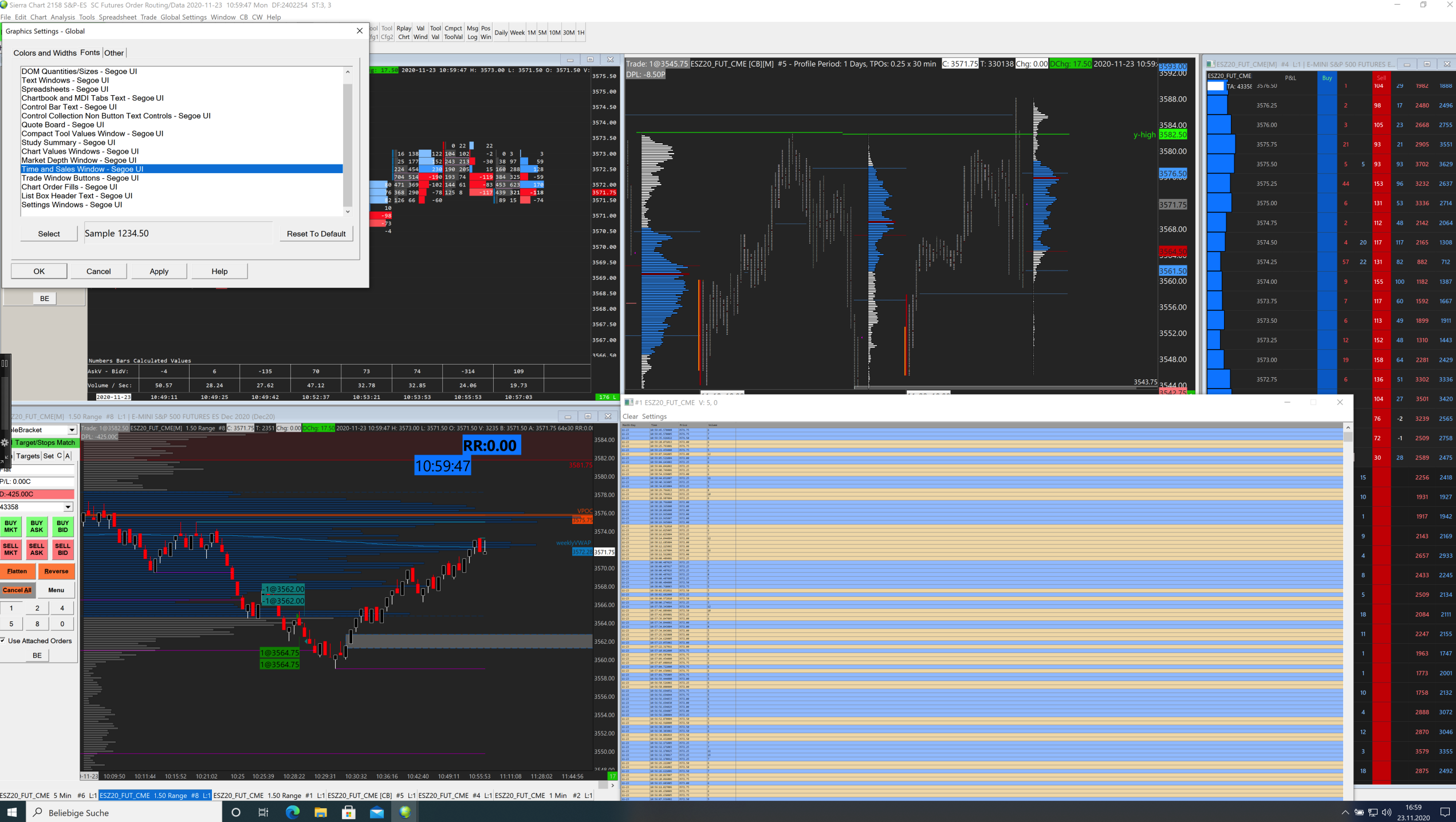

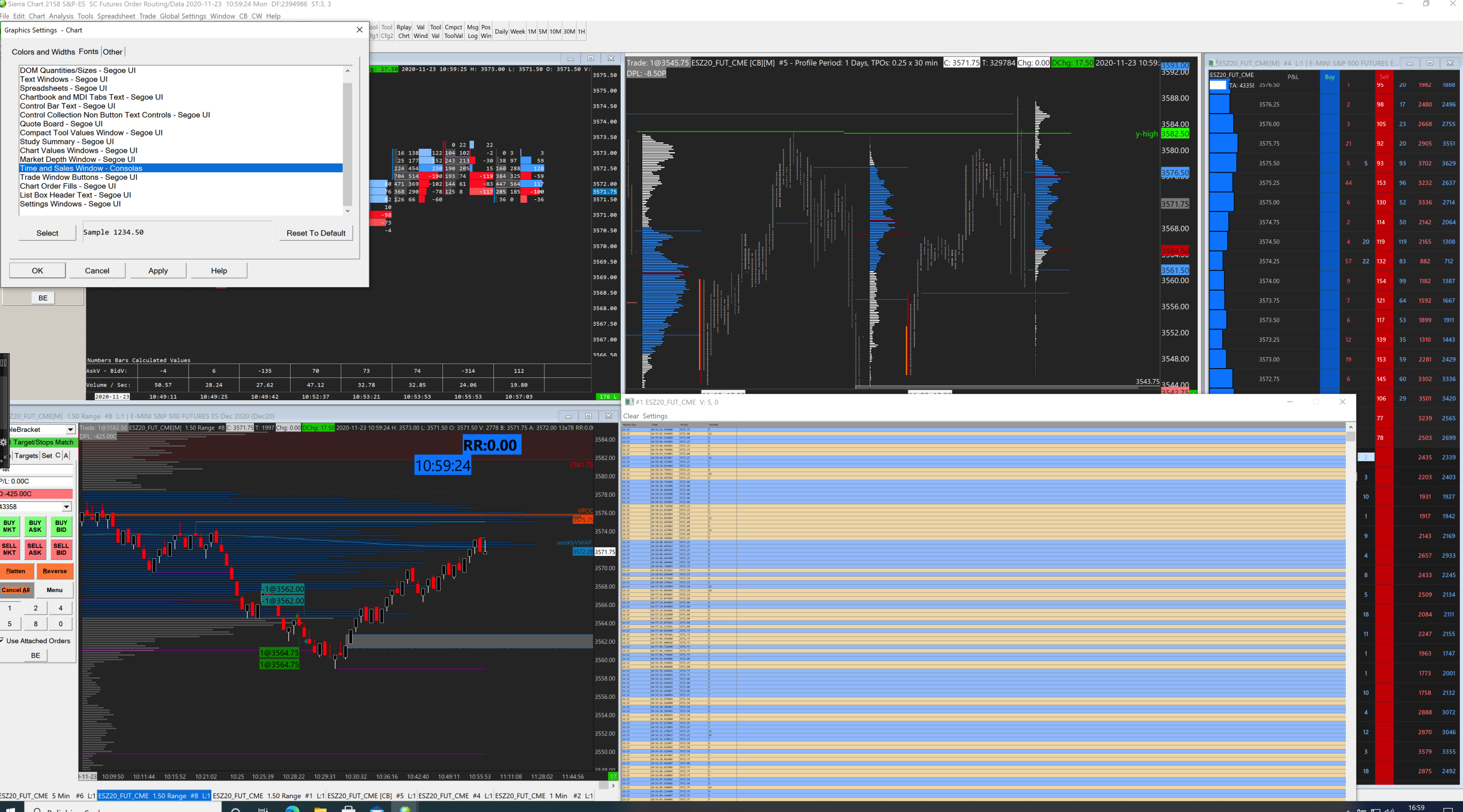

Good Day,
I did not find how to change Font in the Times and Sales.
Id did both- via Chart and Chart Settings and via Global Settings.
Attached you see ScreenShots.
Any Ideas?
THX for help
imageScreenshot at Nov 23 16-59-32.png / V - Attached On 2020-11-23 17:15:12 UTC - Size: 813.23 KB - 739 views
imageScreenshot at Nov 23 16-59-53.png / V - Attached On 2020-11-23 17:15:19 UTC - Size: 844.14 KB - 499 views

Global Settings -> Graphics Settings -> then select Font Tab -> about 13 lines down is "Time and Sales Window" with current font after it.
JohnR/quote]
John R as postet this is what I did but the sample Font I changed is much bigger than the actual one- I did attach the screenshot to show this.Any Ideas?

032400mS## - Posts: 8
Sierra Chart Engineering this is exactly what I did, see Screenshots, but it did not help. I updated all Fonts but neither changed the Times and Sales list- see attached Screenshots.
Would appreciate an answer that is not standard but that solves my problem.
Thank you
