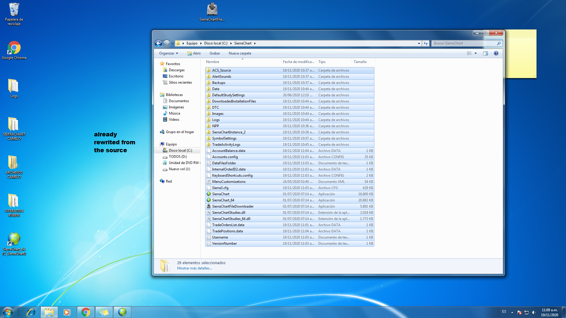

First, refer to the information at the following link regarding what files you should copy when you have a new installation. Make sure you copied all of these files:
Transferring Sierra Chart Settings and Data From Existing Installation to New Installation: Transferring Sierra Chart Settings and Data From Existing Installation to New Installation
Second, if you are referring to chartbooks that automatically open, then that information is contained in the sierra3.cfg file. Again, make sure it has been copied over.

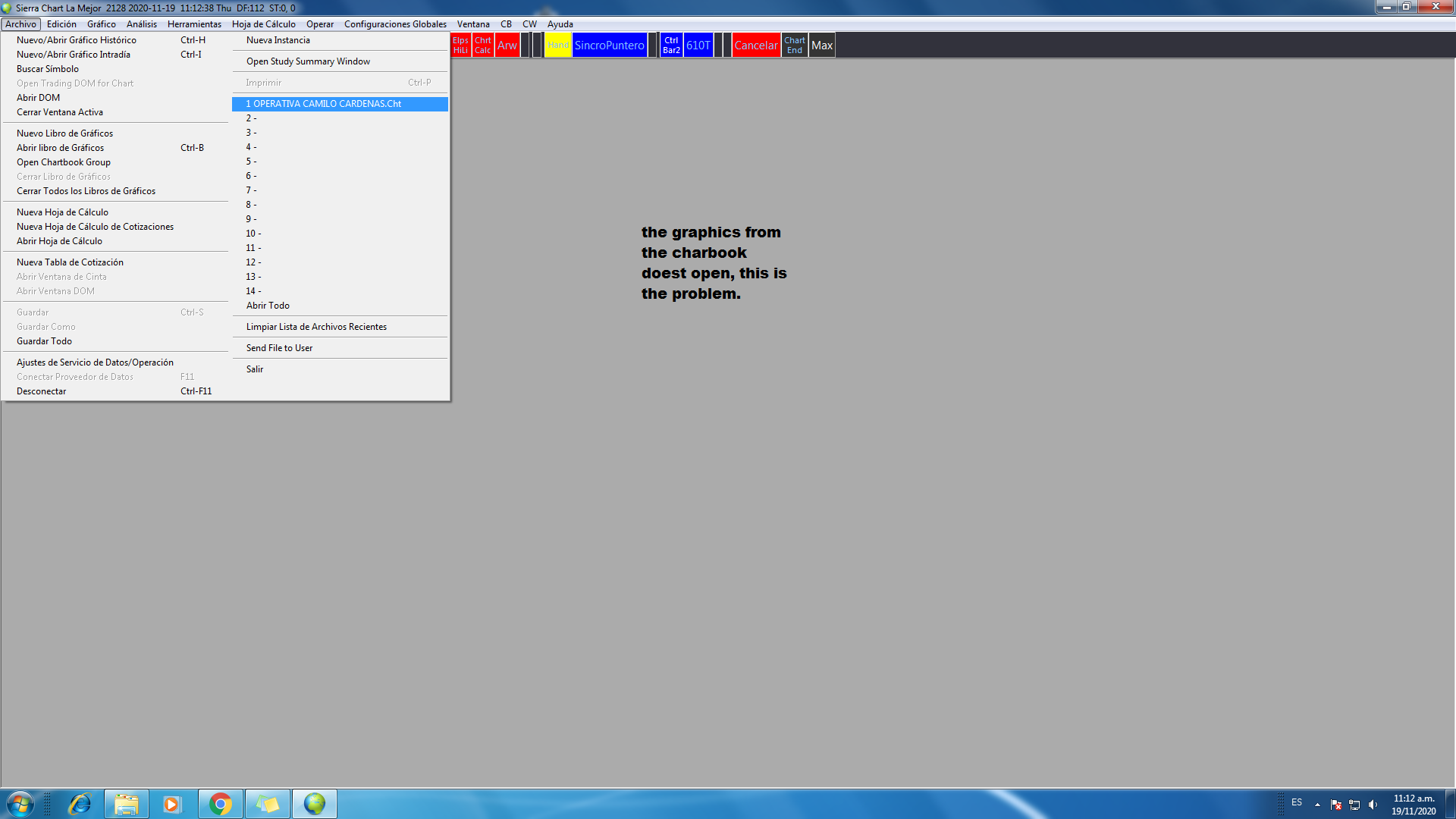

el problema es que y copie toda la carpeta de sierrachart con todos los archivos en el nuevo computador aaa usar, actulmente me carga toda la interfaz pero una vez que quiero abrir mi charbook las graficas del charbook no me abren, a continuacion envio fotos del problema

Since you copied the entire folder, your Data Files Folder is probably not pointing to the correct location. Make sure that the following setting is pointing to the correct Data folder for the new installation:
General Settings Window: Data Files Folder (Global Settings >> General Settings >> Paths >> Files and Folder Paths)
Also, clear the Recently Used list and instead open a chartbook from the Open Chartbook menu item. The Recently Used list is from your previous installation and may be referencing a folder that does not exist in this new setup. Refer to the following:
File Menu: Clear Recent File List (File)
And also refer to the following for how to open a Chartbook:
File Menu: Open Chartbook (File)

Please give us a screenshot of what you see after you have selected Open Chartbook and selected the specific chartbook to open.
