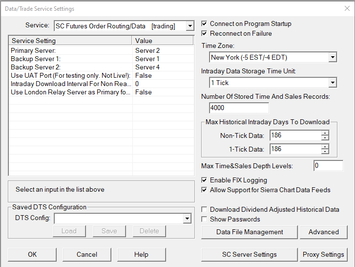

Hello, today I was trading the ESZ contract and I had a long trade on with sell stop and sell limit bracket orders.
The platform suddenly froze, and when I relaunched it, the position was down 5 points and the stops were not server side.
I have the settings configured as per the attached.
Can you tell me what's going on with the freezing of the platform, and also why the orders were not server side?
Thank you guys for your support and building an amazing platform.
imagesierra.png / V - Attached On 2020-10-15 15:51:12 UTC - Size: 29.22 KB - 302 views

Precisely what do you mean by this:
Based upon what exactly happened it was either a performance issue, refer to help topic 30:
High CPU Usage | Inactive User Interface | Poor Performance | Long Time to Load Chart Data | Charts Reloading Often
Or a network connectivity issue that you had.
Attached Orders are always server-side and cannot be disabled. Unless you are using a client-side managed order type. What was the exact Stop order type you are using?
