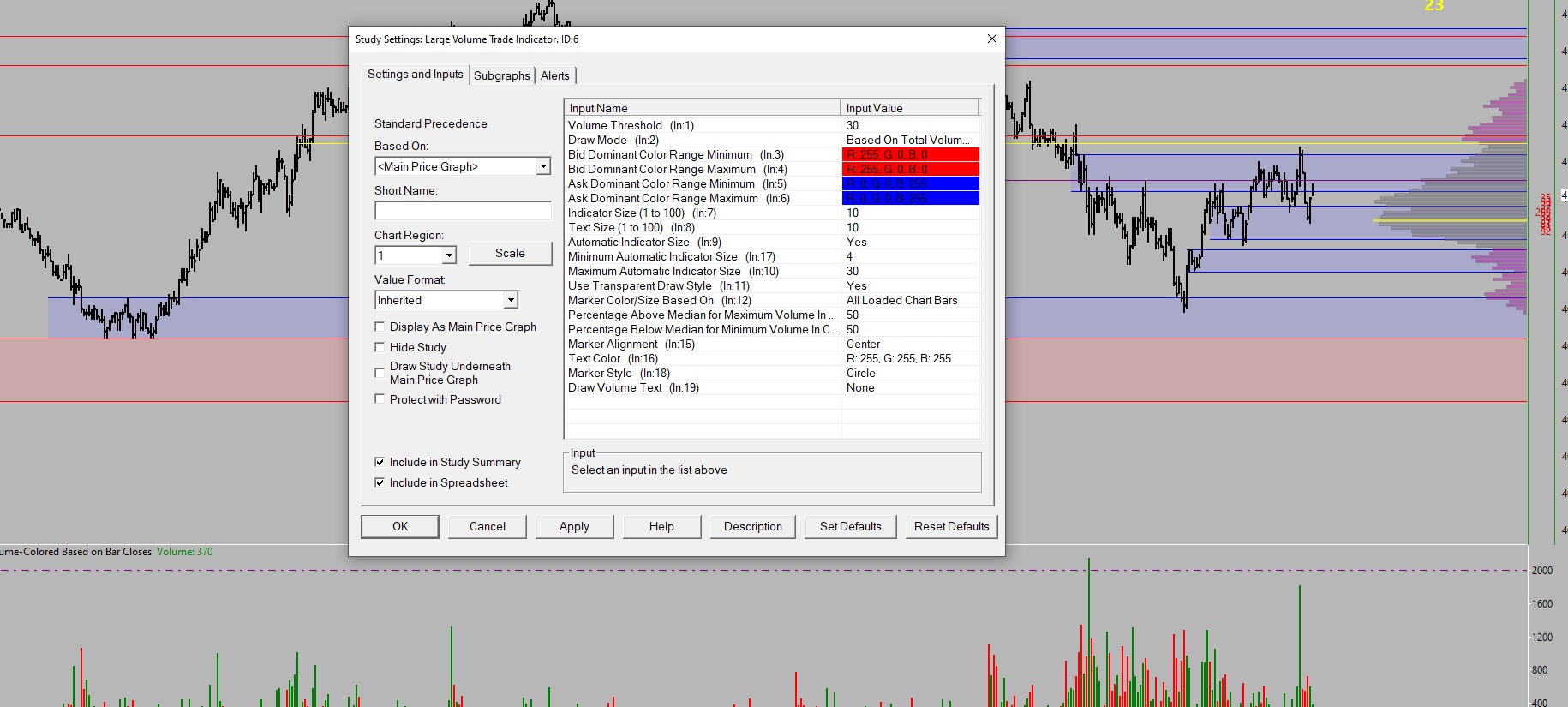

Hello, I am having a hard time getting this indicator to display on my chart. I have the same settings as other people and they have no issues getting little circles to show up on their charts at high volume trade. For some reason it is not displaying up on mine. I have attached my settings, please let me know what I am doing wrong.
imageLVT.jpg / V - Attached On 2020-07-24 15:15:01 UTC - Size: 300.86 KB - 649 views

Set Sierra Chart to a Tick by Tick Data Configuration. Follow the instructions here to do this:
Other things that we can see that we think may be the issue.
First, is make sure that your Volume Threshold of 30 is not too high. If there are not trades above 30, then there is nothing to show. Lower this down to 1 or 2 and make sure you are getting data displaying.
Second, you have the option for Use Transparent Draw Style set to Yes. It is possible that the transparency is set to 100, which is why you would not see anything. Turn this off to ensure that you are able to see the data.
