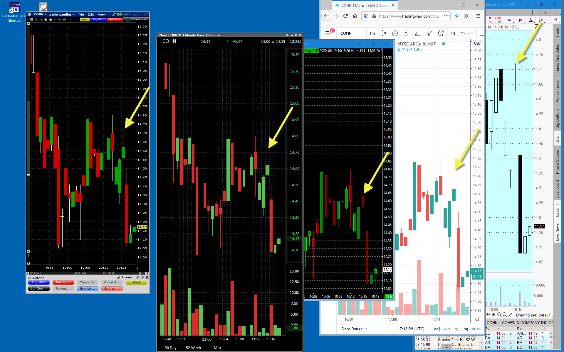

I'm evaluating Sierra Chart's real-time stock data feed and it seems to be missing data versus 4 other platforms that I am testing against. Sometimes this isn't too obvious, but when the market slowed down I was able to get a screen capture showing a one minute candle that was red instead of green and was missing an upper wick.
In my screenshot are 1 minute charts drawn from real-time data from 5 different platforms. From left to right: Interactive Brokers, Lightspeed, Sierra Chart, TradingView, ThinkOrSwim. I pointed out an obvious candle, but the candle before it is also missing the bottom wick.
Is this a known issue with the real-time data you get from barchart.com? Is there a more reliable real-time stock data provider I can use with Sierra Chart?

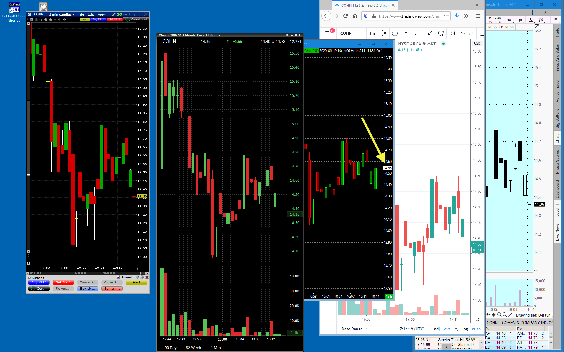

I also have this screen capture for the same stock when there was hardly any volume and Sierra Chart price wasn't updating for around 20 seconds. You can see in this capture that the last trade price marked on the chart was different from the other 4 platforms.

Okay we have looked into this, and we are contacting our data provider, Barchart, about this.
We think we know where the problem is arising and we are making a change over this weekend to remove the filtering that we think is causing the issue. We are relying upon a flag variable with trades from Barchart Open Feed that indicates that data should not be included in Intraday charts but it may be true more often than should be.

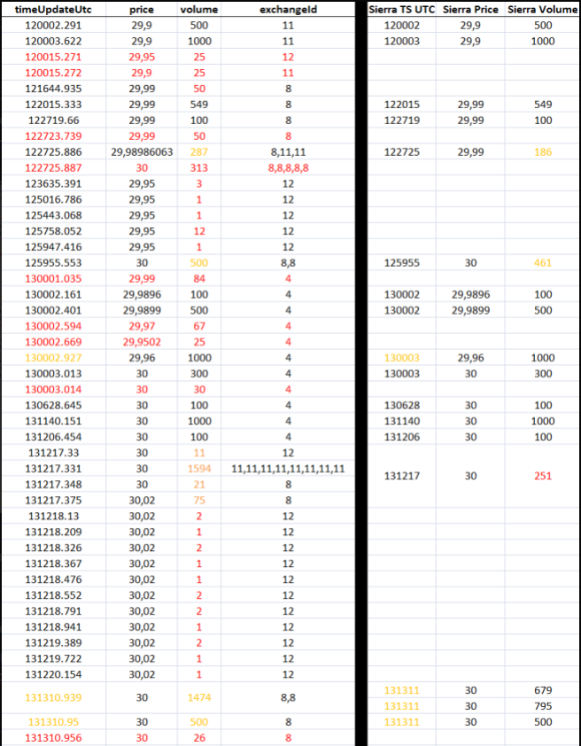

Attached file is data comparison for AAL stock on February 12.
Left columns : data are from Polygon (not Nanex). It is high res data (with exchange ID, ns timestamps) from Polygon that is locally concatenated into ms timestamp (all data from within same ms are concatenated ; price is average from the ticks with same millisecond).
Right column : Sierra data "as is".
As you can see, a lot of volume and ticks are missing from Sierra feed.

Okay we will see what our data provider says about this. However, understand, there are some trades filtered out which are not included Intraday charts in order to prevent out of range prices. That could be part of what you are seeing in regards to the difference. At least to some extent.
We just had a closer look at this. Any trade under 100 shares is filtered. Those are odd lots. Those are not regarded as trades, which should be included in Intraday charts. IQ Feed is no different. Odd lots are not included when using IQ Feed.
So we really do not see a whole lot of difference here considering this.

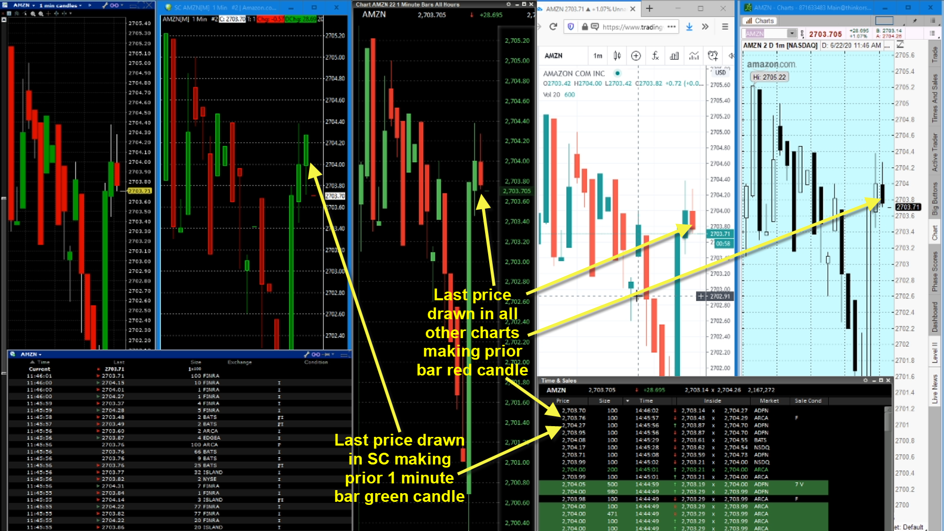

Here are a couple of screenshots showing 100 lot orders not drawn in Sierra Chart, but drawn in Interactive Brokers, Lightspeed, TradingView, and ThinkOrSwim.
I'm not going to dig into this any further. This supposedly is your preferred data feed that you provide and that you claim is the only data feed that you officially support. It's obviously inadequate and I shouldn't have to waste my time testing your data and defending my claims.

I haven't seen any missing data so far. The only anomaly I've seen today seems to be caused by slight difference in timestamps causing a few candles to open/close at slightly different places.
I want to say that this looks like a possible rounding error. Two cases in AMZN I examined today involved timestamps in IQFeed at 11:41:59.969590 and 11:38:59.973654 getting bumped up to the next candle at 11:42:00.000 and 11:39:00.000 in your feed. Your time and sales appear to have artificial millisecond values, so I can't really tell what the incoming timestamps are in your feed.
